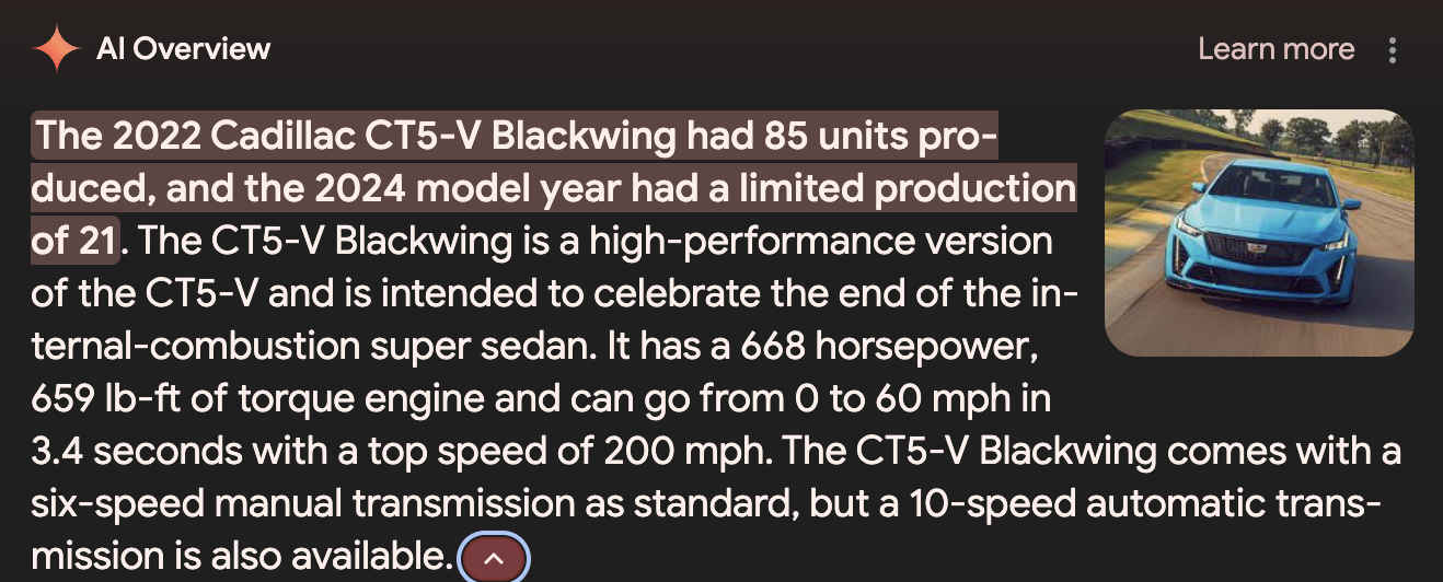

Side note, thanks Google AI! There's only around 100 or so Blackwings, pushing the failure rate signficantly higher (edit: the "thanks" was sarcasm btw. Clearly this is wrong)
Except that's completely wrong...typical for AI.
1,664 5 BWs built for 2022 model year per this very site.
