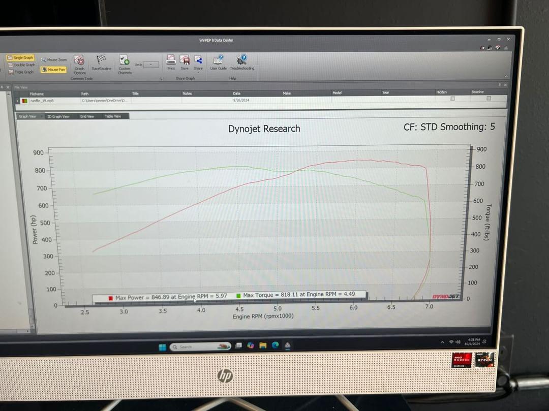

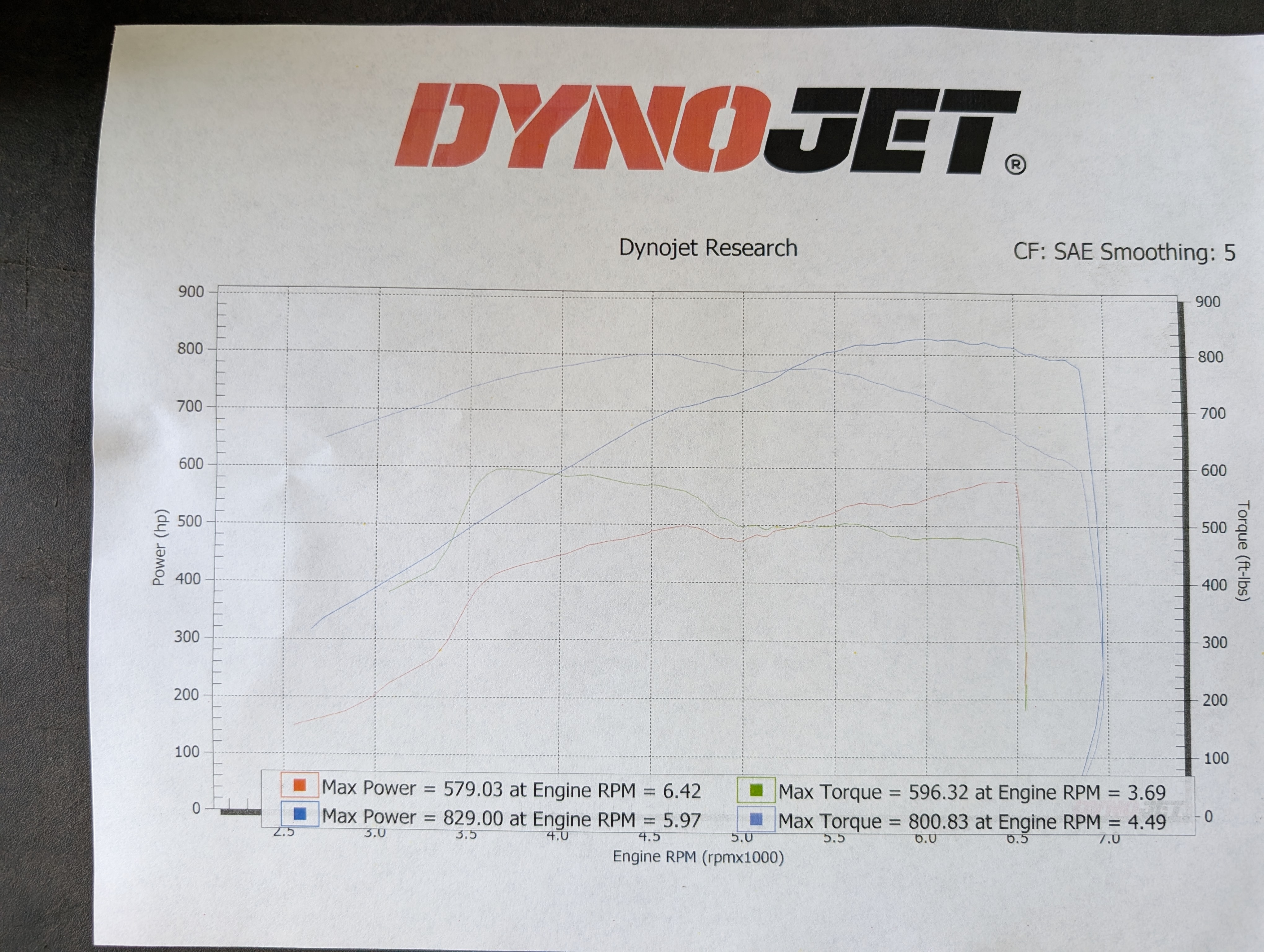

The mods you list are cam (I assume a 32 or 38% fuel lobe), port injection, and E85. Did you do any mods to the low-side fuel pump?
  • Cordes cold air intake
  • Custom Cam Motion cam kit (includes Cam, Springs, Pushrods)
  • DOD delete
  • Gm ls7 lifters, Lifter trays, Lt4 head gaskets, Arp head studs, Front main seal, Arp crank bolt, New water pump gaskets, Cam retainer plate with bolts Cam bolt, Amp lock out
  • LME head porting
  • Kong X-Port on stock supercharger
  • NGK Spark Plugs
  • Nick Williams 103 Throttle Body
  • Gates belt
  • OMS Aux pump Kit / Aem 400 Xrp lines and fittings
  • Kooks headers w green cats
  • DSX lower pulley
  • LME Billet VVT front cover
  • Reflex fuel controller
  • TooHighPSI port injector plates w Fic 1000cc injectors
  • Flex fuel sensor
  • LMP heat exchanger
  • LMP expansion tank
  • Supercharger silencing plate delete
Currently running E85 full time
