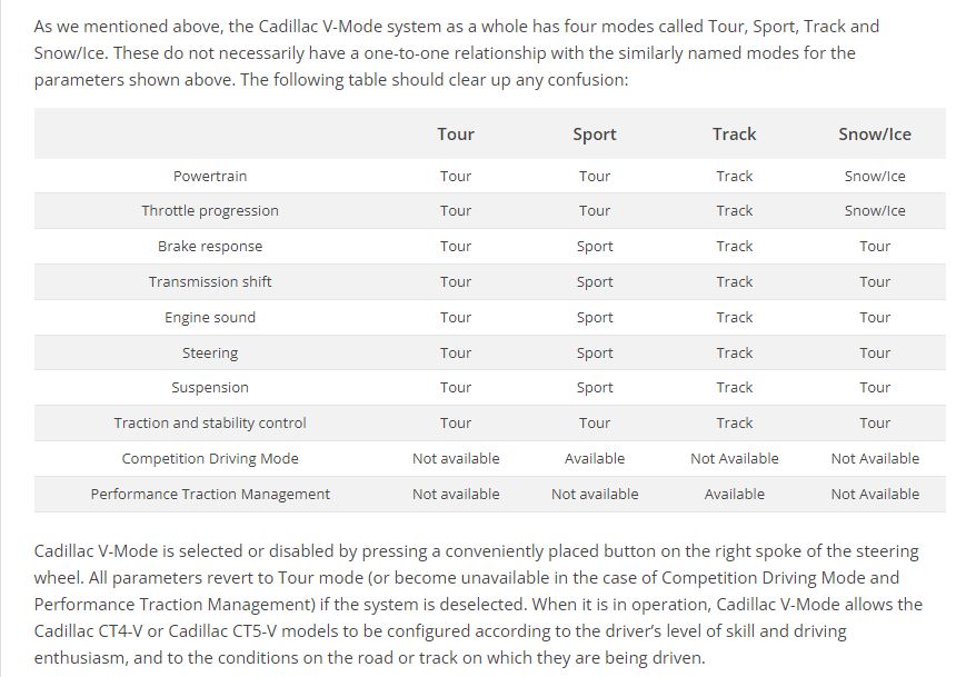

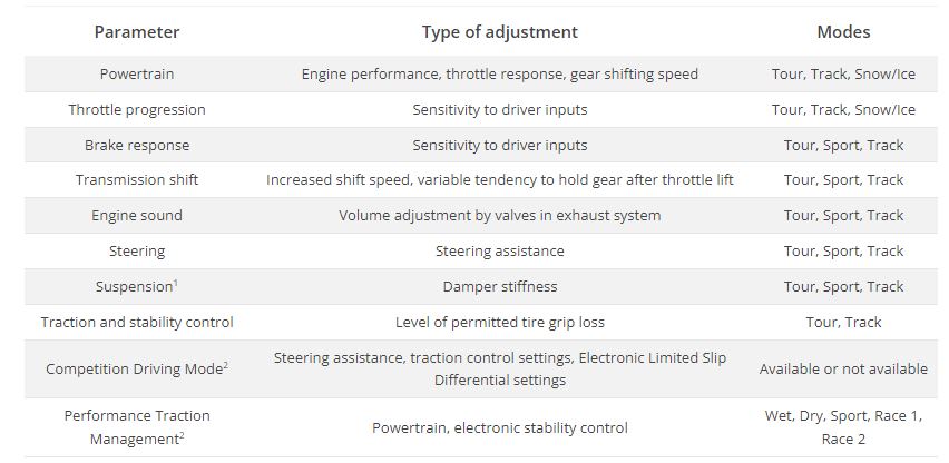

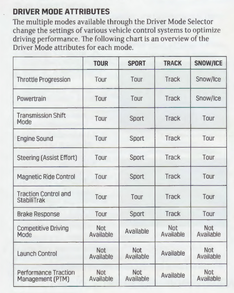

Competitive mode only works in Sport. PTM is only available in Track. It’s a little confusing because the 2nd level of Track mode is also called Sport. Don’t you have the “V-Series Convenience & Personalization Guide?”
