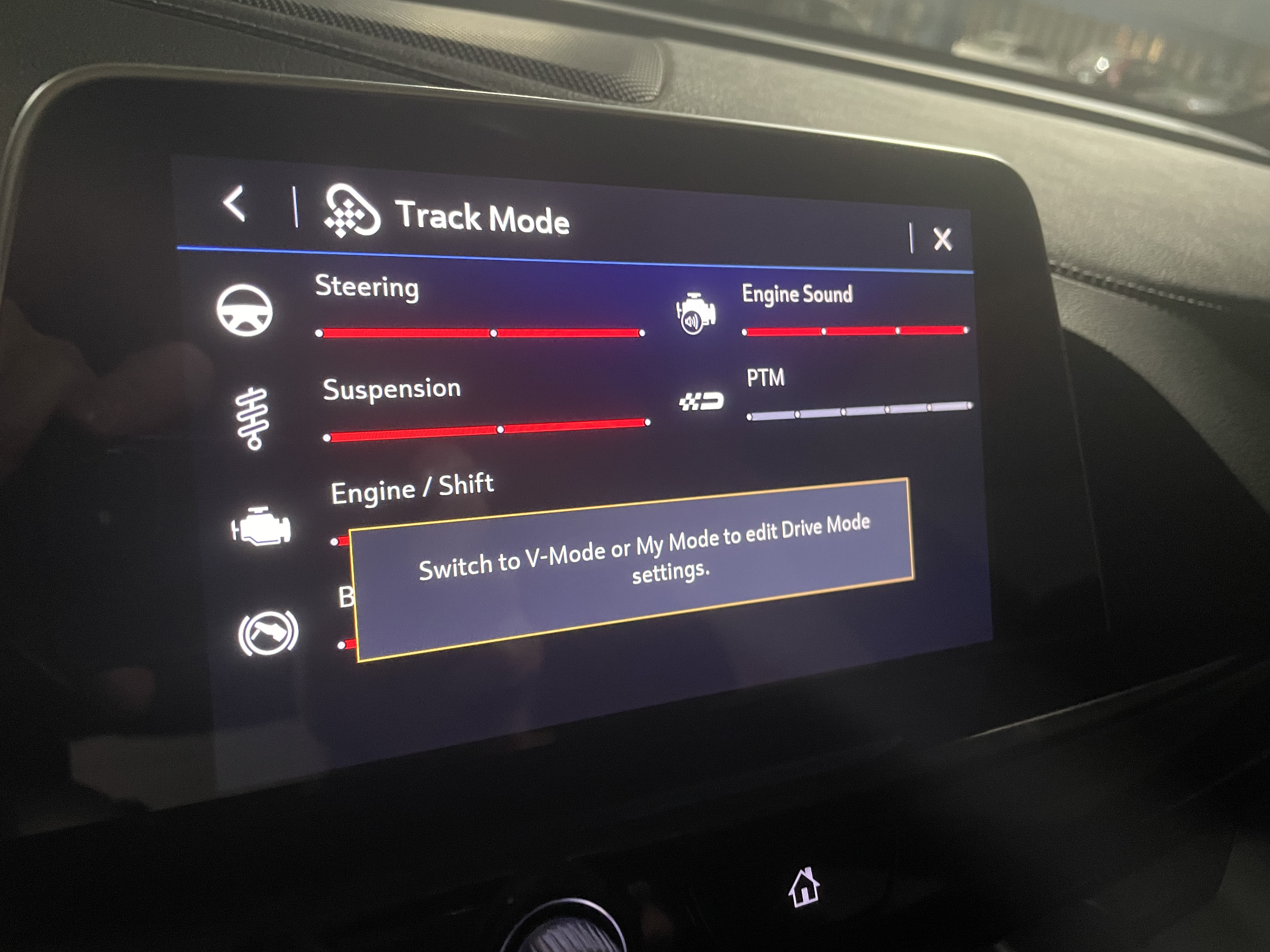

Asked about this in another thread but think it got buried: I see a lot of you referencing being able to toggle PTM in any drive mode, are you able to change the PTM slider while in track or sport modes? My car only allows PTM changes in v mode (I’ve included a picture of it not allowing me to make PTM changes in track mode).
I’m thinking this is either a result of (1) my having the base steering wheel that doesn’t have the PTM toggle (though I thought the steering wheels options should come down to aesthetic differences and shortcuts to features rather than change any actual functionality of those features) or (2) a software glitch, but curious to hear thoughts.

Track drive mode is not the same as PTM and you can only map a PTM mode to Vmode.
You cant edit Track, Tour or Snow/Ice, only Vmode and Mymode.
With the regular steering wheel with out the PTM toggle, I believe you hit the mode button twice to access PTM options and those are somehwhat independent of drive modes.

You can’t use PTM unless you are in Track mode. And you can change PTM modes while in Track.

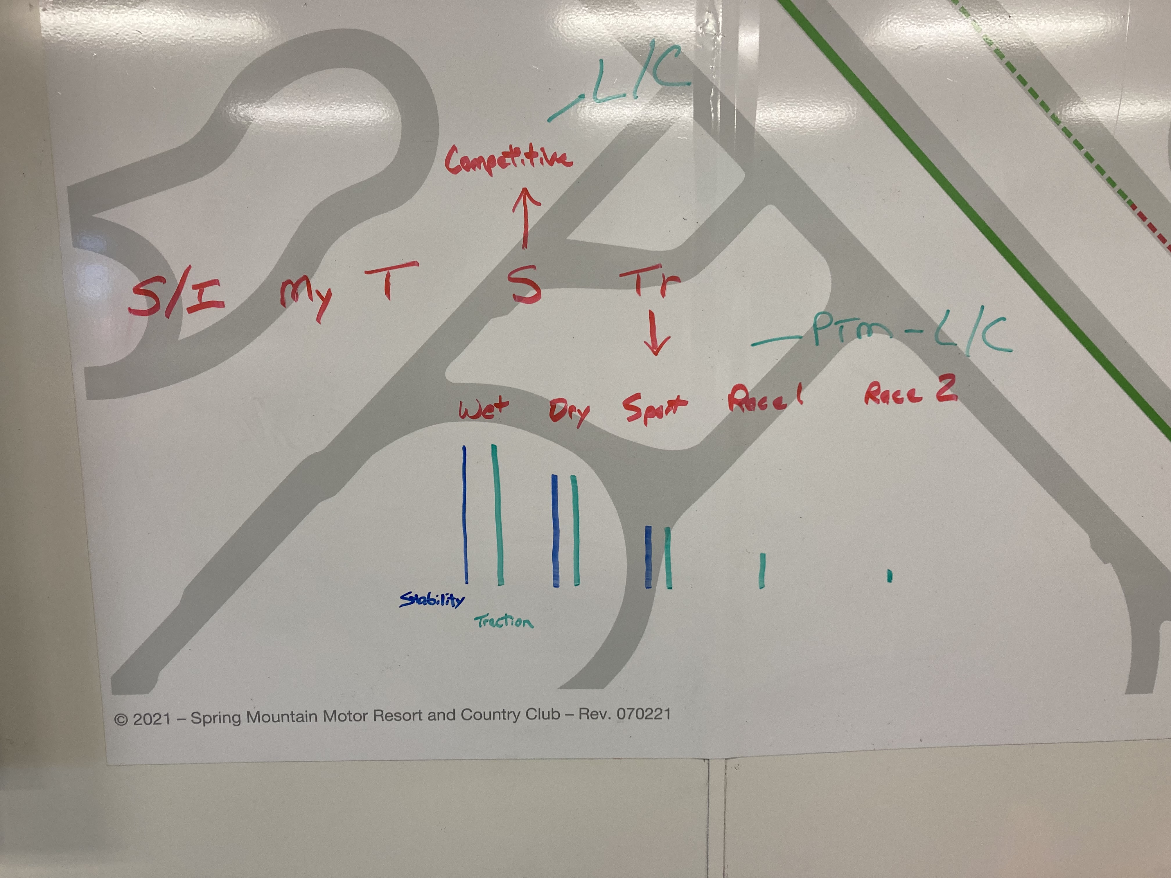

Here is a pic I took at spring mountain when they spoke about the traction management system. Note:
PTM modes only available in track mode.
Traction control and stability control reduce effect as you move PTM from wet to race 2 but never turn fully off.
By law, the traction control and stability control lights must come on anytime a drive setting reduces those systems from the fully ON setting.
Hope this helps some.
