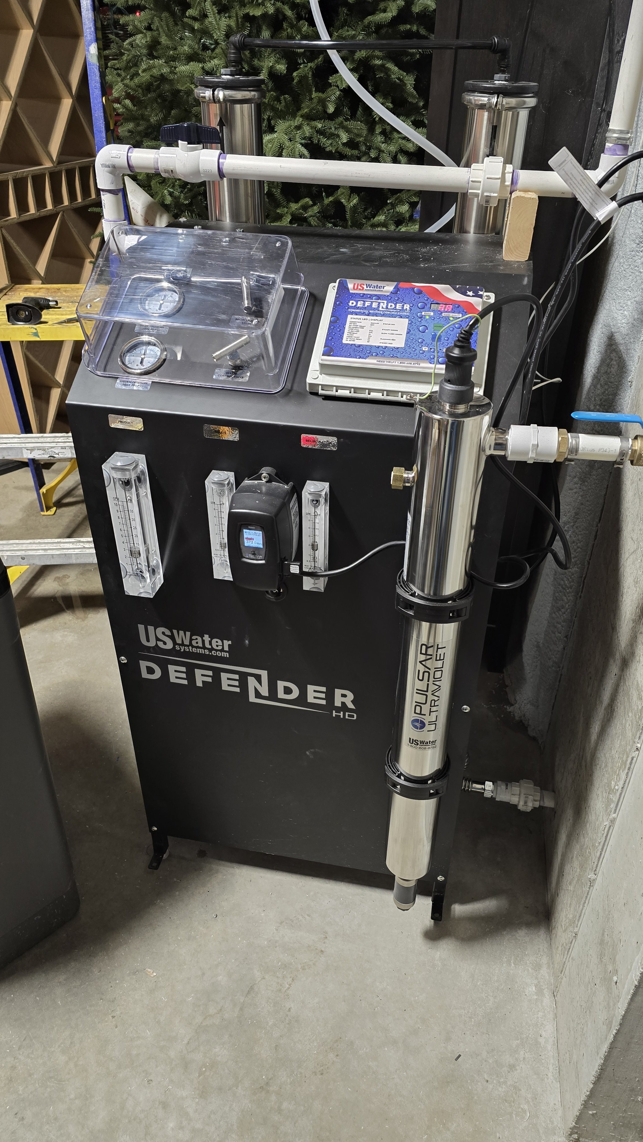

Our well water has high levels of chloride in it, or salt. It also has some iron, even after going through the large sand filter. This winter I installed a $14,000 reverse osmosis system that treats all of the water for our house, including the garden hose outlets. Before this system I couldn't wash a car because it would leave a salty film on it. Now I have the best water around.

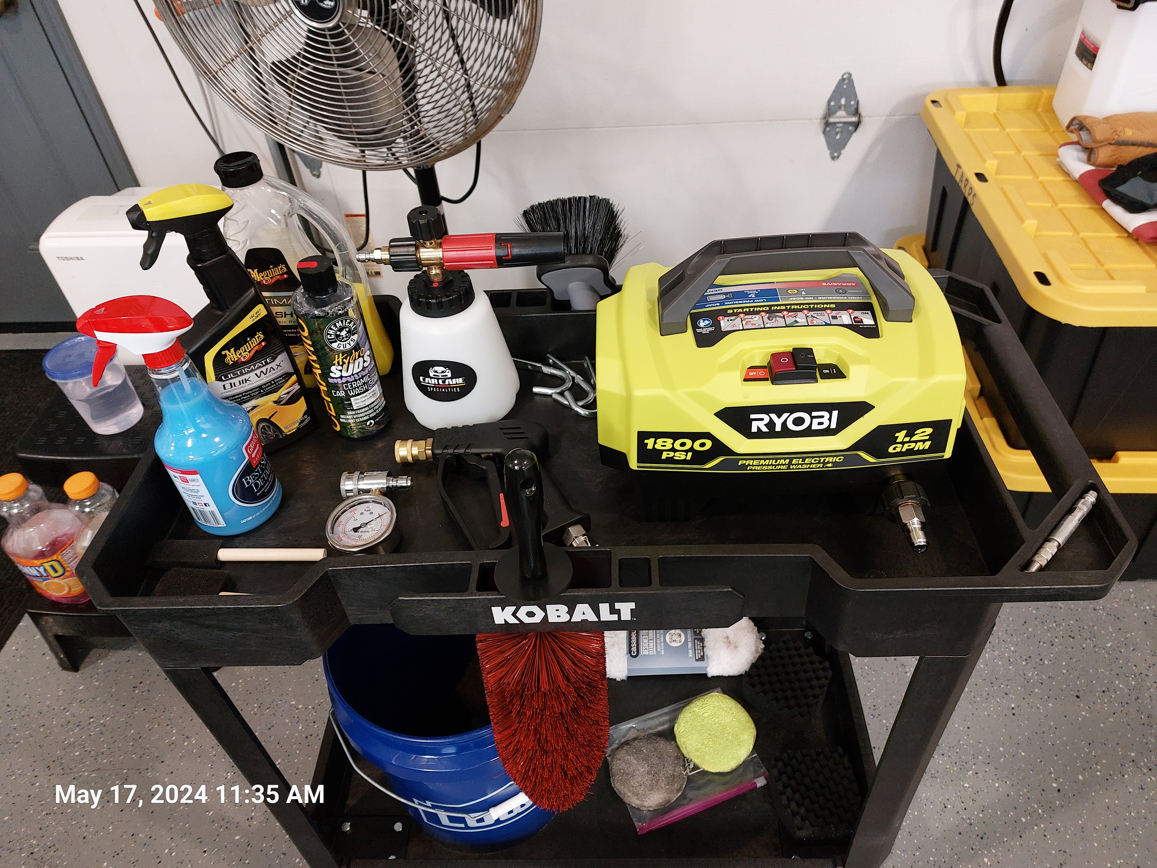

I've got a $100 electric Ryobi (1800 psi/1.2 gpm) that does just as good of a job as my Generac OneWash (2000 to 3100 psi/2.5 gpm) gas model. Matching the correct nozzles in the spray wand and orifice size in the foam cannon, to your specific pressure washer is key. This is not to debate gas vs electric. We all know, that electric pressure washers are much more convenient for washing vehicles.
When using my gas pressure washer, the wand required 037 spray nozzles, while the foam cannon required a 1.25 mm orifice. On the other hand, my little electric Ryobi, the wand requires 025 spray nozzles and a 1.1 mm orifice in the foam cannon. It produces just as much foam as the gas model, albeit less gpm, which is ideal for water conservation. IMHO, a good thick foam bath is much quicker and safer on the finish than a two bucket hand wash. I always have a bucket of clean water handy to occasionally rinse my wash sponge. Yes, I said sponge (ESOTERIC Elite Car Wash Sponge).
However, looking at your system, I realize I'm preaching to the choir. I'd love to have your setup. Sweet!

My TDS is around 750 before filtering. Chloride (which is different from Chlorine) was 500, max recommended is 250 for drinking water. After my sand filter and R.O system, I am around 20 TDS.

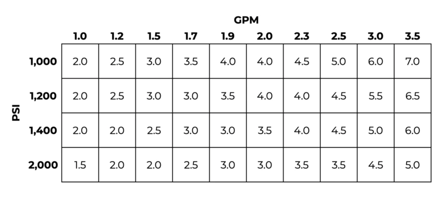

Nozzle orifice selection chart:

@rubberduck That's an awesome table.

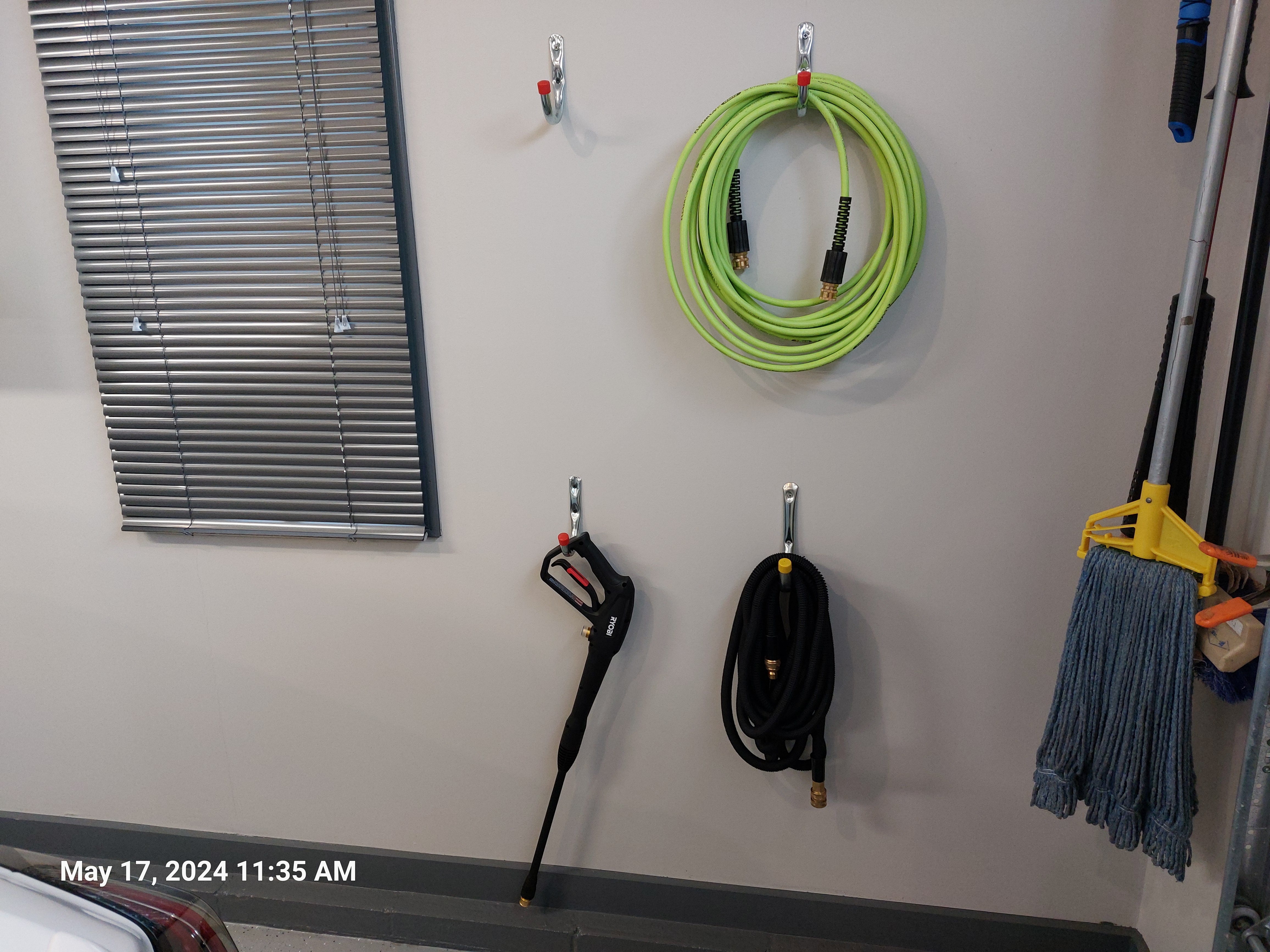

You're preaching to the choir, dude. I have a gauge, as can be seen in one of the pictures that I posted. I know what the psi/gpm is for both of my pressure washers, based on the orifice size for all of my nozzles. Yes, 2-2.5 gpm is ideal, but I'm not prepared to spend the kind of money it takes to buy an AR, Active 2.3 or Big Boi. My little Ryobi 1800 using 2.5 nozzles delivers 1050-1100 psi at the tip and almost 1.5 gpm, which makes it more than adequate for a DYI'er. I may order a set of 3.0 nozzles which will reduce the psi to about 900-950 and increase the water flow to about 1.73 gpm. Also, I almost exclusively use 40 degree nozzles, thus further reducing the chance of damage.
