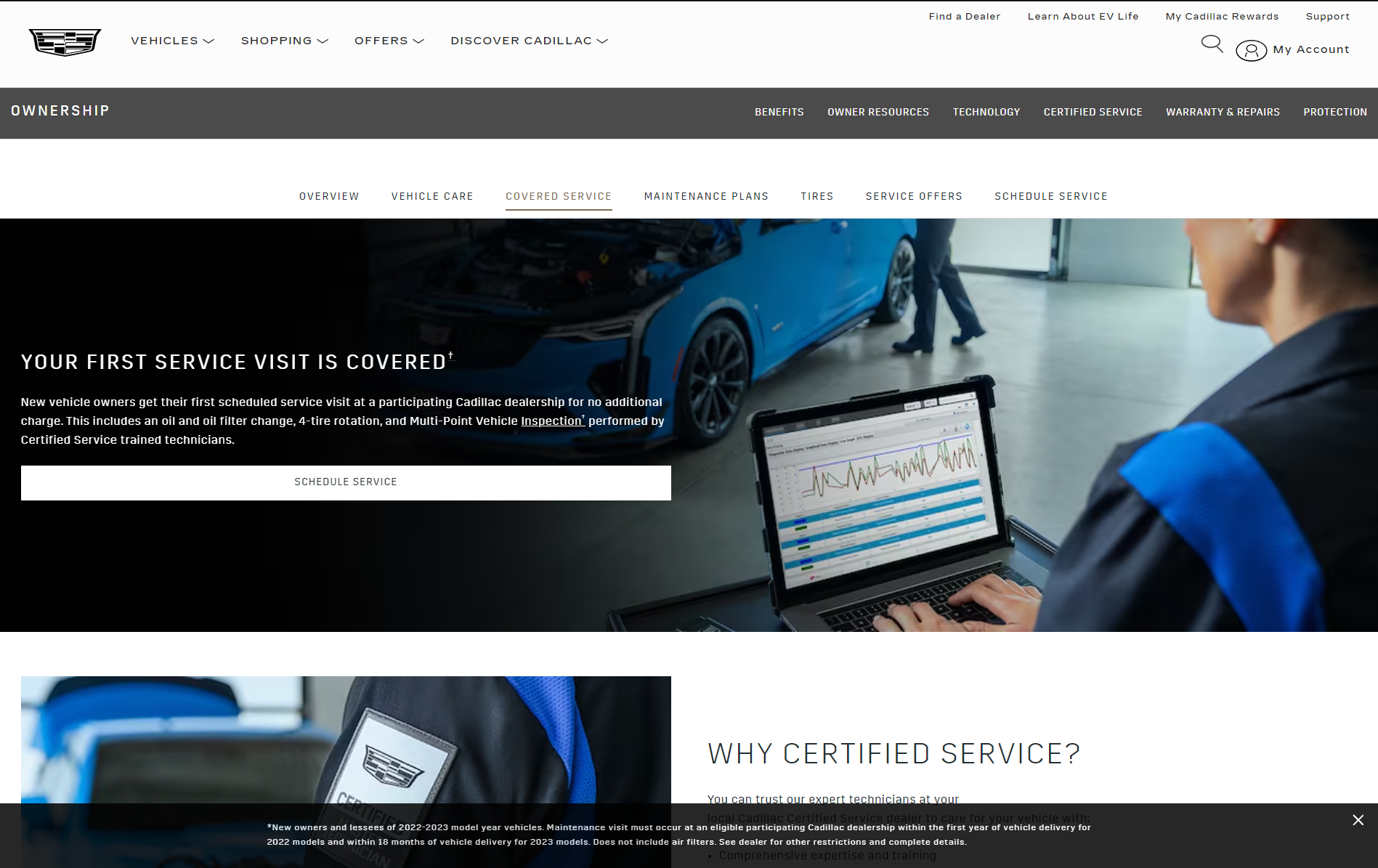

My contribution to the oil change side of the blown engine thread:
The Cadillac web page also lists the first oil change, tire rotation (N/A to BW cars certainly) and some checks.
Note the disclaimer on all the notices though:
*New owners and lessees of 2022-2023 model year vehicles. Maintenance visit must occur at an eligible participating Cadillac dealership within the first year of vehicle delivery for 2022 models and within 18 months of vehicle delivery for 2023 models. Does not include air filters. See dealer for other restrictions and complete details.
I think that last part is where some dealers are applying "other restrictions".
I'm going to set up an appointment for the recall work and the oil change when I can get a good weather day. I'm at 1550 miles with 46% oil life. I think it's justified to change the original oil, and I don't see why a dealer would want to set a bad tone for a potential lifetime service client by denying the free service. It's not feasible for me to use the dealer I purchased from since they are almost 100 miles away, but the local dealer surely would want a new customer.
