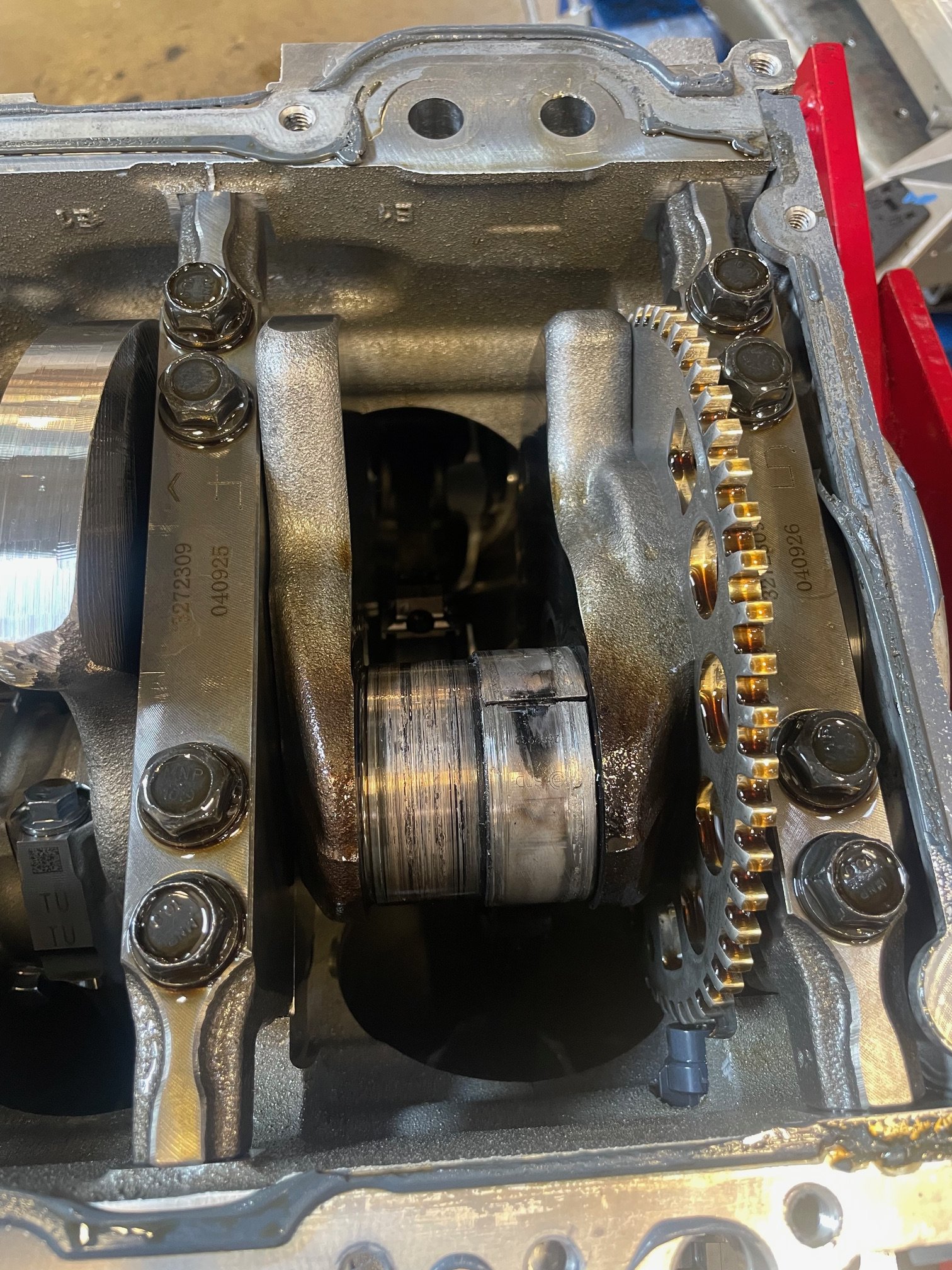

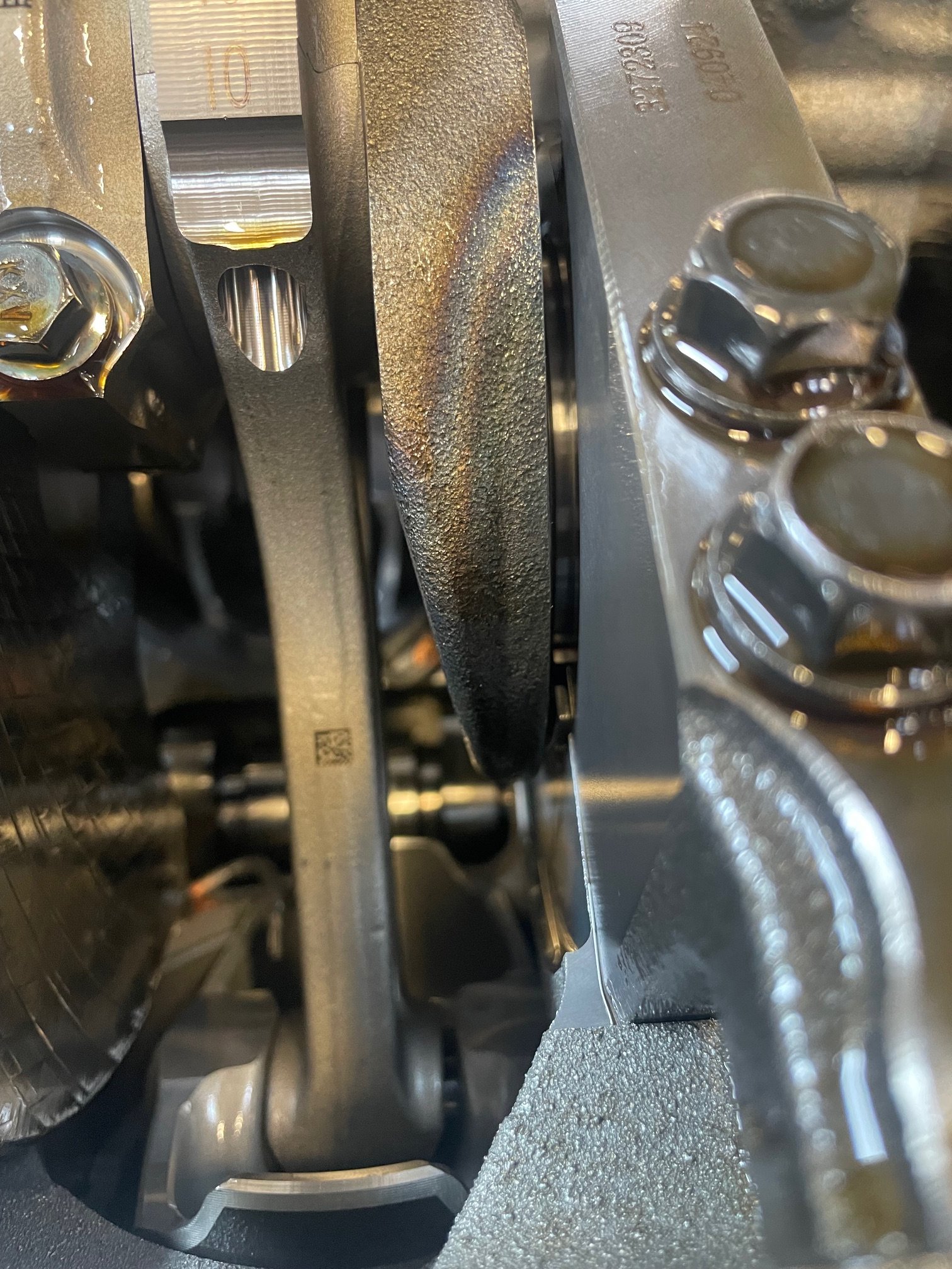

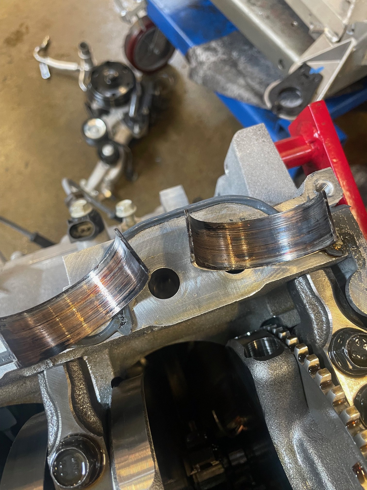

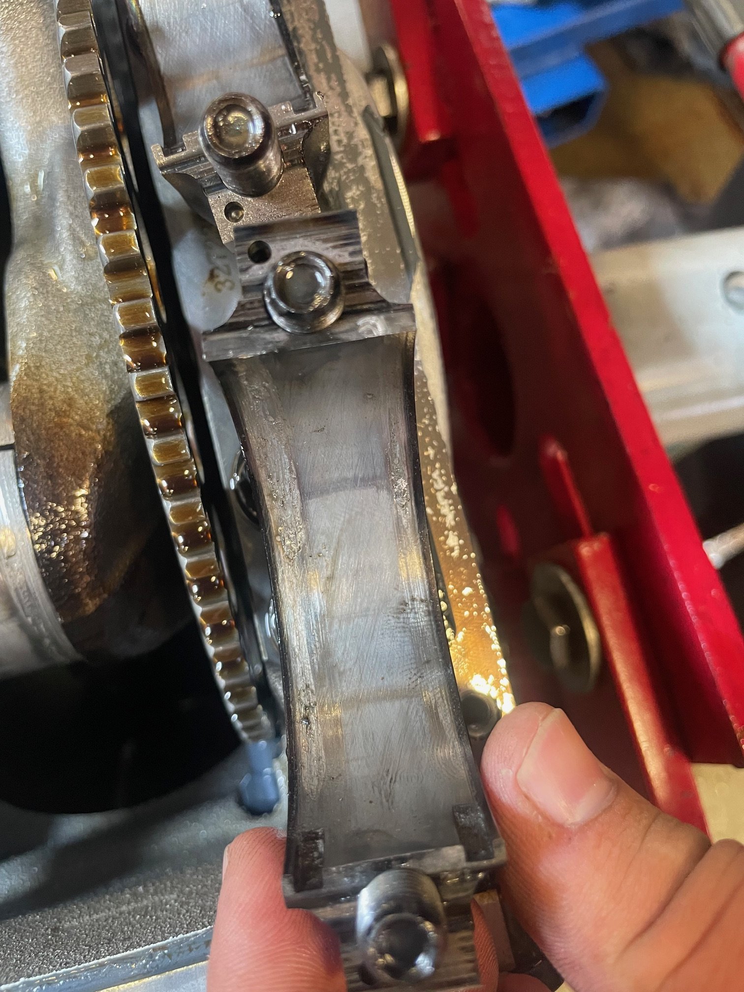

So, I have an update with photos. It turns out it was not a misfire and top end problem it was a bottom end problem, bad bearings. It spun two of the rod bearings, one so badly that it essentially welded itself to the crank and that’s what locked it up. This is the same mode of failure as the engine in the 2003 M3 that I had to replace the engine in. That one lasted about 7500 miles before it went. Cadillac is going to replace the engine and they have one available. The dealership will have it next week and get it installed as soon as they can. I’m not sure what they are trying to show in the first image except maybe the discoloration of the metal from the heat.
I see that now. Wow, that’s really not good. I guess it’s good it seized before that came loose and came out of the block.
Fortunate they have an engine available so quickly. Some others have had to wait much longer. Good luck going forward!
