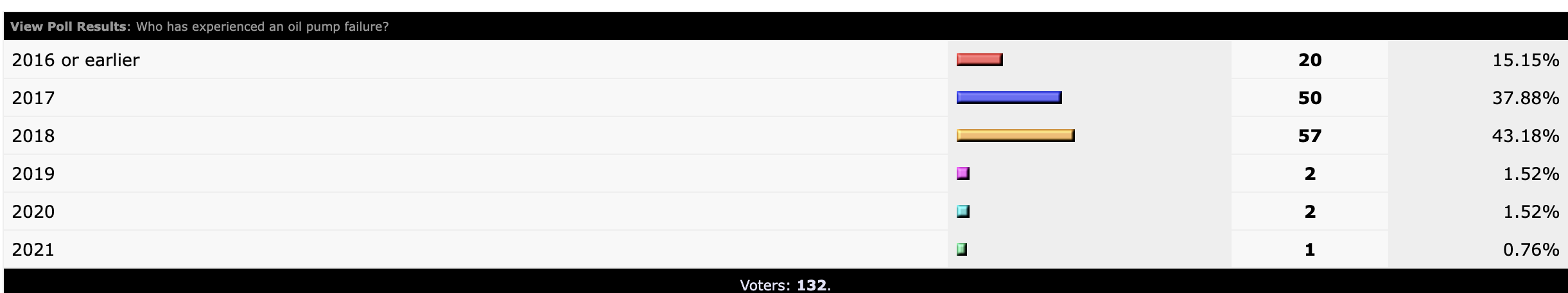

I had a ZL1 before I got the 4BW. I haven't heard of many engine failures, it was the oil pump that everyone was freaking out about. Seems to be an issue with the early 2017-2018s as they supposedly improved the pump but some with higher mileage swap to the Katech but it is very expensive from a labor perspective. This is the poll that the forum captures and 93 page thread.
Isn't the ZL1 dry sump though vs. wet sump for the BW?
