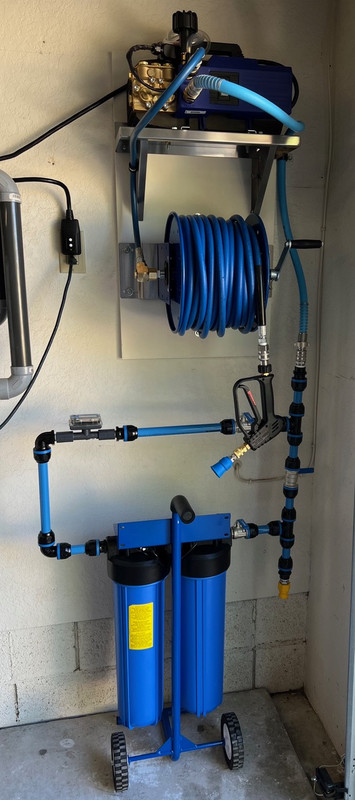

There is no better way to wash your car than to use a properly sorted pressure washer. You need one that hits the sweet spot for cars. These aren't the same systems you use to clean your deck or sidewalk.

Follow that link at your wallets peril.
Tell me about it. But it was the smartest thing I’ve done for my myself and vehicles. Truely touchless and a huge time saver as no towel drying required.
Nice setup! Where did you get the water filter from... I have hard water and I am looking for a similar solution.
Thanks. The filter is a CR Spotless DIC-20. It seems to work fine with my water with TDS of 180. The filter life depends on the water TDS. I purchased a cheap TDS meter from Amazon. If you have a lot of cars to wash or a really high TDS, I’d probably look into a local water service company filter delivery program. Will be less expensive in the long run.
