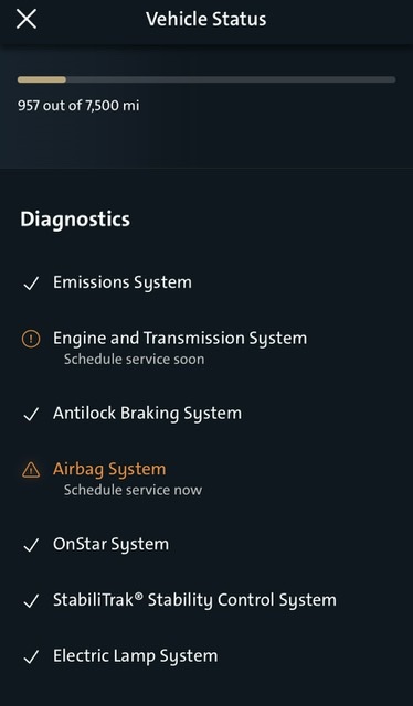

Went pick up my 4BW Friday morning and they had to take it back to the service guys due to a service air bag message. They fixed it and let me take the car. But based on OnStar it’s back as well an additional service needed for engine / transmission. The crazy part is there’s no lights on the dash that say anything is wrong. Any idea?
Went pick up my 4BW Friday morning and they had to take it back to the service guys due to a service air bag message. They fixed it and let me take the car. But based on OnStar it’s back as well an additional service needed for engine / transmission. The crazy part is there’s no lights on the dash that say anything is wrong. Any idea? View attachment 10320
I think I'm sensing a trend, although I hope not. Dealer vs OnStar. Who will win the battle of the service warnings
Yeah. I had the same issue but it cleared after a couple days

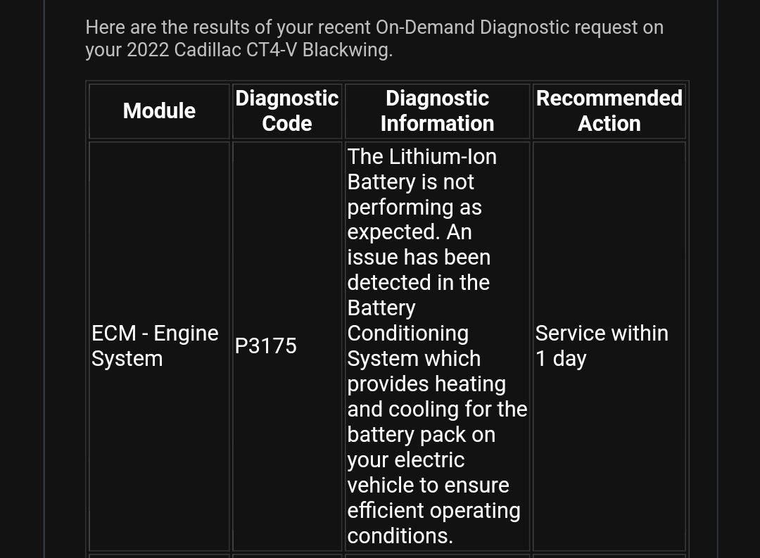

Did you ever resolve DTC P3175? And if so, what was the cause?
P3175 is for active exhaust valves. I just had this and dealer ordered new exhaust. It states it for an EV, but dealer assured me it was the active exhaust valves.
