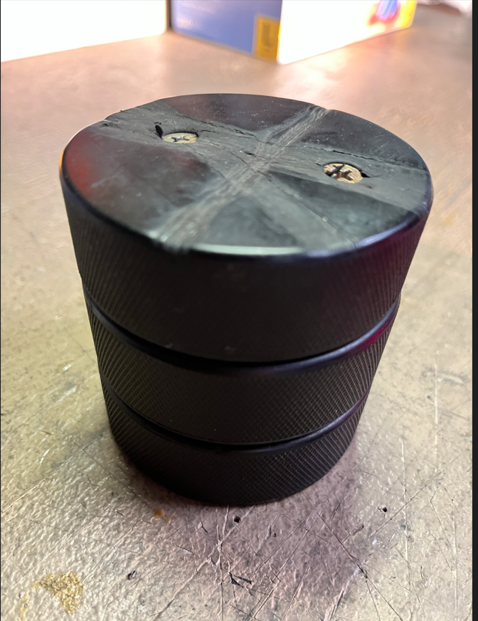

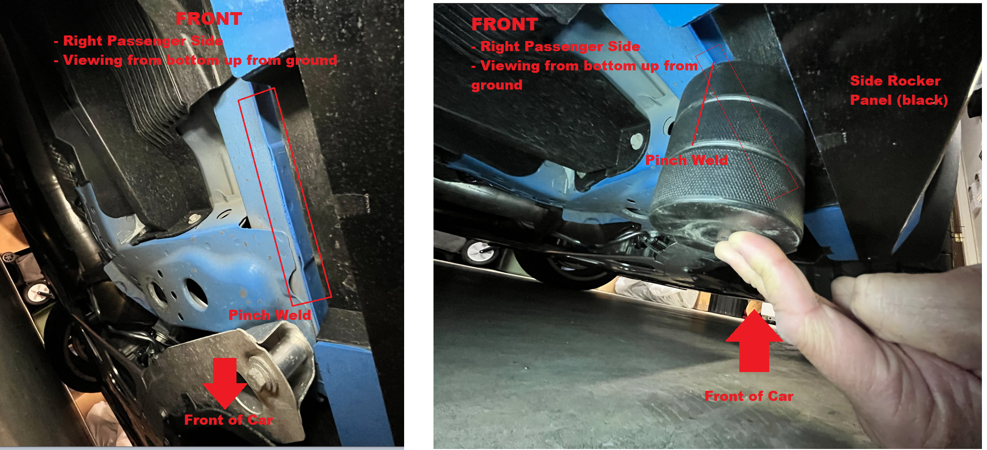

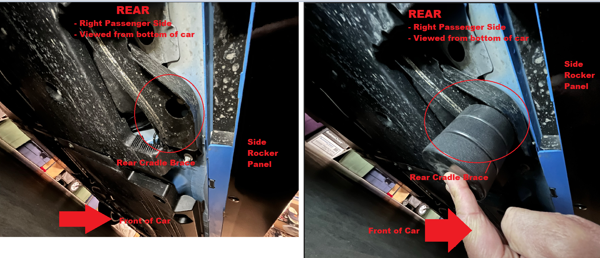

From the CT4 Service Manual that was shown by @Dirkbg above, I tested those locations using a low profile jack + three hockey pucks stacked (each 3"x1" WxH) to lift the car for some wheel detailing work. I used the pucks as that were the only pads immediately available for me but a better option would be the Quickjack Pinch-Weld Blocks that @Jameson's Viggen noted he purchased for lifting his 4BW. I measured the front molding opening at the pinch weld and these Blocks would fit nicely.
For the FRONT, I used the pinch weld as noted in the instructions: "In the front location, place the lift pads on the rocker outer panel weld flange."
For the REAR, I used the rear cradle brace per instructions, diagram, and pics.

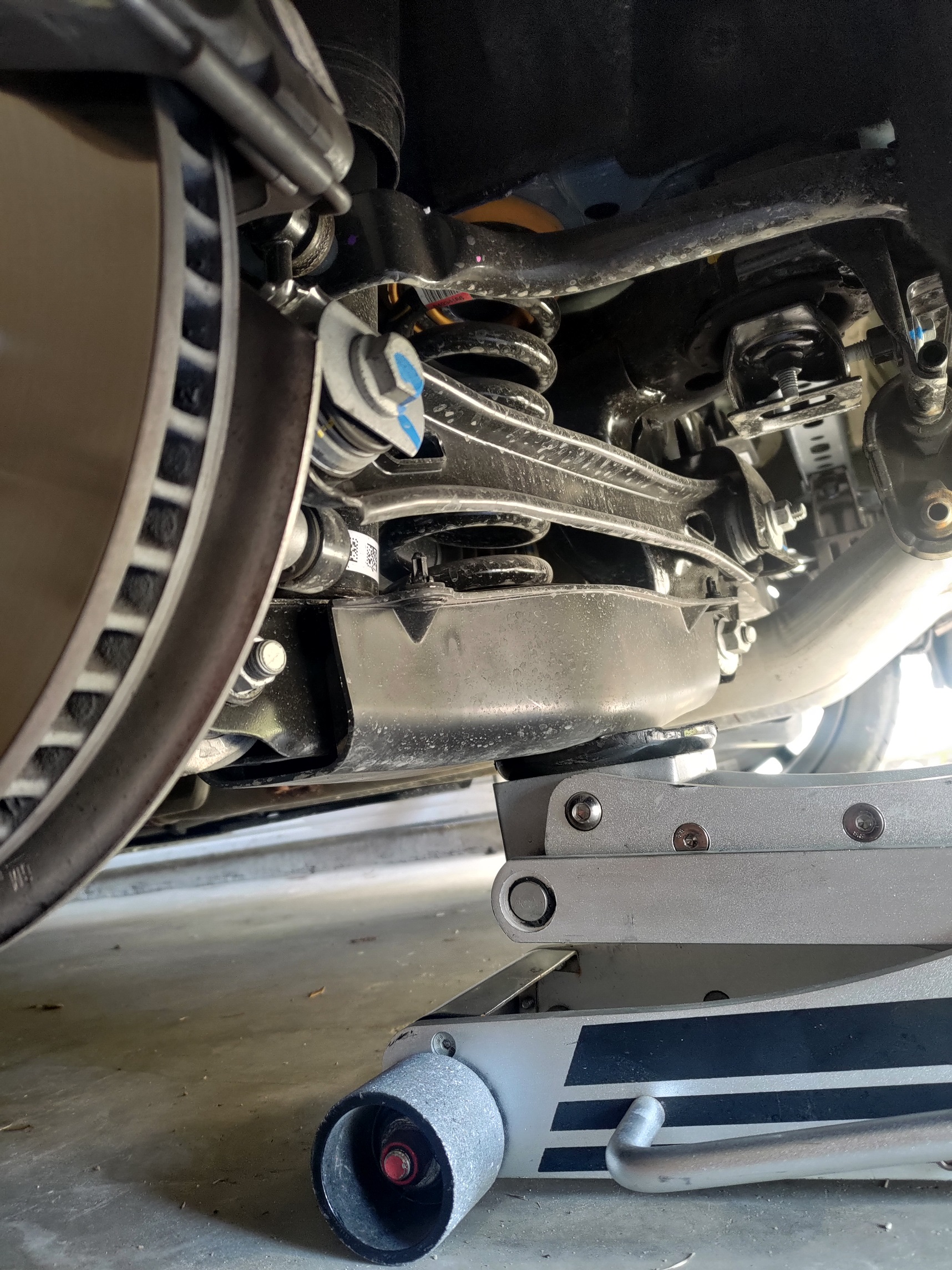

I had Cadillac Sewell roadside assistance come take care of my tire today since I had the Tire&Wheel warranty anyway. They're great, if anyone was wondering. He even showed up in an Escalade with all his tools/equipment in the back.
But, on topic... he jacked my rear left from here:

He jacked up the car using the plastic lower control arm cover?
Wondering the same thing? That seems like the worst place to jack the car unless you want to crack the plastic.
Yep. No damage to the plastic that I can see. I assume the actual arm is right under it with very little gap. I'm not saying it's the best but it worked.

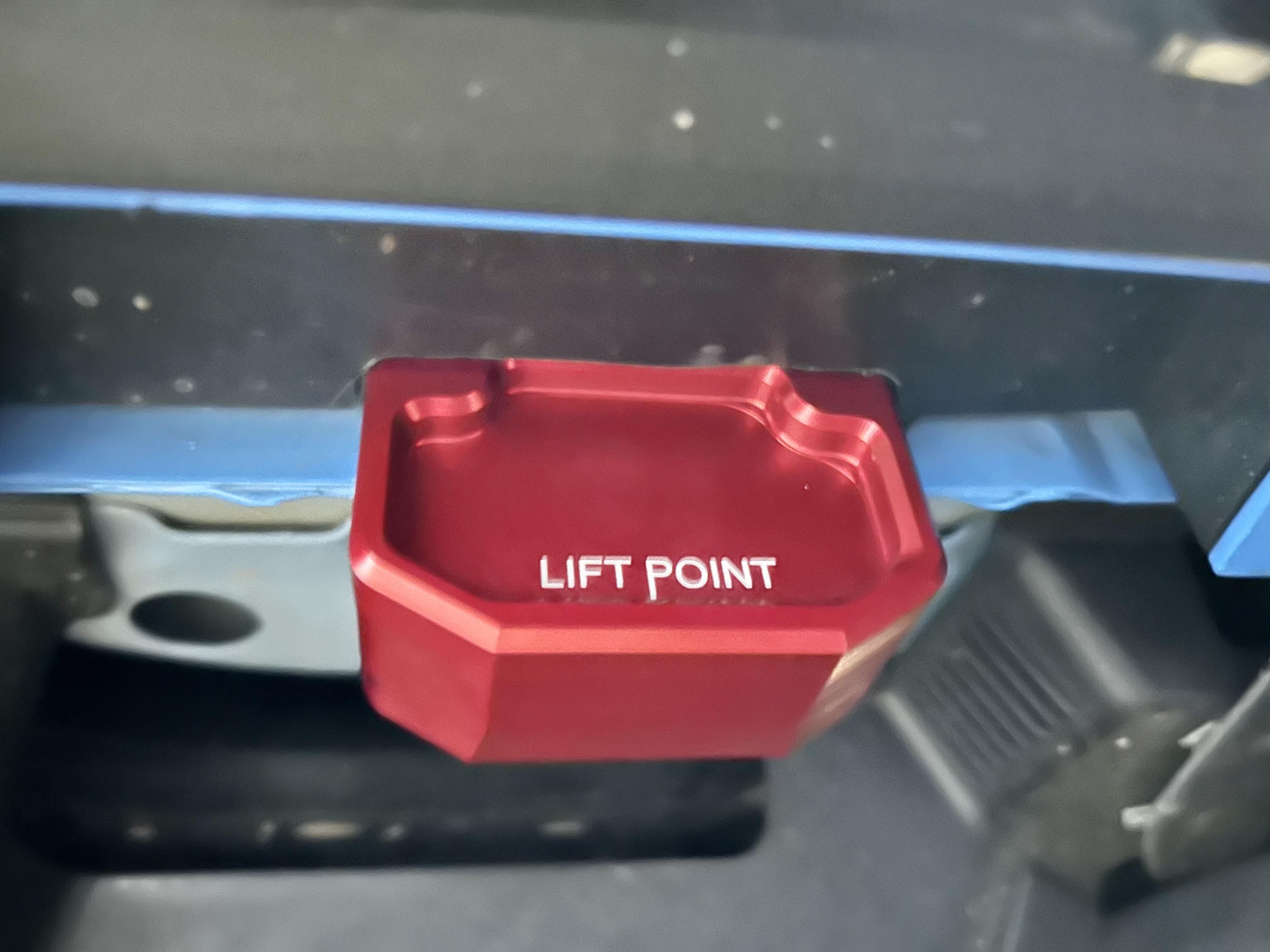

Just installed the ZL1Addons lift points on my 5BW yesterday and decided to trim the plastic a bit from the inside of the rocker panel trim and inset them. I initially installed them over the plastic but didn’t like how it slightly flexed the rocker. Trimming was very easy using a cutting bit on my dremmel.

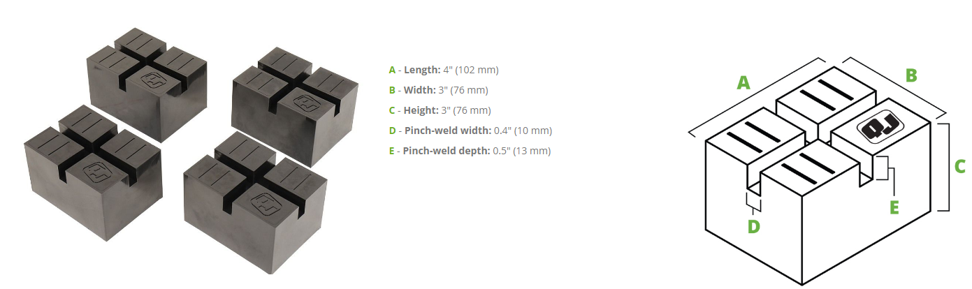

I could not get that quickjack pinch weld block to fit on the rear jacking point of the CT-4 BW. They also make a pinch weld puck, which I will try next.
