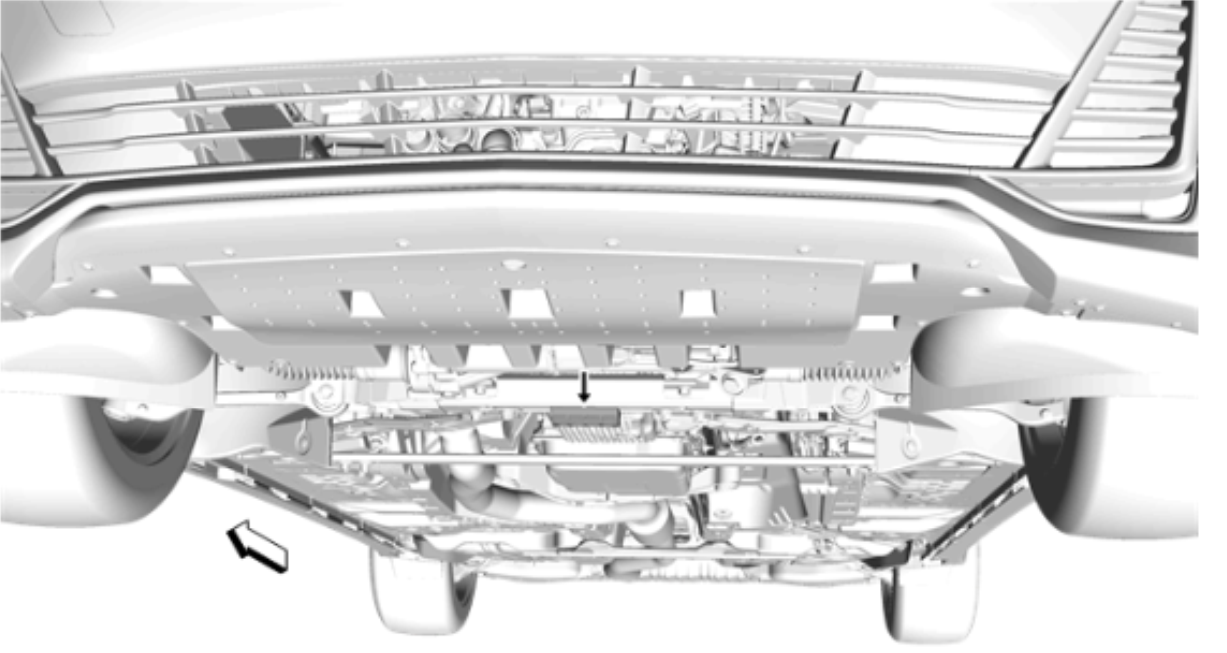

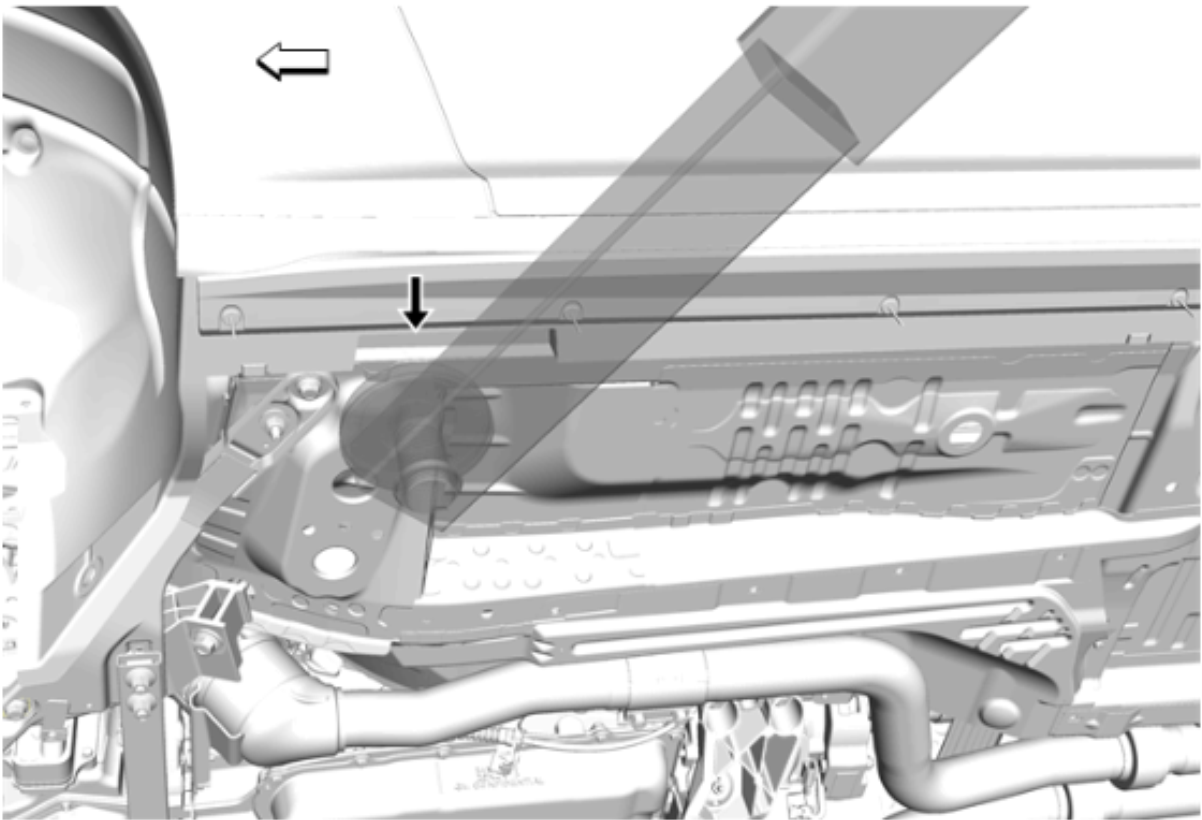

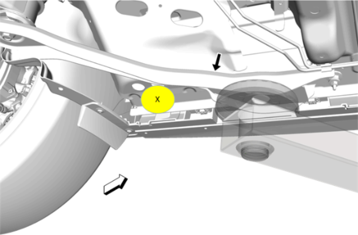

The jacking information from the CT4 service manual says:
Frame Contact Lift:
The vehicle should be lifted so that the hoist pads and or lift arms do not contact the rocker panel molding. The hoist pad must be located in the designated area. In the front location, place the lift pads on the rocker outer panel weld flange. In the rear location, place the lift pads on the rocker outer panel rear cradle brace. Care should be taken to ensure the hoist pad is inside the rocker panel molding cut out area (notch) to prevent damage to the vehicle.
Front Lift Pads
When lifting the vehicle with a frame-contact lift, position the pad as close as possible to the rocker molding cutout.
Rear Lift Pads
When lifting the vehicle with a frame-contact lift, cover the inner and outer edges of the rear suspension bracket (arrow). Use the cutout in the rocker molding to correctly position the pad for/aft. If you need to remove the rear suspension bracket, place a jack stand under area X. Raise the jack stand high enough to free the hoist pad from the rear suspension bracket for service.
Vehicle Jacking:
Caution: When you are jacking the vehicle at the front locations, be certain that the jack or the jack lift pad does not contact the front fascia, front fascia air dam, or the front fenders. If such contact occurs, vehicle damage may result. When jacking at selected front locations additional clearance may be required for the jacking points.
Note: When you are lifting a vehicle with a service jack, block the wheels at the opposite end from which you are lifting. Use jack stands to provide additional support.
Front of vehicle
When using a service jack under the front of the vehicle use one of the following locations:
Place the service jack pad in the same location as shown for the front lift pads or on the front center jack pad shown.
Rear of Vehicle
Note: Place jackstands ONLY under strong and stable vehicle structures.
Place the service jack pad in the same location as shown for the rear lift pads.

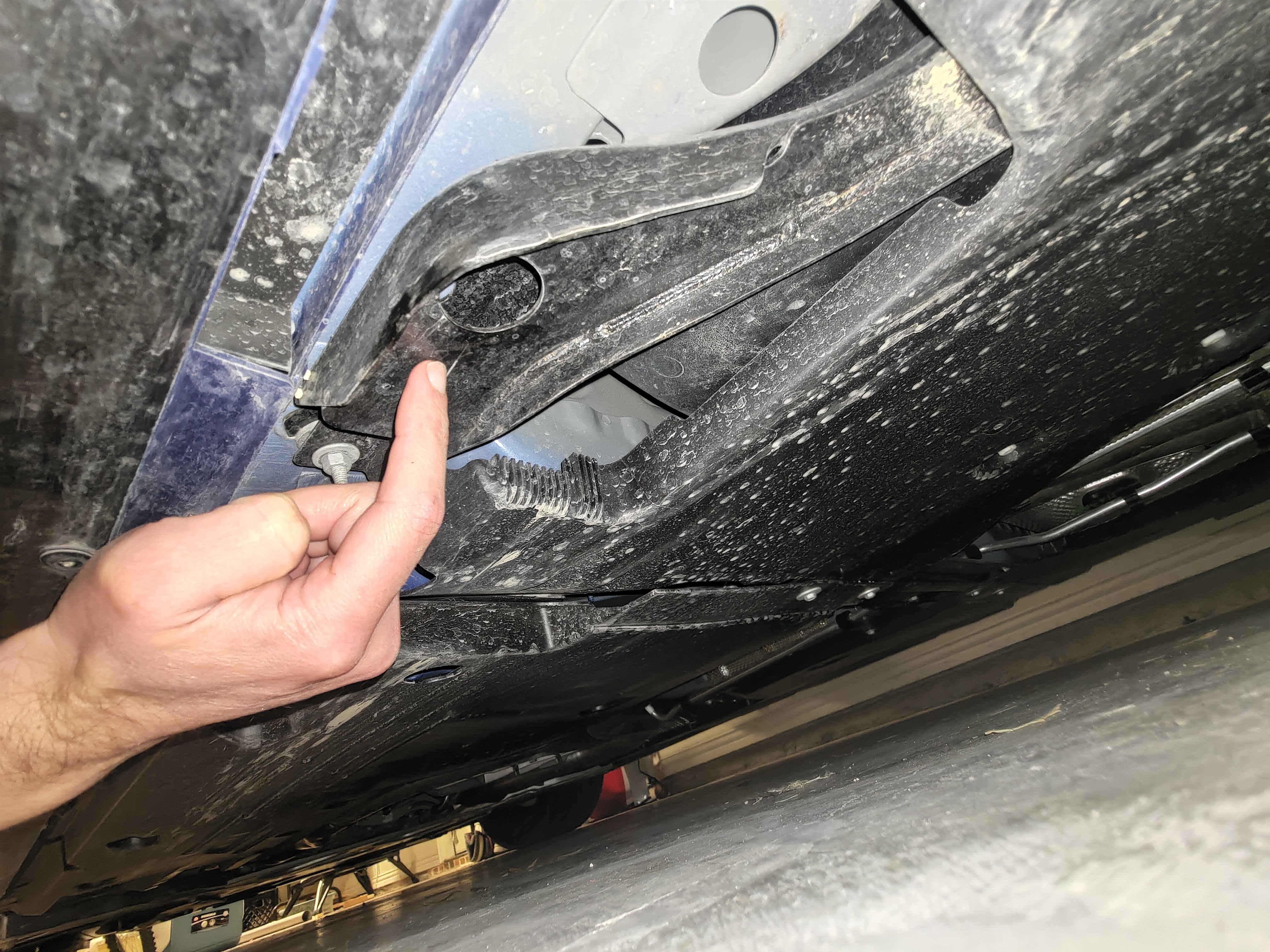

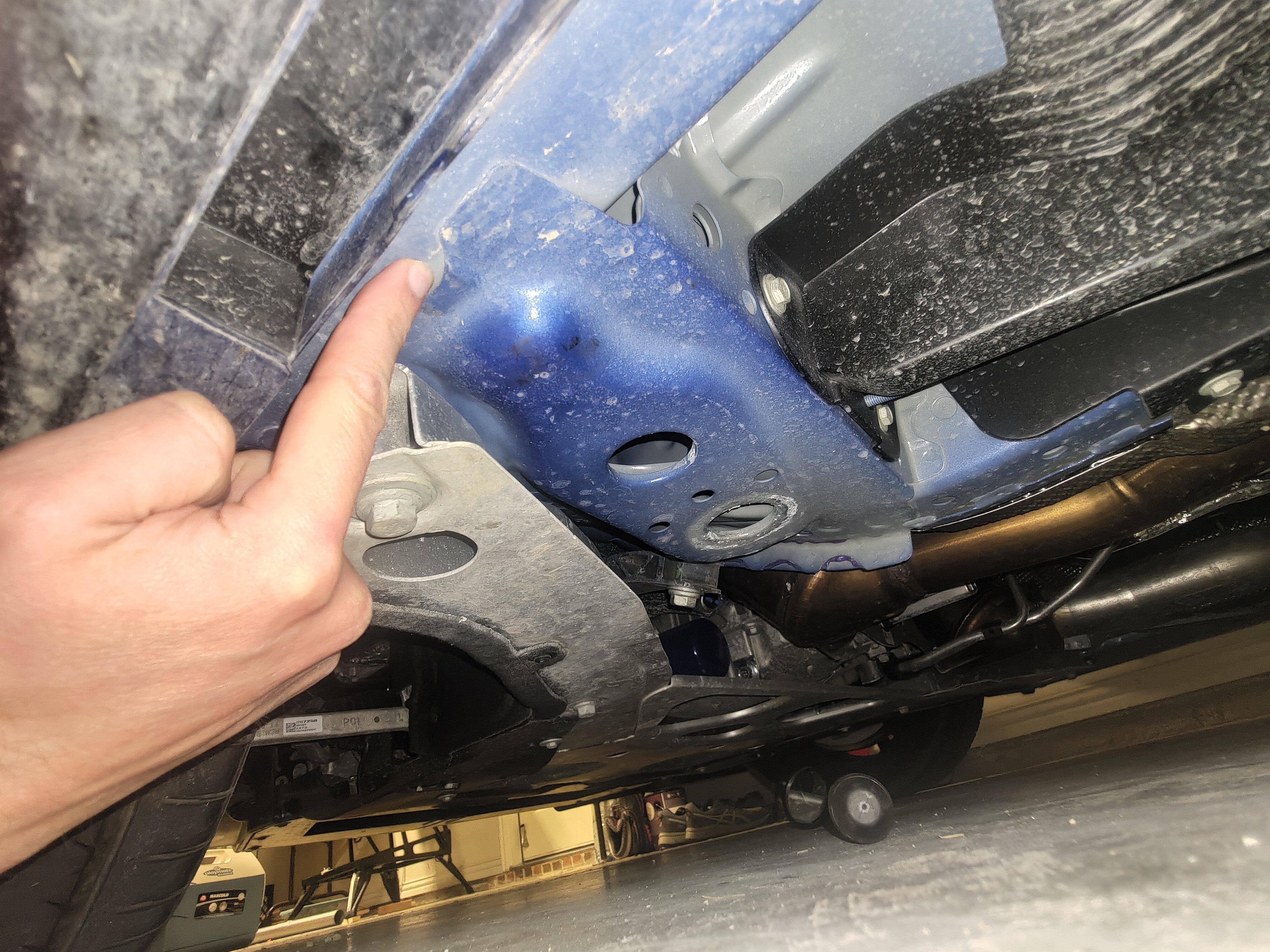

So I'm quickly closing on my 1500 mile oil change and trying to understand this thread. Thanks for sharing the above pictures but like others have said they're pretty weak.. Silly GM..
To confirm, for 4BW, the front jack location:
And rear:
If so... What a pain!
The front center location picture.... It looks nothing like mine does so I think I'm going to have to jack the sides to crawl under and really take a better look....
And rear:
My understanding that those locations are for when using a 4-post lift. I am not sure if you can put a regular jack there on those spots when you are not distributing the weight evenly but maybe others will chime in. I use the pinch weld with the ZL1 jack pad adapter to get some height to clear the rocker panels.

That is not a pic of the underside of a 4BW. There is no cross member like that.
