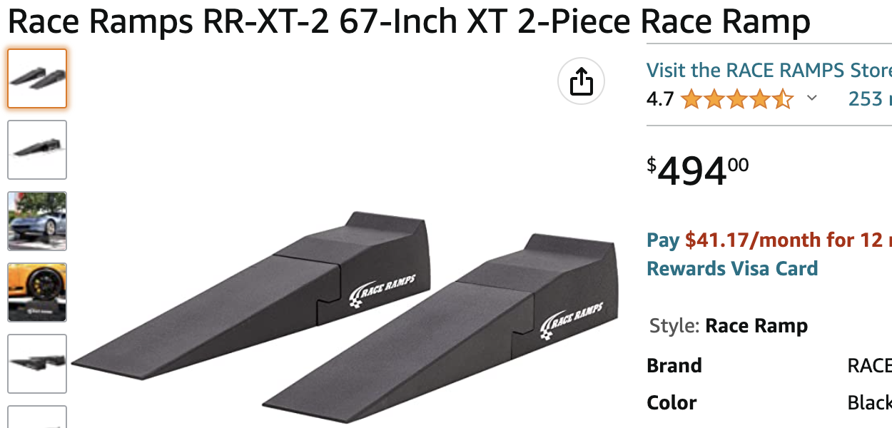

For oil changes and other maintenance where you don't need to remove the wheels just drop the coin on a set of these and call it a day. You will be up in the air in 30 seconds.

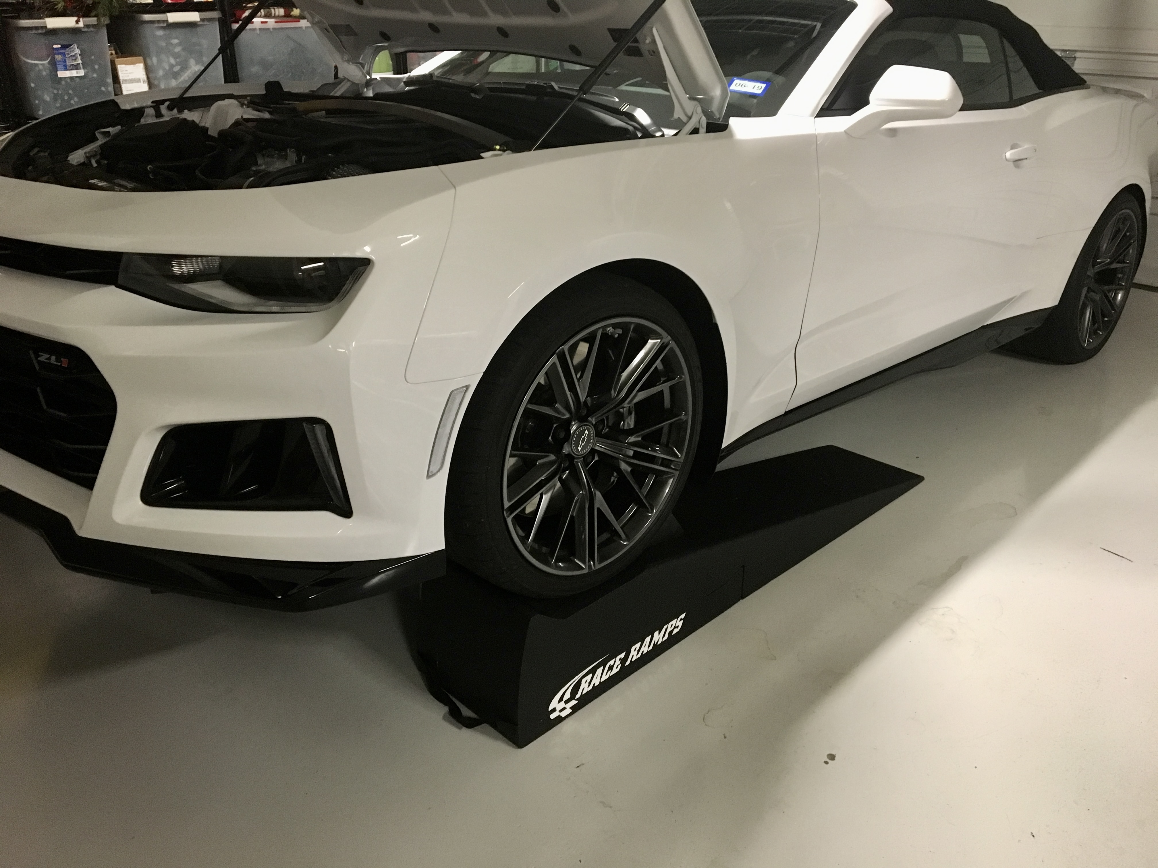

Totally agree! I’ve had mine since 2016 and use them for every car I have & had and will use for new cars in the future! A great investment if you do routine maintenance yourself. I store them on top of my garage shelves with ease. Safe and reliable including fast to deploy.
Does anyone with Carbon 1 on the CT4 use these and can confirm that they clear?

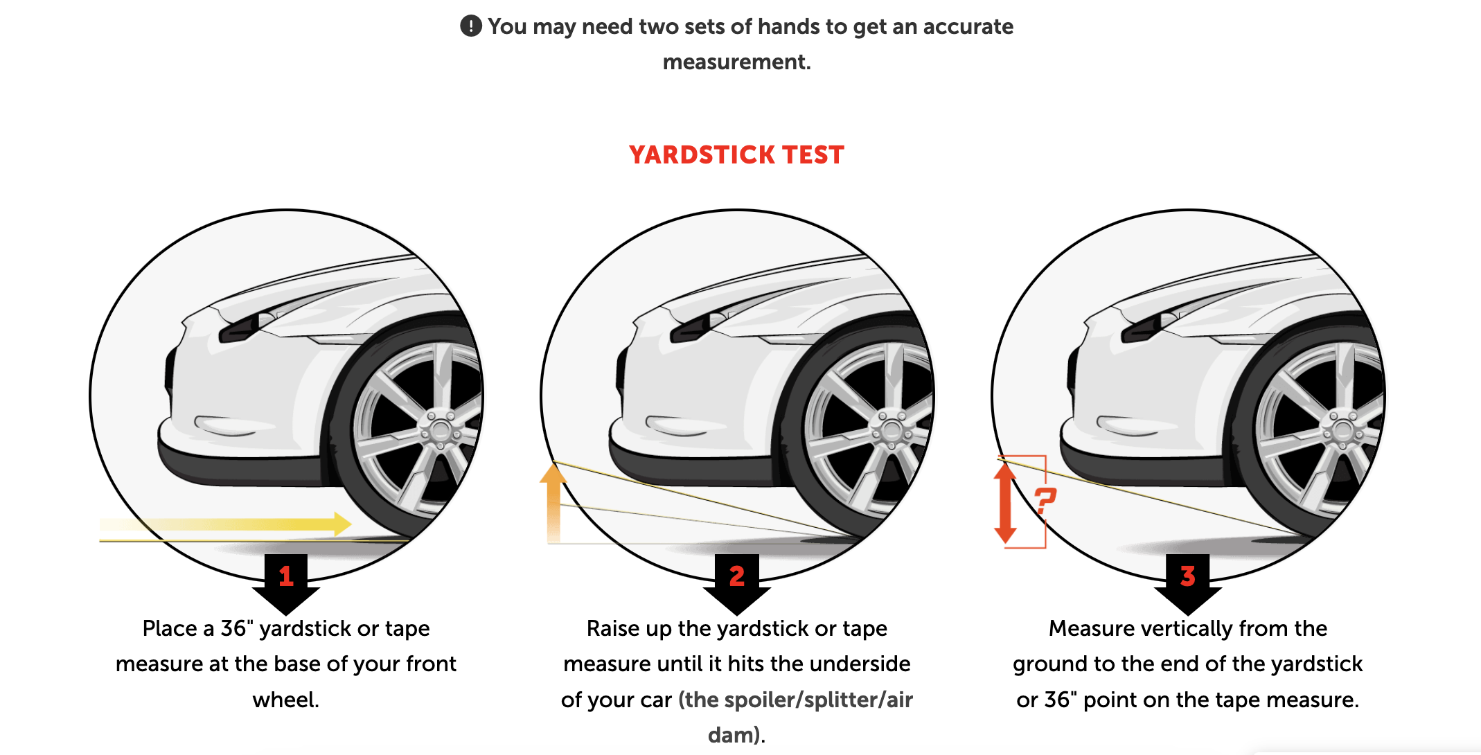

I don't have the carbon but I have used them with a C7 Grandsport, ZL1 and 4BW. If you use the 67" you should clear fine with the 10.8 degree of approach. If you want to confirm, use the approach angle calculator on the bottom page of this url.

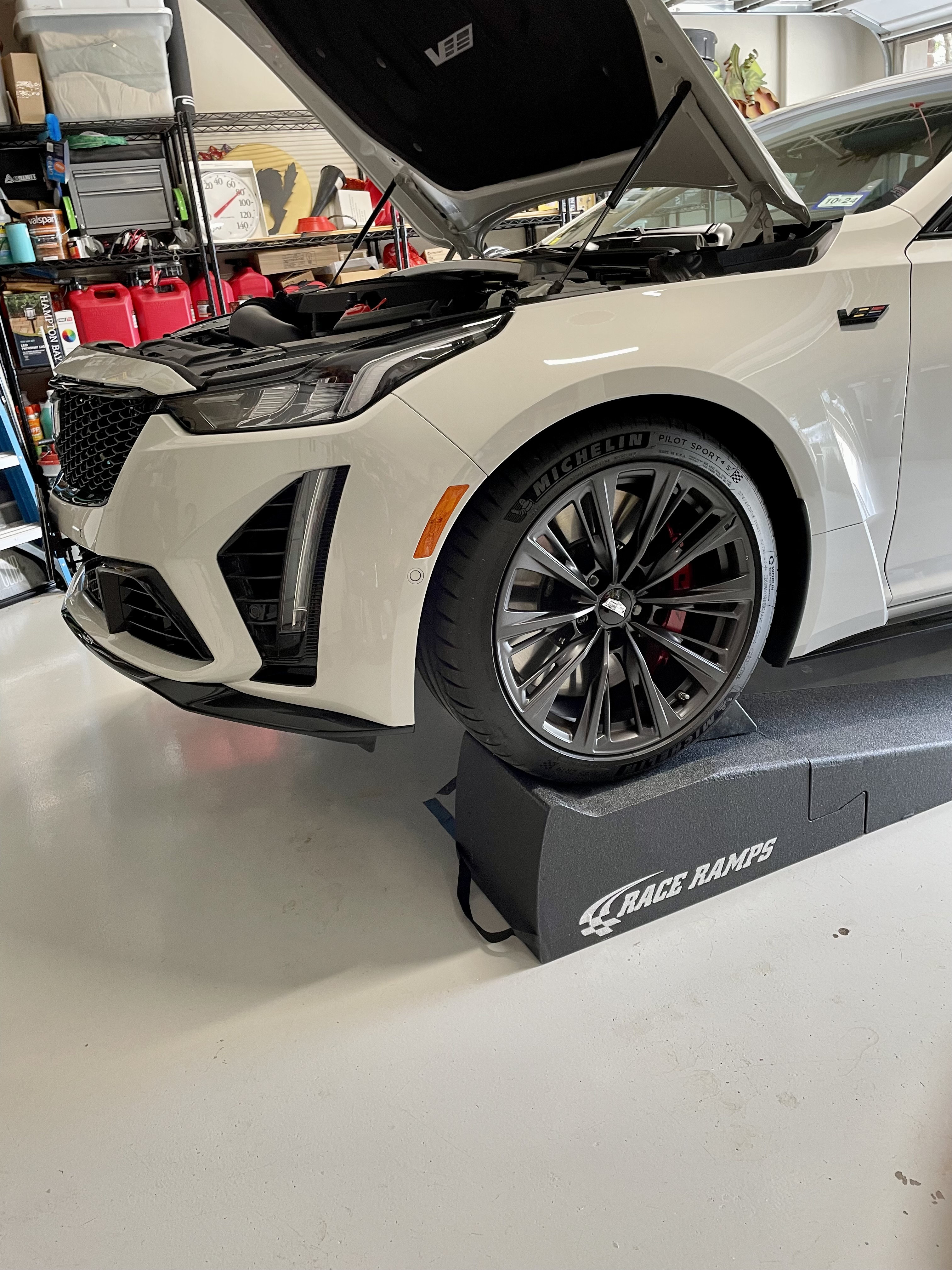

I picked up the 56" race ramp package from Speedway with 4 wheel chocks. Clearance is fine both front and easily on the rear.
These are one piece. 2 piece are top tier. For what i need, If I have to work on a particular side of the car where the ramp is in the way I will simply raise the car a bit and rotate the ramp 180 degrees let her back down on the ramp get my work done subsequently, reverse back when finished. I feel totally comfortable under the car with these ramps and the chocks working together.

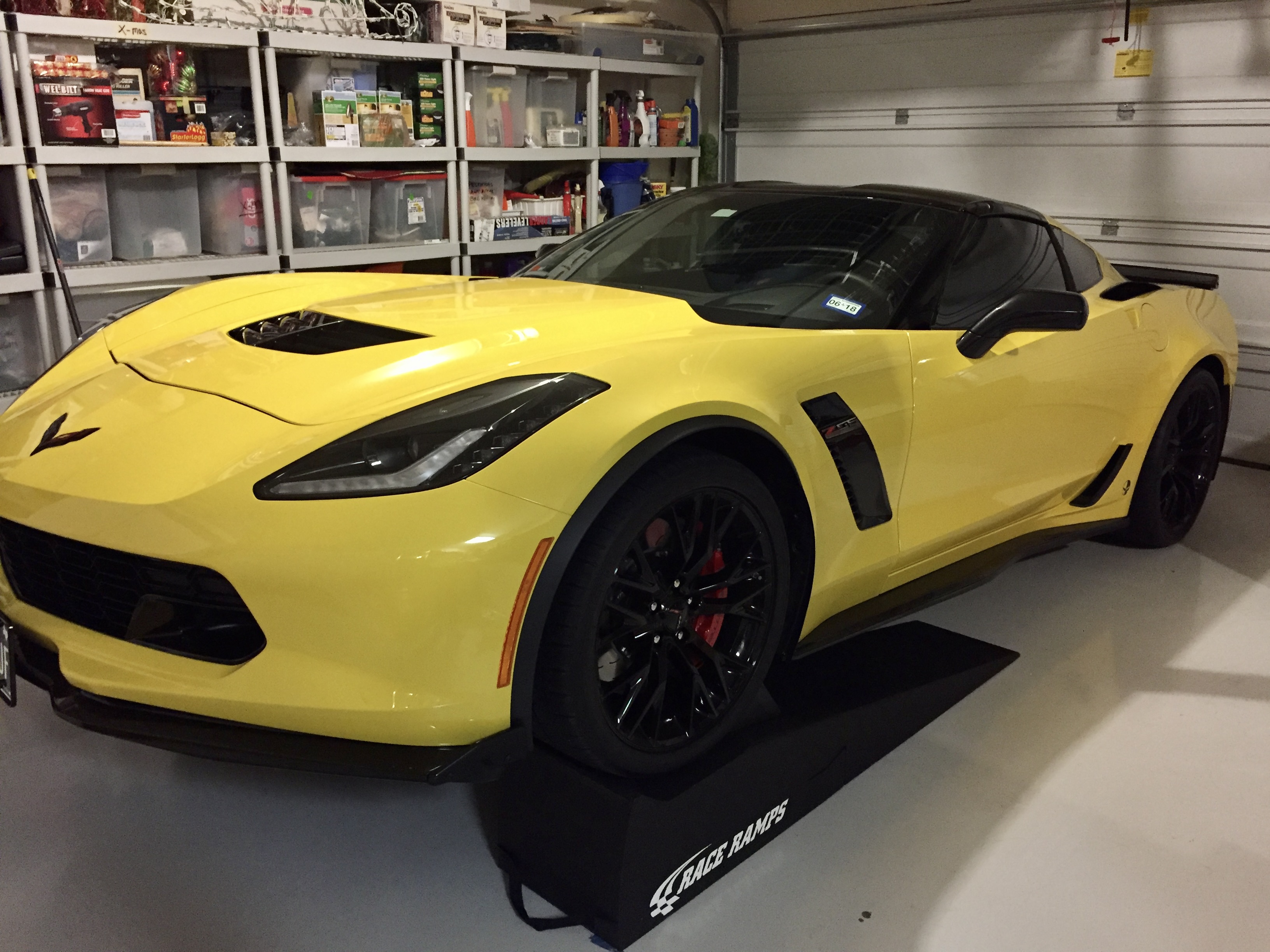

Yep, speedway is where I bought mine. Got the bundle with the wheel chocks, which saves a bit.
I bought mine when I had a C7 Grandsport and the 56" would rub a little so I went with the 67", otherwise the 56" are fine for the 4BW and less expensive.

Just to add an edit, my setup works fine on a 5BW with the CF1 package.

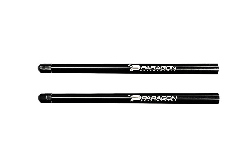

Damn the stock rears are heavy! Anyone have the specs for wheel stud extenders? I have wheel hangers from my old Audi but they won't work here since the Audi had lug bolts. Our wheel nut thread specs are M14 x 1.5?
Hit the gym. My Jeep tires weight 110lbs.
This might work...
Reverse logic sold their company to someone called Steelman. I got mine in their E-Bay shop. I believe this is it. STEELMAN Stainless Steel Female M14 x 1.5 Hex Wheel Hanger Lug Guide Tool, 61012 99198610122 | eBay
