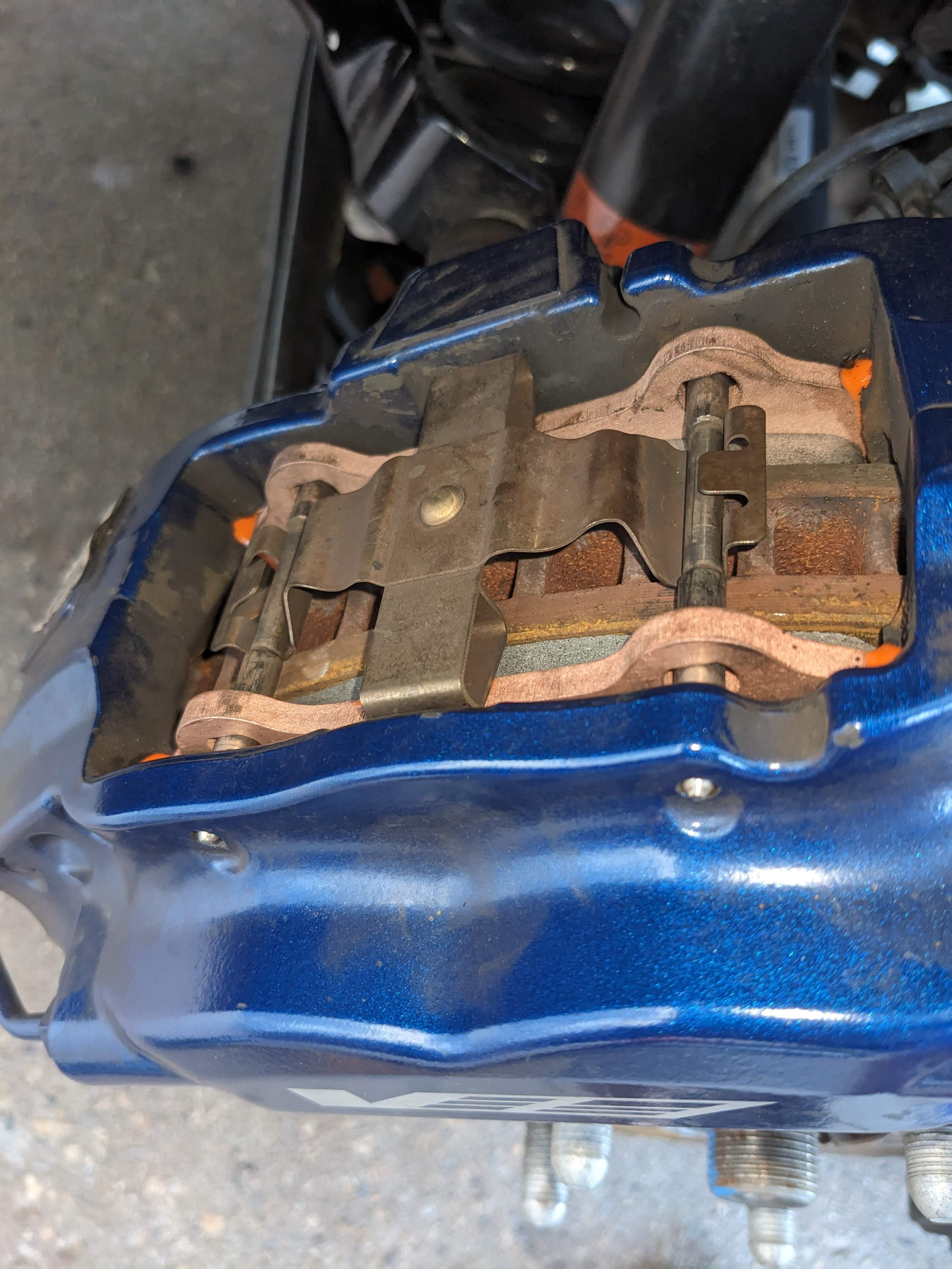

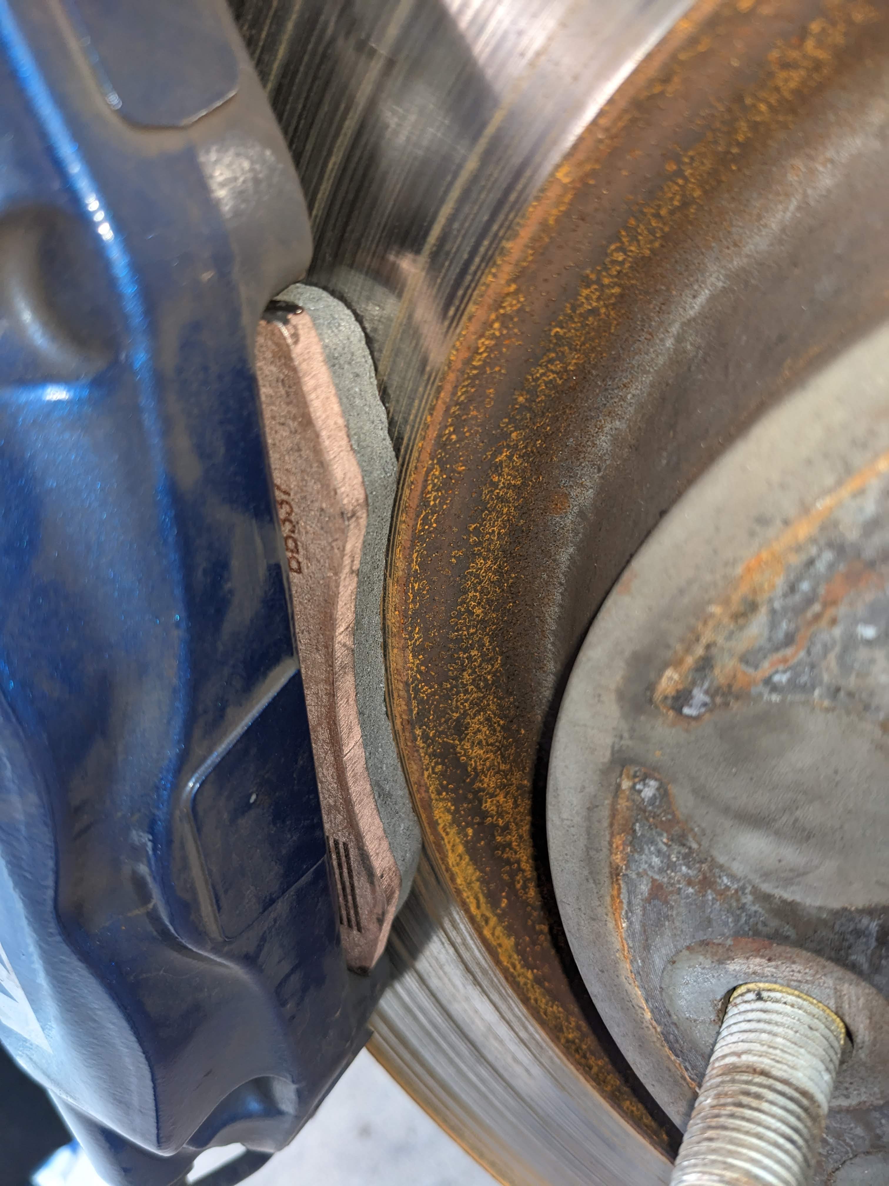

I ordered a set of the DP81140.14SR11 from ECS (who now have a lifetime replacement replacement program like FCP Euro) and was able to test their fitment today. I can confirm that this is the part number you want for the rear pads. The only thing I ran into was that the backing plates were slightly too large out of the box, which prevented them from sliding in easily. I think they must've been too large by a couple thousandths of an inch. A little bit of grinding later and they fit perfectly.
They showed up just in time for Watkins Glen next weekend, so I'm excited to see how they perform.
