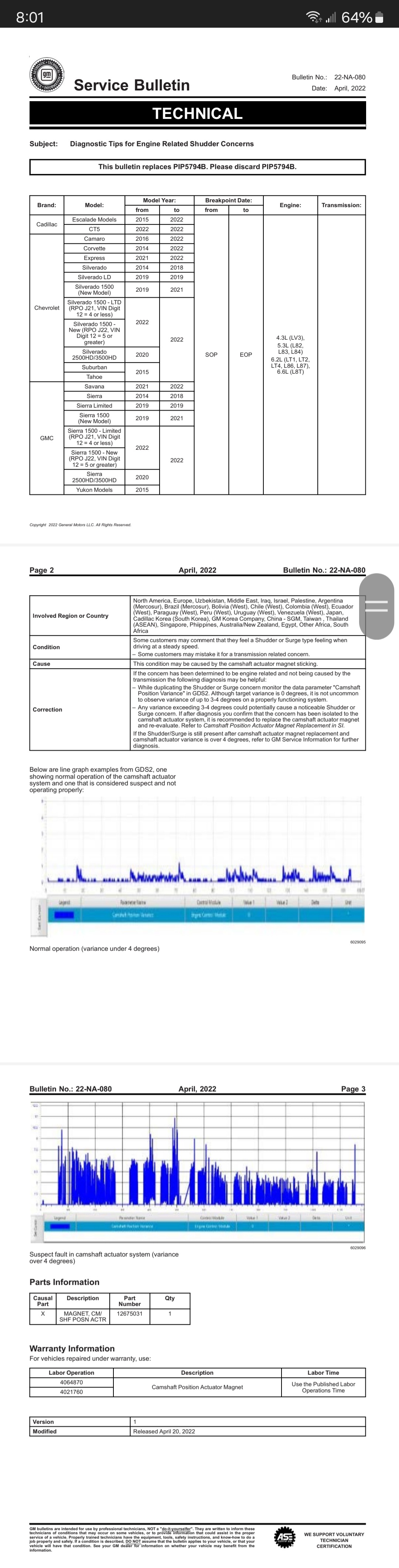

I don't know about that (function of the driver?)...there is a TSB regarding this issue with the cam actuators....this is an inherent issue in some cars...several folks on the FB BW groups have had this issue and it was resolved after the TSB fix. I have had it all along 2022 5 V BW but mine is very intermittent.

I guess as @rubberduck said, there are two versions of surging...the one I'm referring to is the low speed (parking lot for instance) bucking/surging resonance. 3/4 throttle at highway speeds is not at all what I'm talking about, so yours sounds more like the TSB issue.
Actually the TSB issue is at steady speed but my issue is at low rpm part throttle

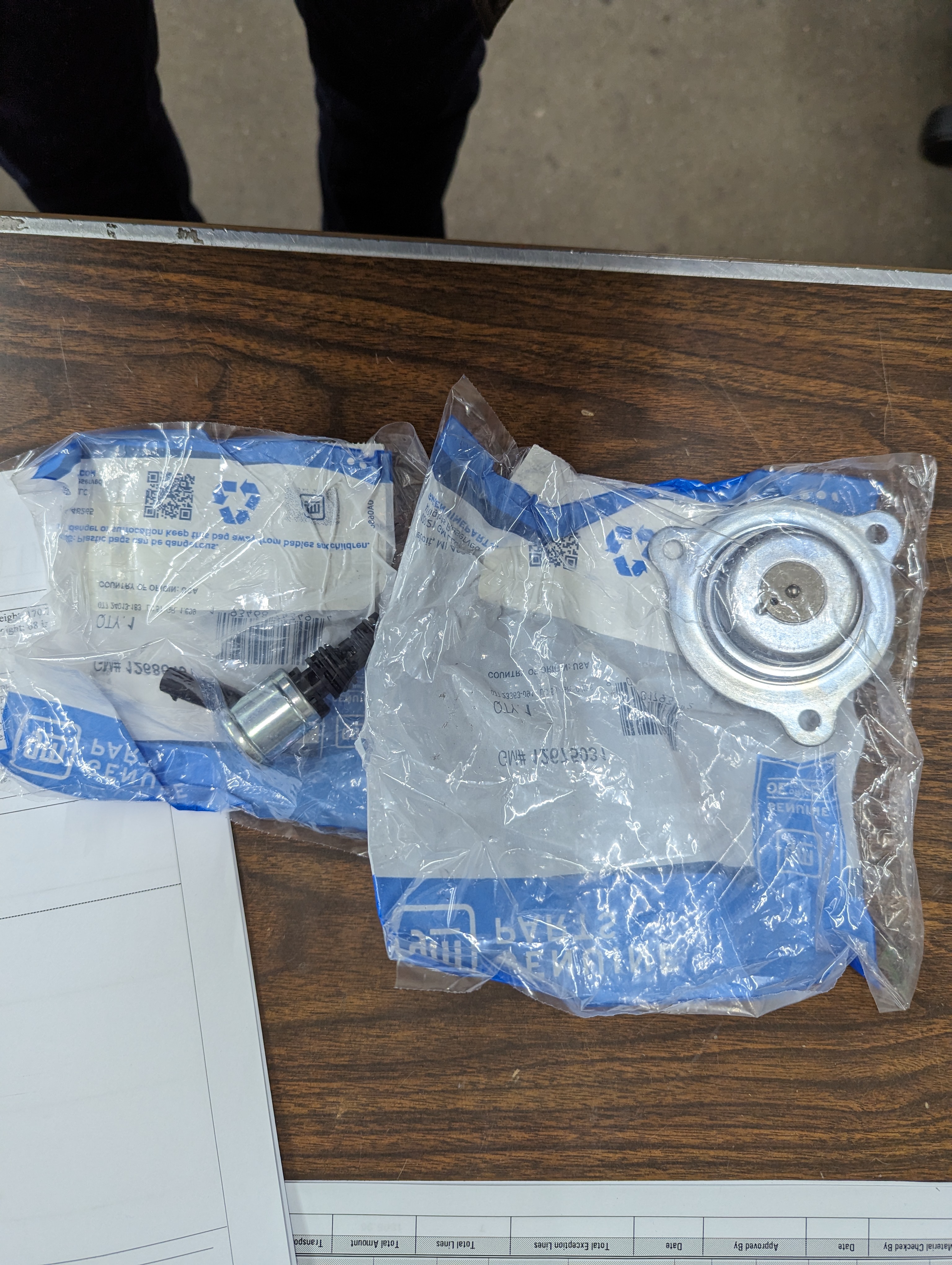

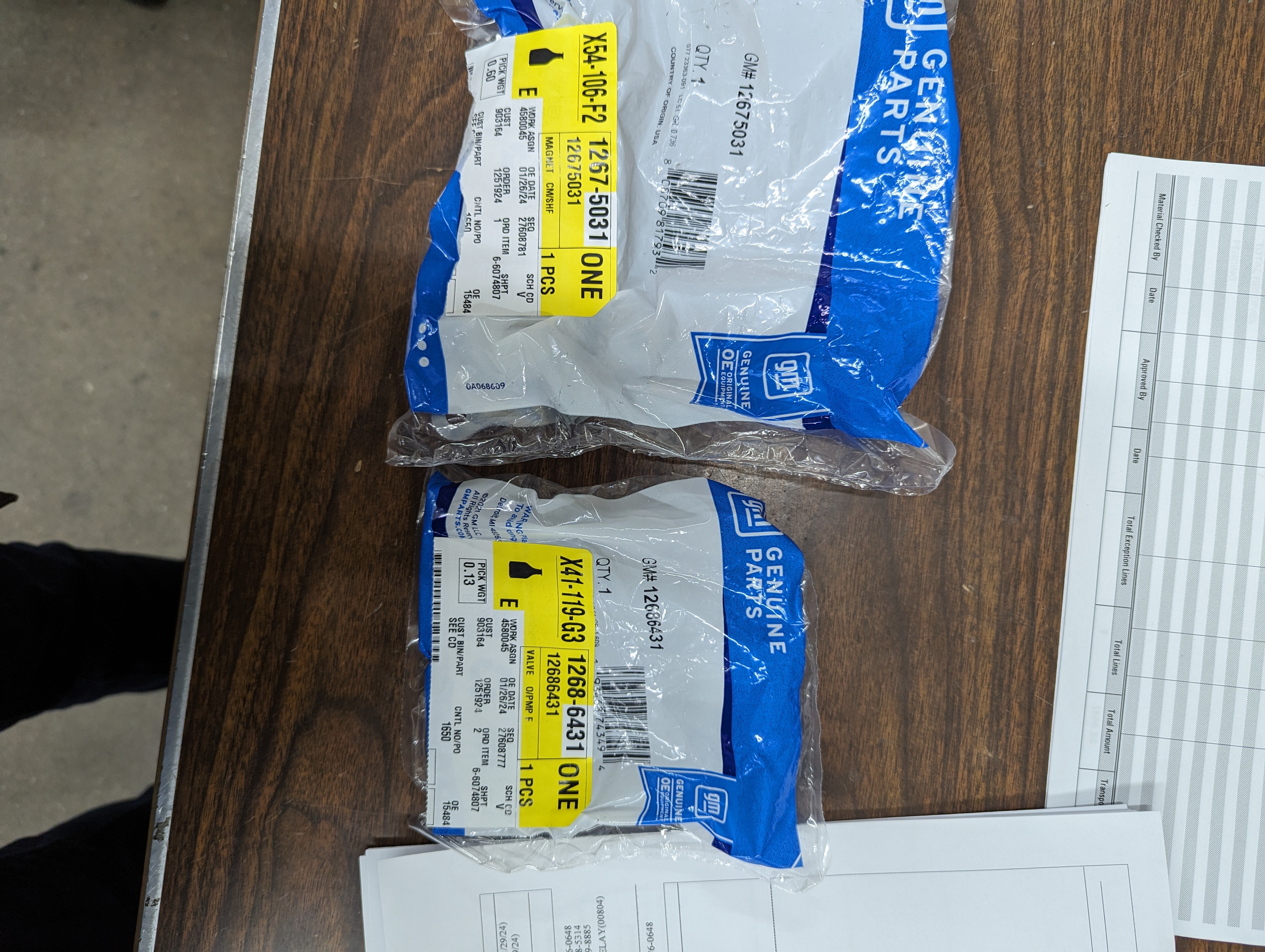

Car at the dealer for the tsB fix....looks like cam sensor magnet and a check valve.
