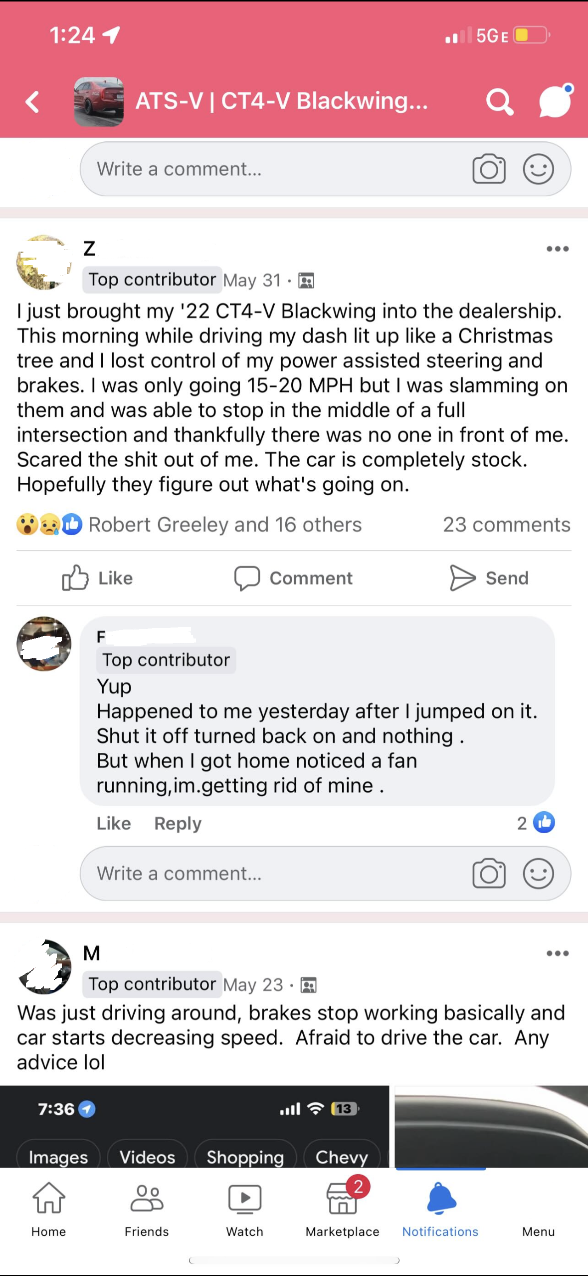

The conversations occurring in the ATSV/CT4BW FB groups were brought to my attention - check out this screenshot:
These guys had it happen within the last 2-3 weeks. Counting myself, I know of two other people that this has happened to, one of whom ended up in a major car accident because of it. That makes 6..

Yes. The screenshot alone has 3 different people describing the same thing occurring to them within 7 days of each other. I personally know more folks it's happened to, myself included.

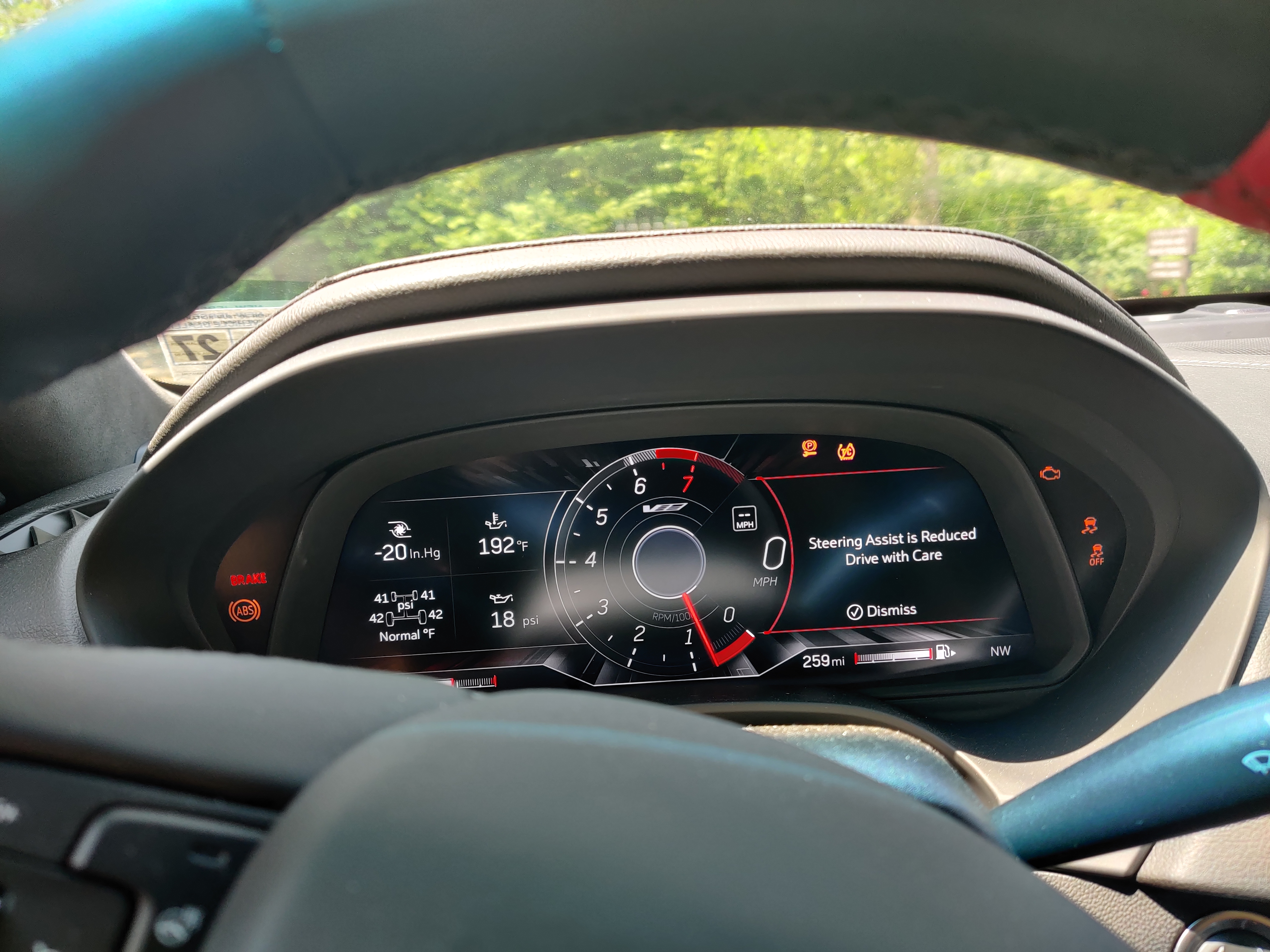

Mine was the same way. I was driving for a good while (maybe like 20 ish minutes) just trying to put my baby to sleep. While I was driving my dash lit up; it never shut off. My steering was stiff, the brakes were much harder, and the CEL went on. I got a picture of the errors I had while it happened. The biggest issue was with the brakes because I had to slam them in order to stop normally since there was no brake boost. Power steering going off didn't affect me that bad. After parking, I couldn't set the e-brake which is another big no-no. I turned the car on and off after parking and the CEL didn't go away. The next day I turned the car on and the e-brake, steering assist, brake assist all worked again, so I moved it out of my driveway into a spare spot and chocked the wheels.

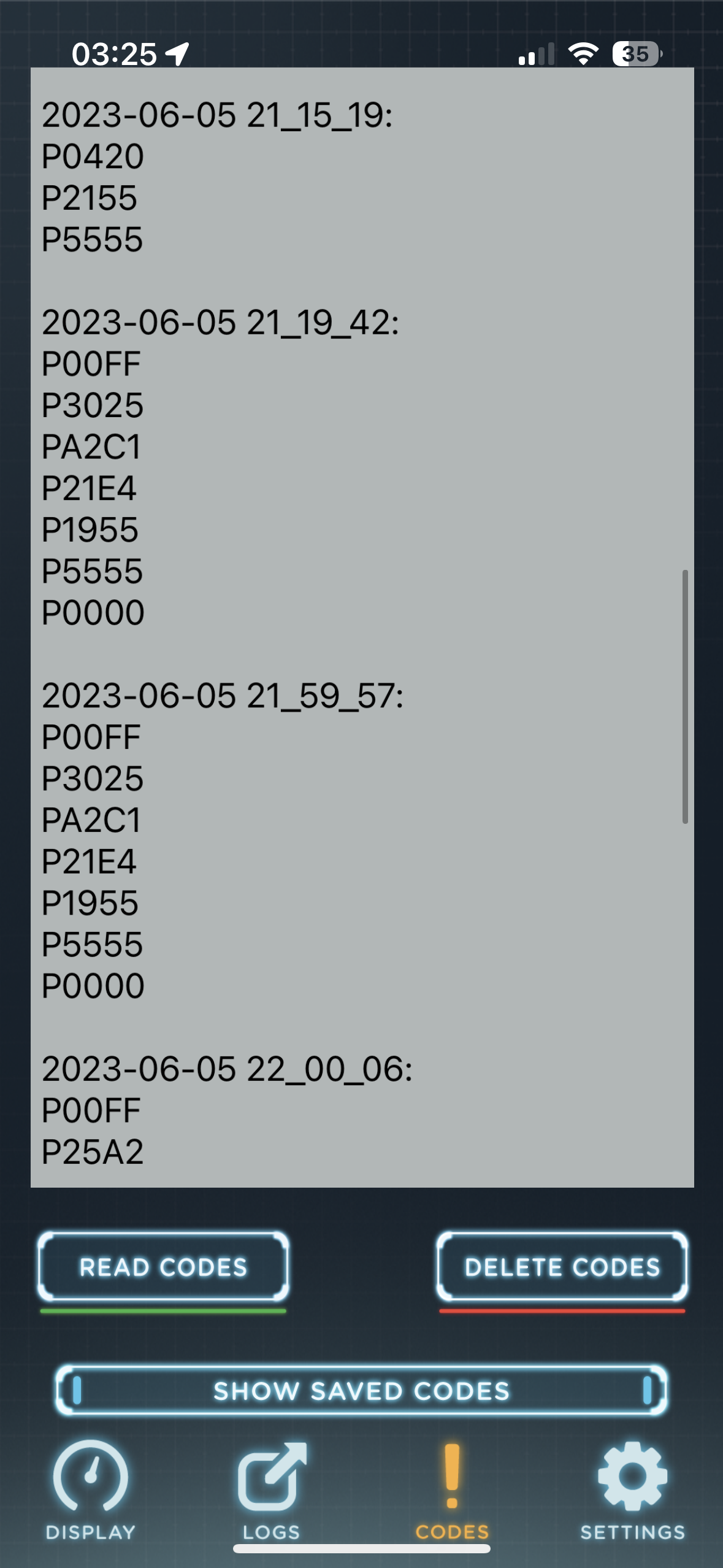

Here are the codes mine threw - Not sure if they’re of any use to anyone:
