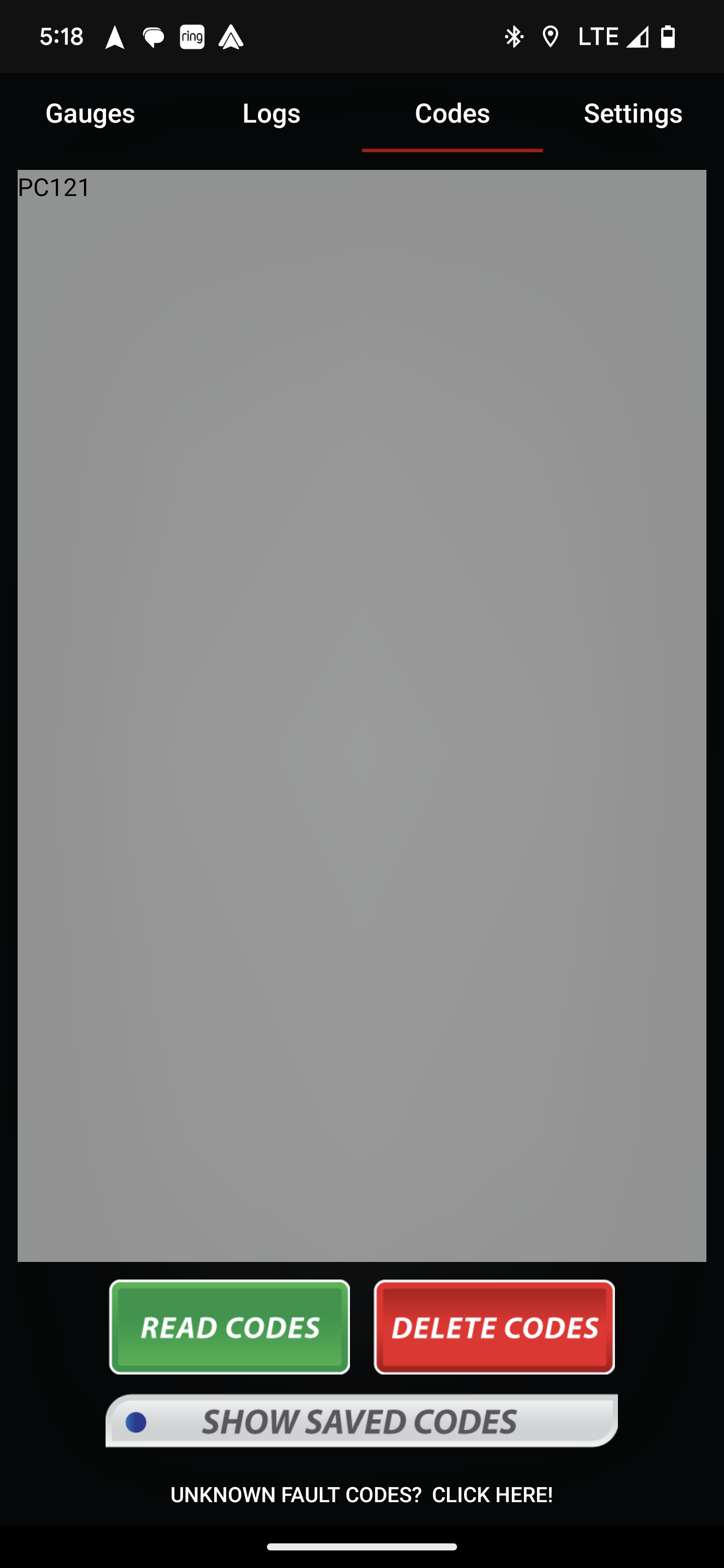

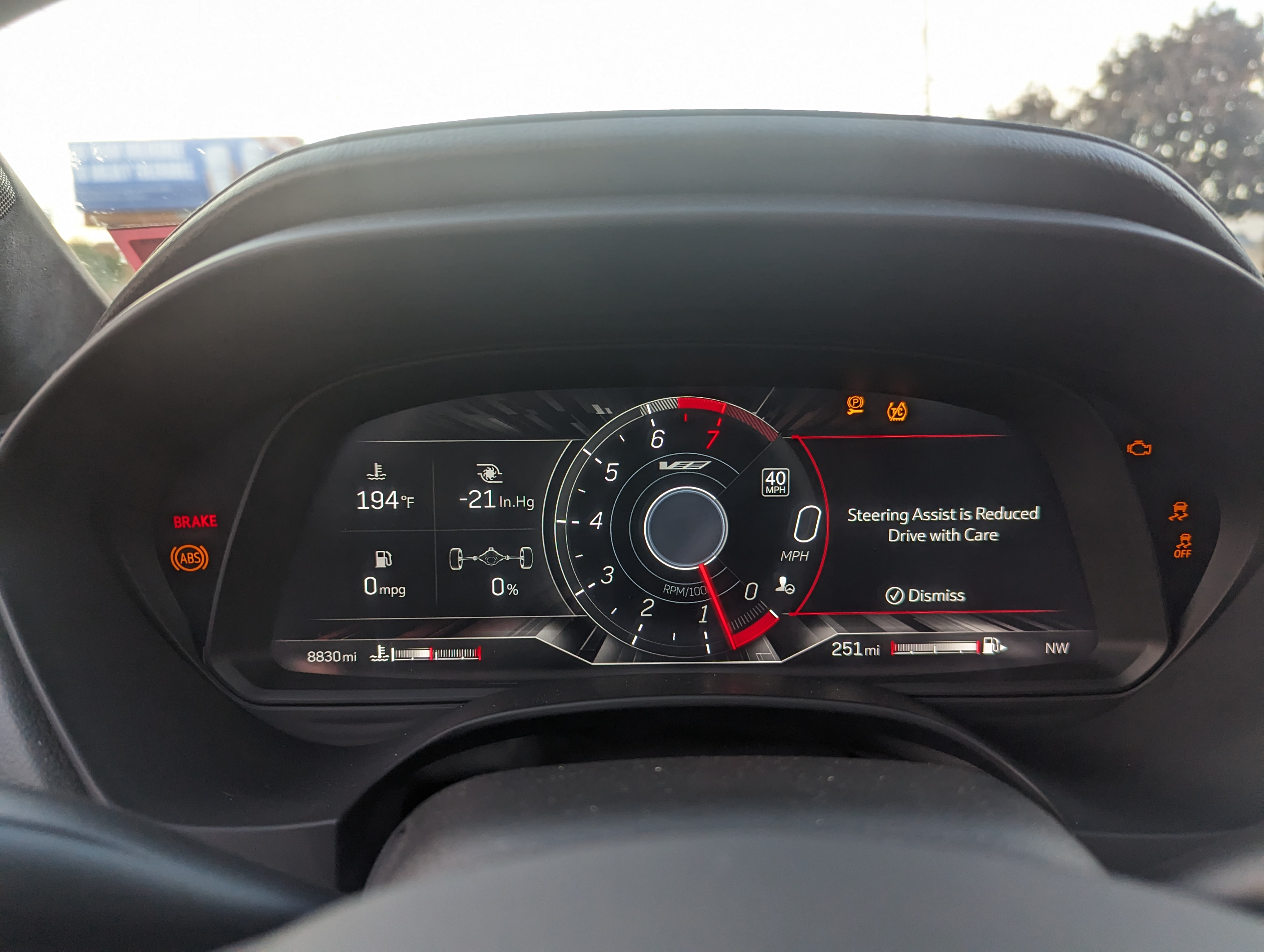

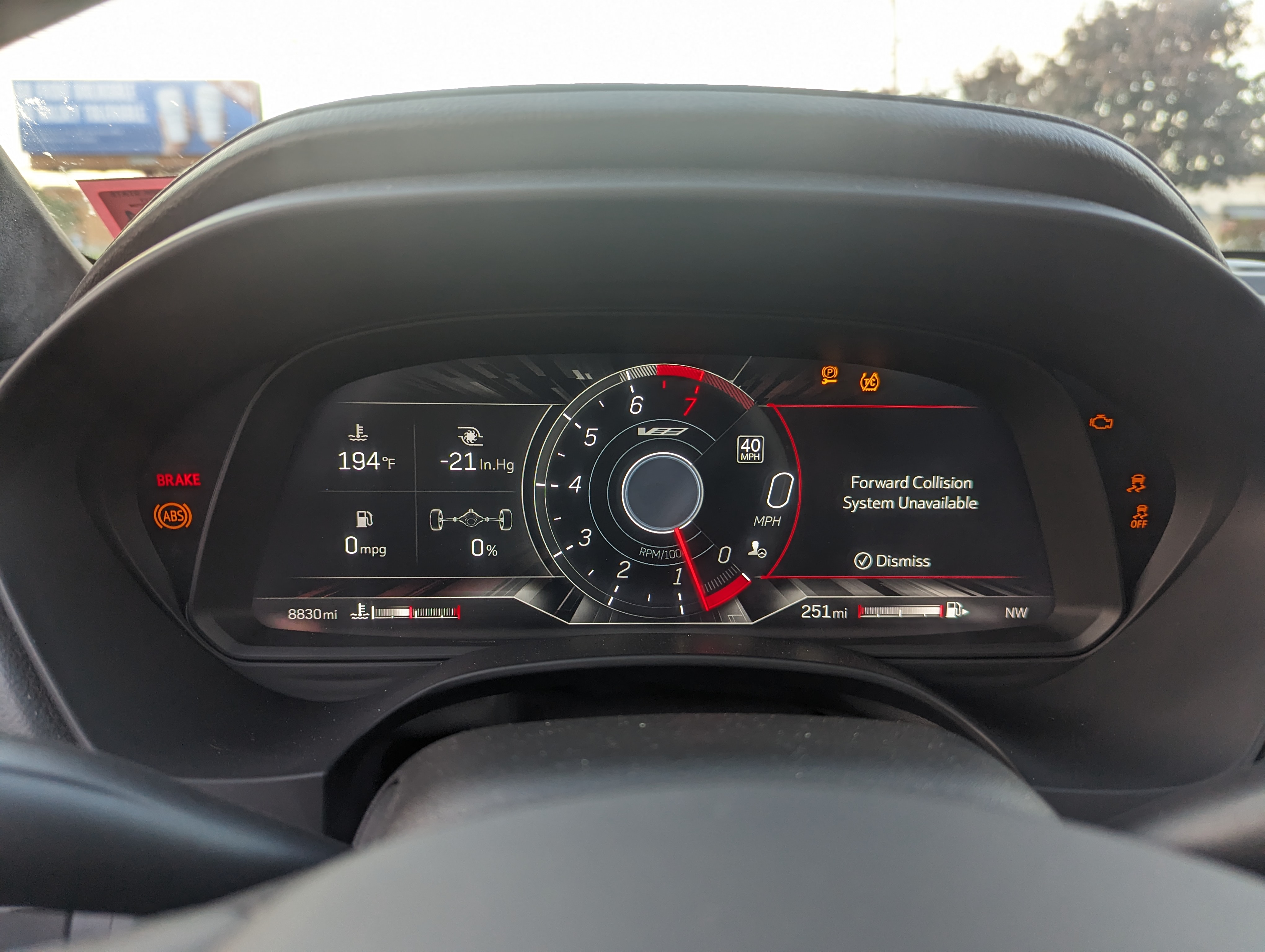

Well add mine to the list, driving home in rush hour traffic, went to hit the brakes and they were rock hard with little response. After avoiding the car I was behind I looked down and saw the dash lit up. Speed limited to 62mph, steering assist reduced, engine in quiet mode. Checked the codes PC121. My good scan tool is at the shop. Shutting it off and starting it back up shut all the lights off but the check engine and I got brakes back. Wish I had the other scan tool with me I have a feeling most of the codes are going to disappear.

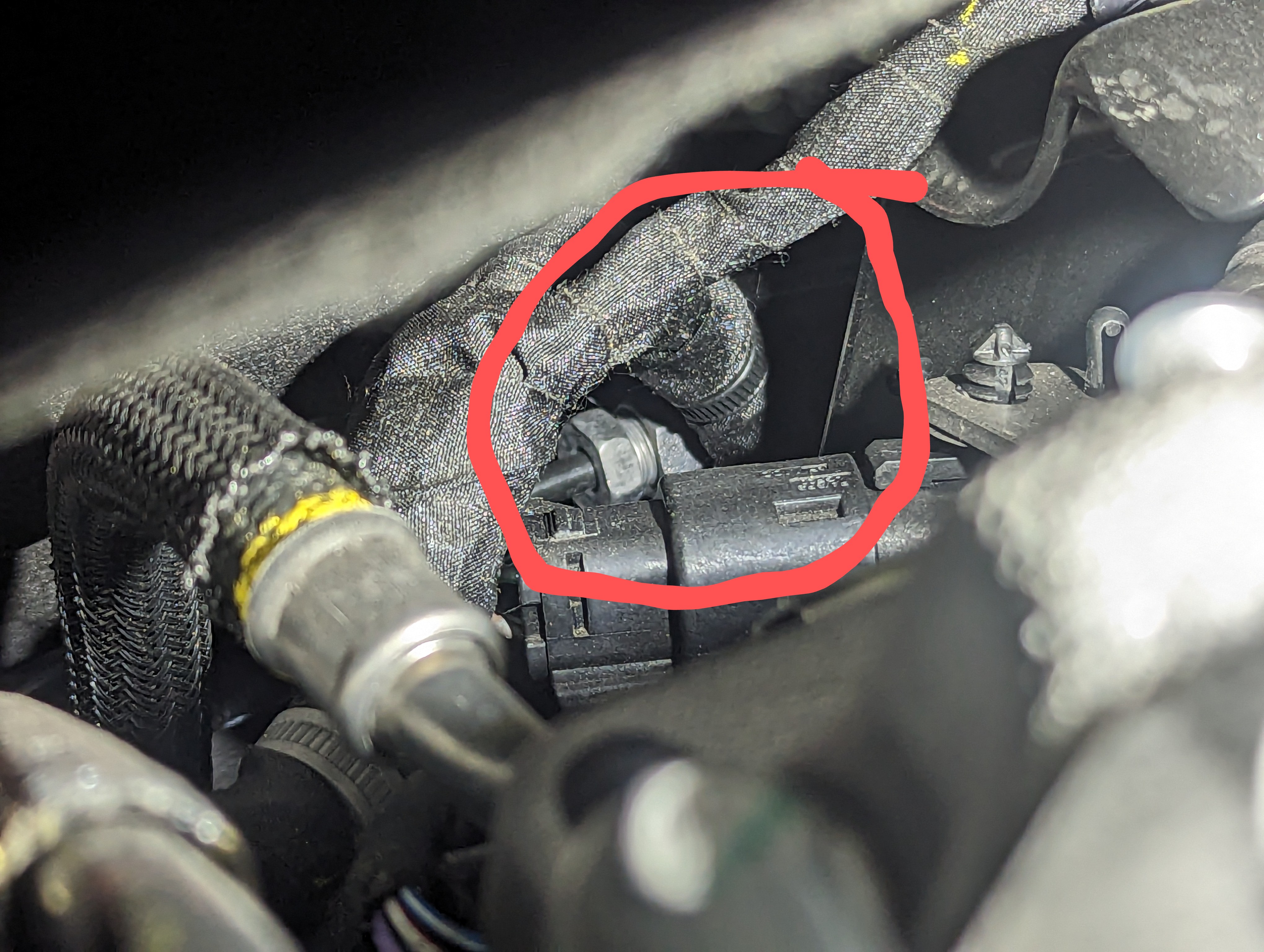

Did you get the letter in the mail from Cadillac with regards to the recall? It is the installation of the anti-abrasion sleeve which secures the harness away from the brake line.
I did. I'm going to see if they have pictures of exactly where the area of concern is. Just quickly looking at it tonight this looks like a possible suspect.
