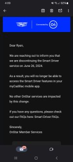

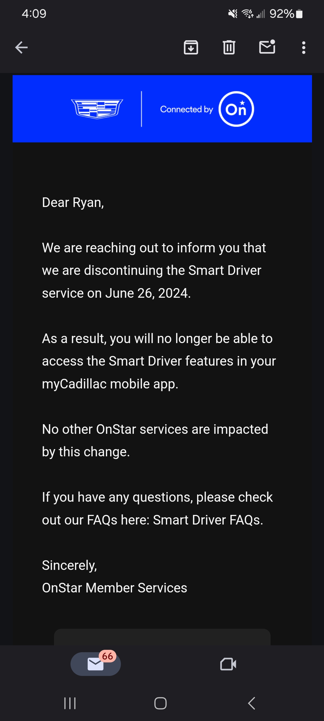

I got this email on Thursday, which I assume is related to this.

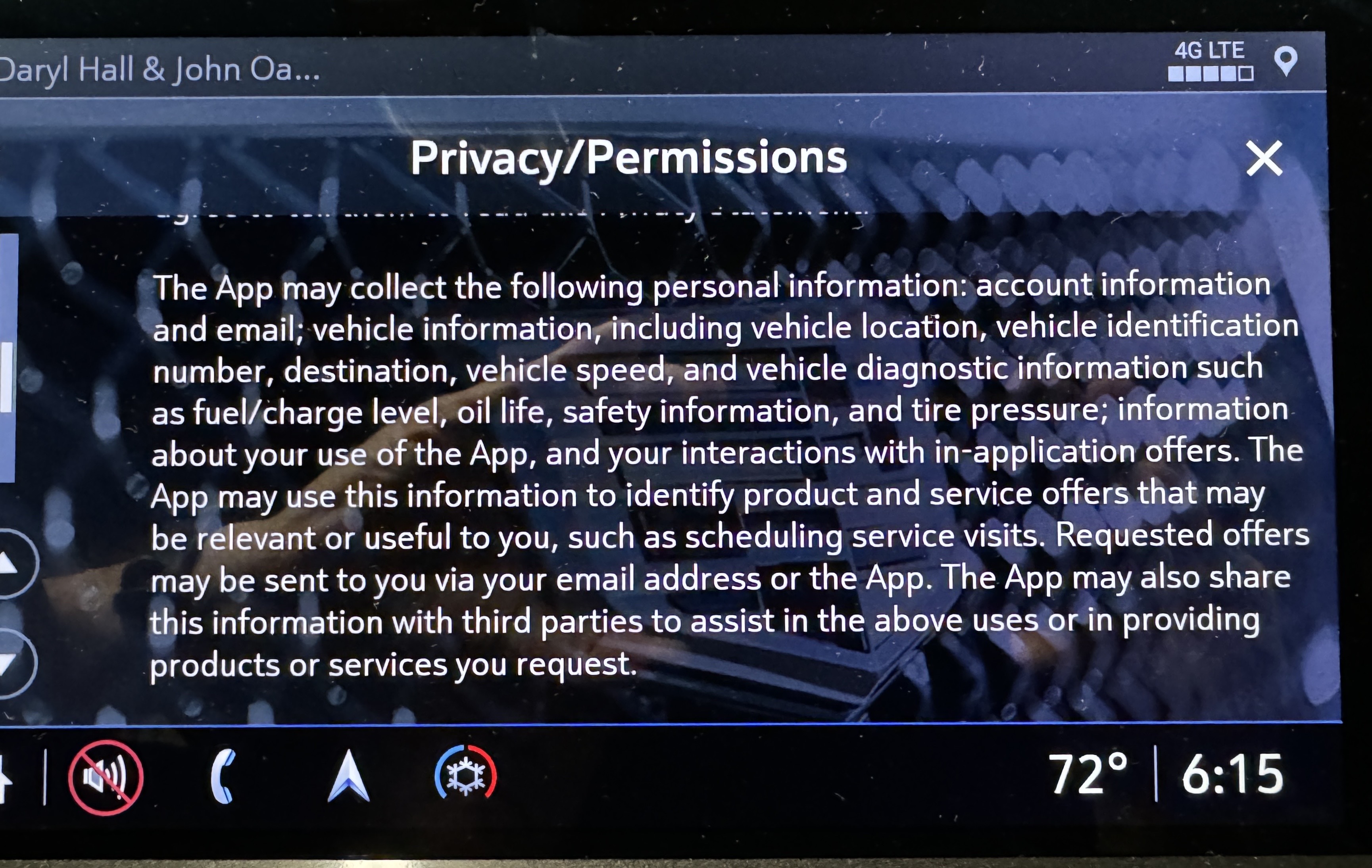

Has anyone figured out where the location services privacy setting is?
Here’s a screenshot from the OnStar permissions info page. Total BS
