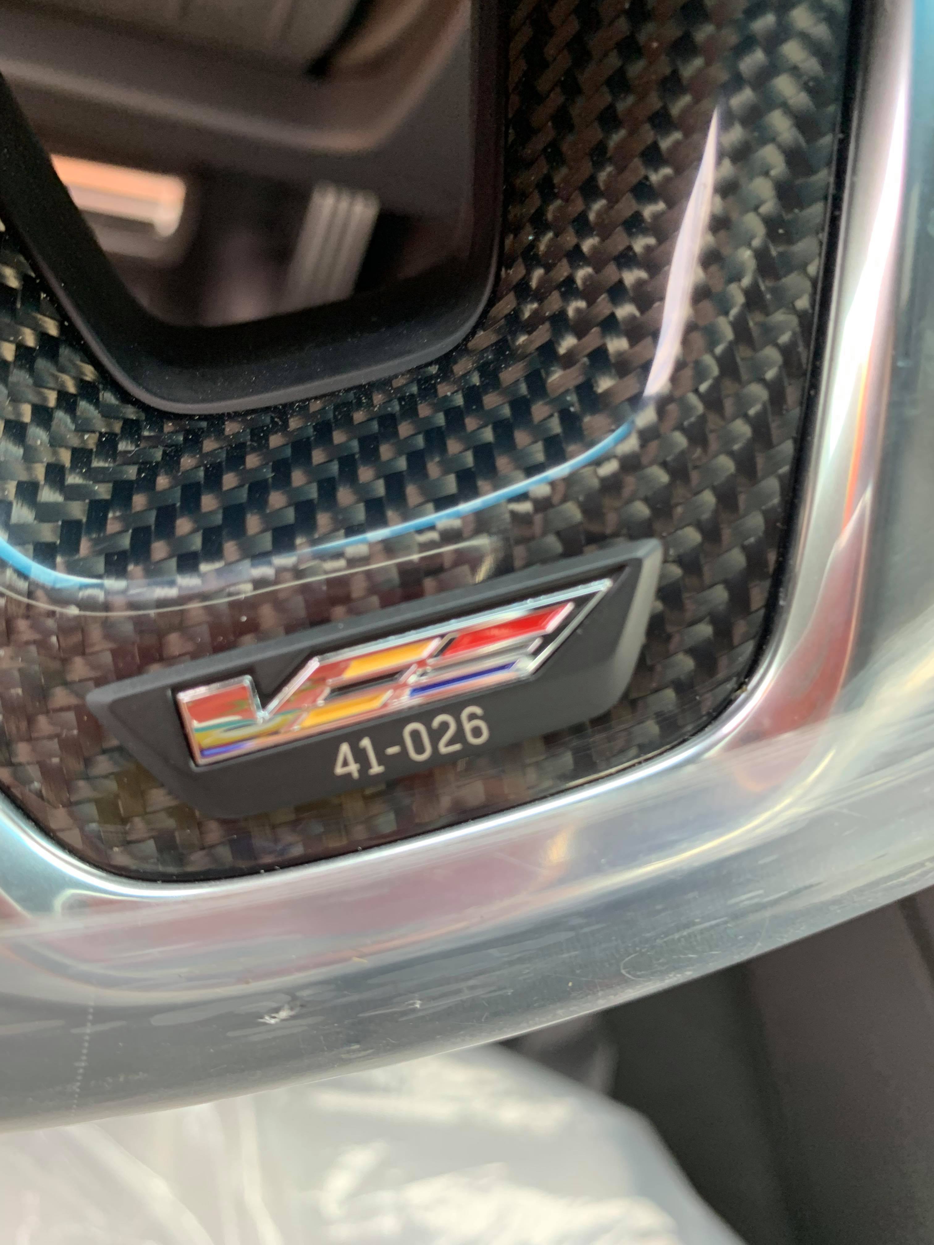

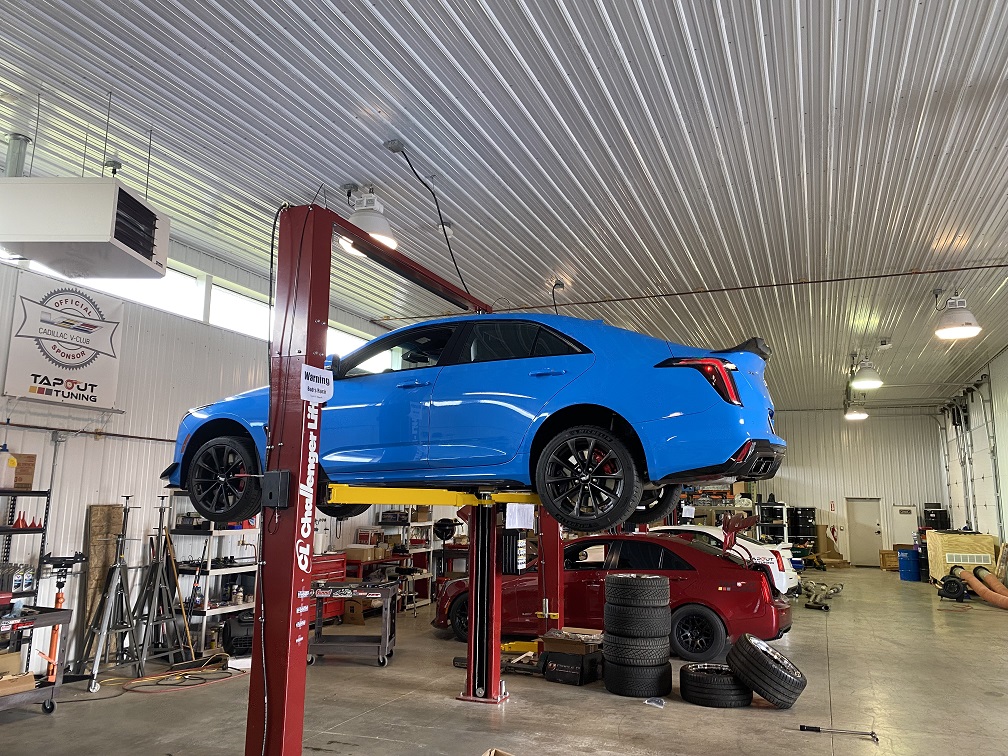

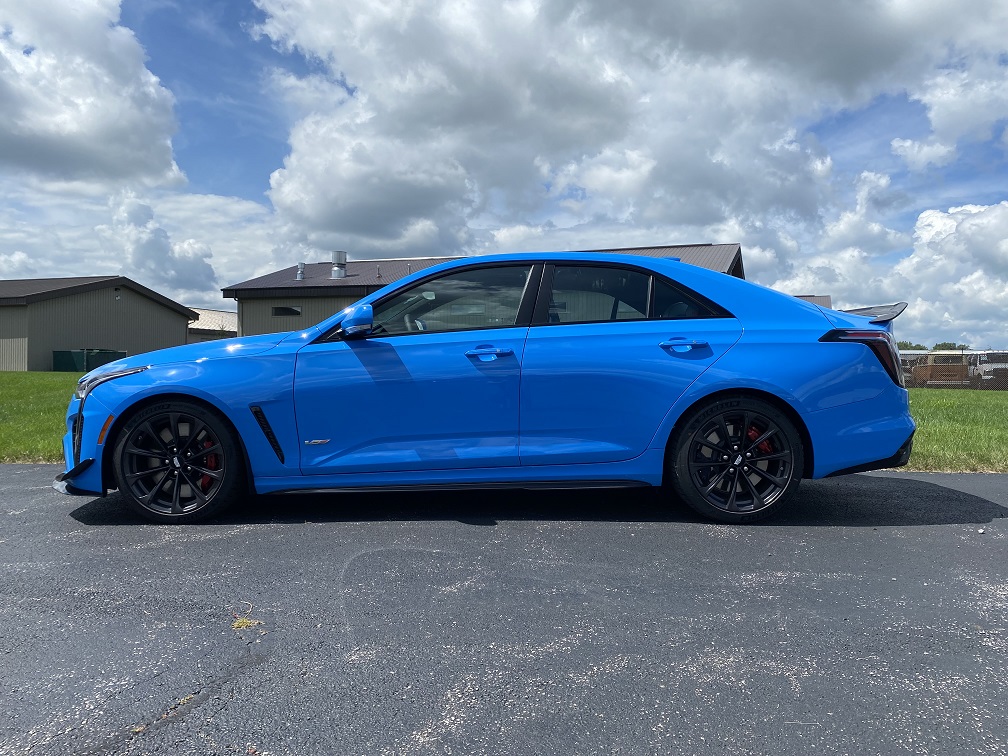

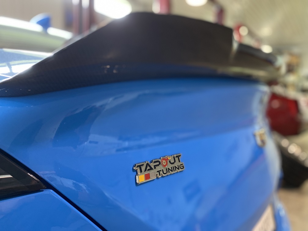

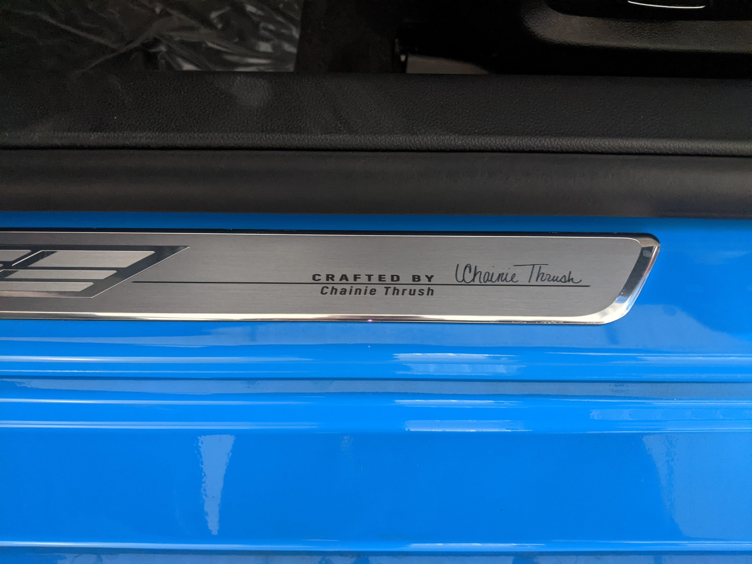

For reference, this car is serial #0026. It was pre-ordered February 1, manufactured July 21, shipped August 4 and arrived at the dealership on August 17.

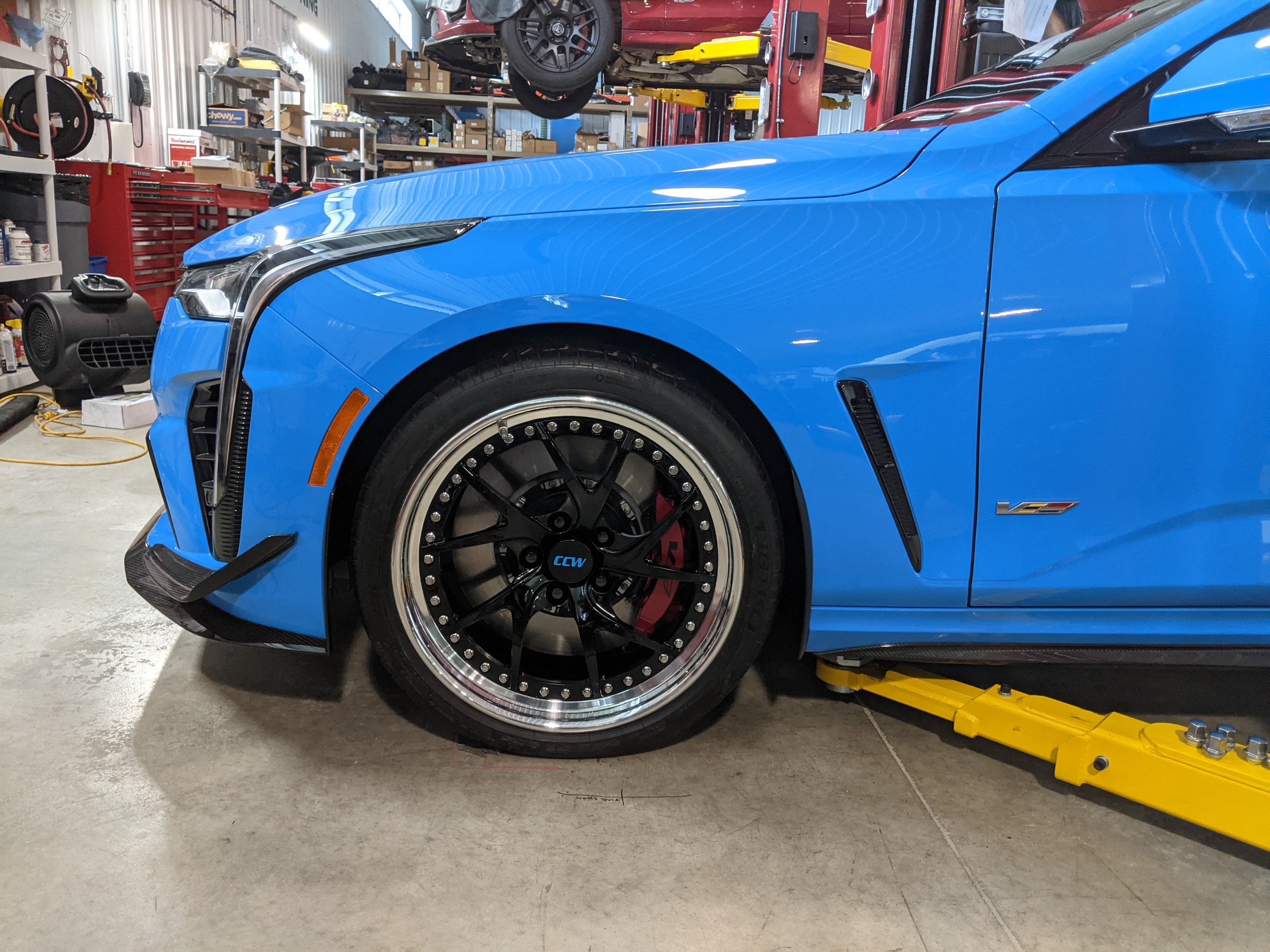

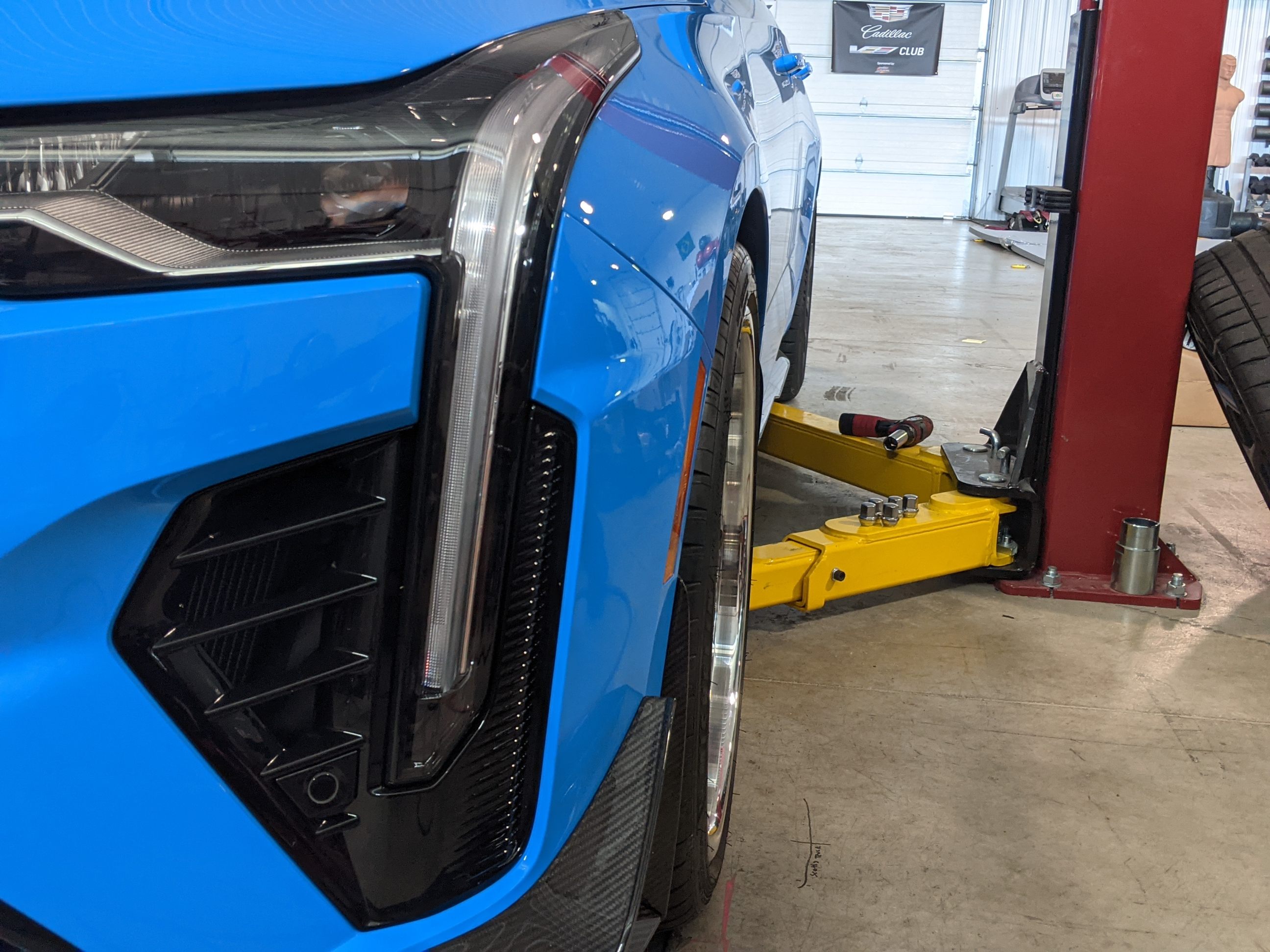

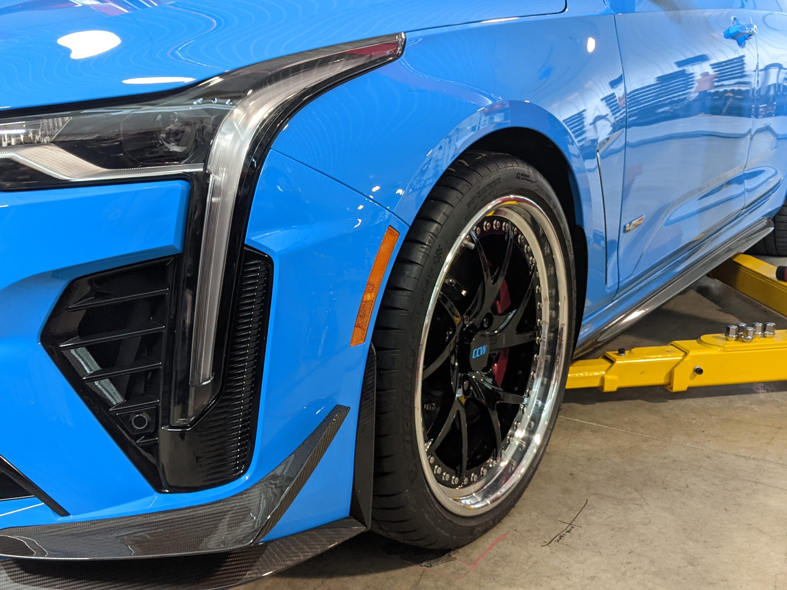

So I had some leftover ATS-V wheels that I had refinished to match the new Blackwing. The fronts fit perfectly, but the rears have no chance of clearing the new, larger calipers.
The new calioers are same size as CTs-V or the non carbon CT5-V Blackwing. A LOT more brake in rear in the Ct4-V Blackwing than ATS-V. Larger od (329mm to 340mm), thicker rotor 26 to 28mm i believe and no drun in hat so no drun on inside of rotor, very smooth hat for great airflow and cooling.
scott what are front tires on the new rims 255s still or?
Mirza, as you know, the CT4-V Blackwing OEM front wheels are 18 x 9s with 255 tires. Our custom CCWs are 18 x 9.5s with 275s, and they seem to fit the front perfectly.
Wow. Thats wide, awesome.

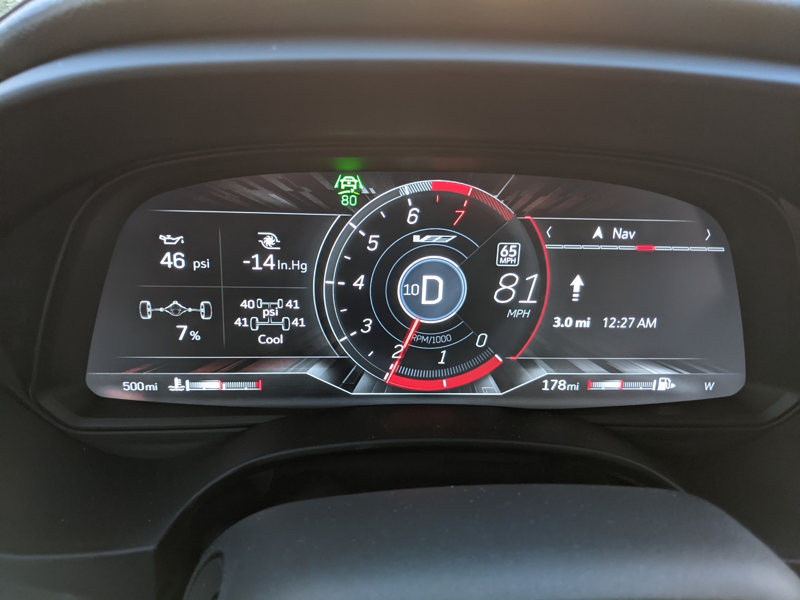

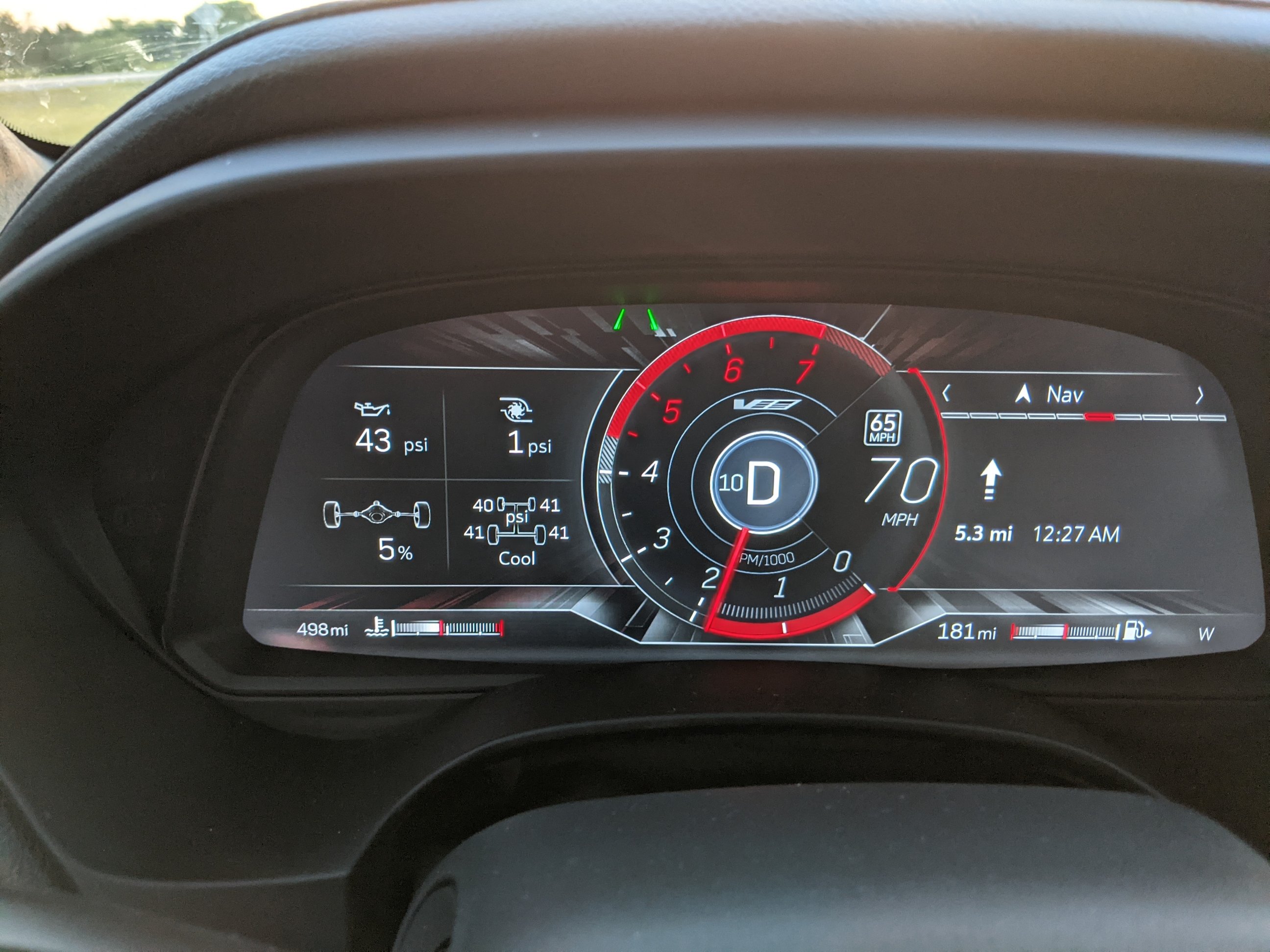

Got in a solid road trip this weekend. Already have 800 miles on the clock. Here you can see how the recommended rev limiter increases at 500 miles.
