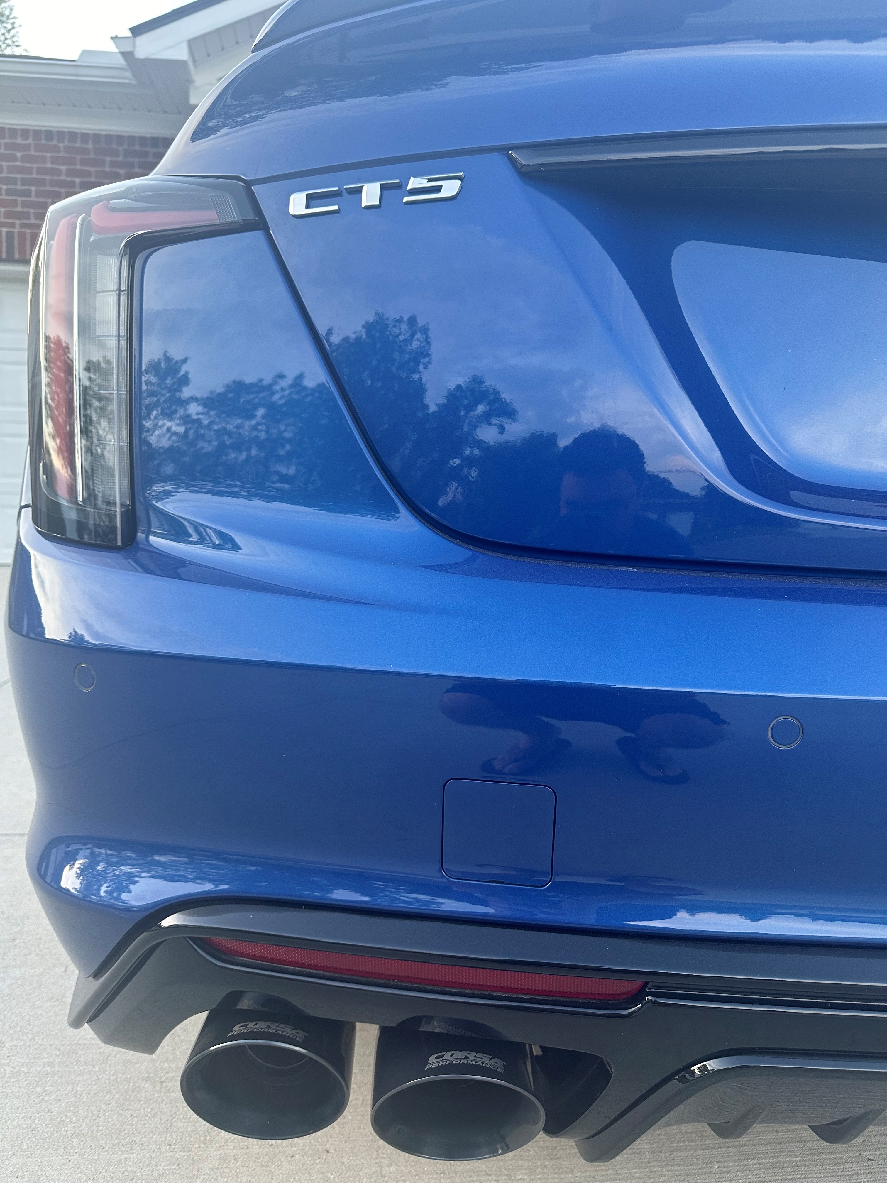

Fitment/Appearance: I went with the black PVD angled tips. There two 4.5" tips on each side and they fills up the rear valence perfectly. I know there is a lot of discussion about the stock exhaust tips and I was on the fence also, until I saw the two 4.5" tips mocked up and then I was sold.

Anymore pics of the exhaust tips. Thanks!
