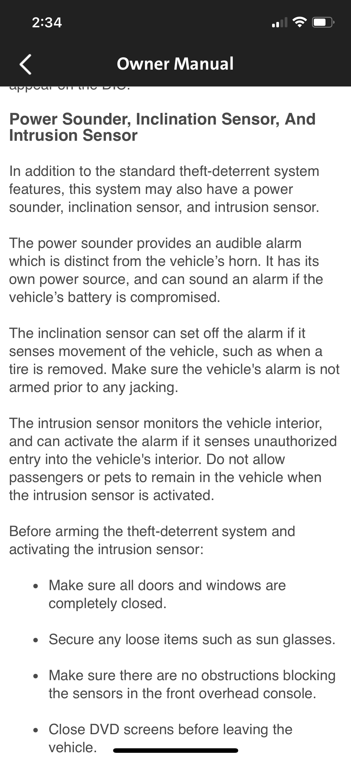

Hmmm my 5BW did this in the garage the other day after parking it up and locking it. Went off within a minute. I didn’t have to disarm or unlock the vehicle. I think it may be related to the ‘power sounder’.

As much as I assume its some crap the dealer installed, I'm leaning towards an issue with the intrusion alarm or the "power sounder". Given Mulignan hears the same sound.
If its done it every time you drive the car, I'd have the alarm system looked at.

I don't think that little weeny noise has any feature of the OEM alarm system. Who is going to be deterred by that when only the person inside the car can hear it. Its makes noise inside so the thief knows it's being tracked, by the dealer.
