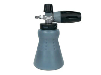

The standard is the MTM foam cannon. Autogeek is also having a fantastic sale, 25% off + FS after $95. Sometimes you get a lower discount + FS, or 25% off without FS, so I tend to wait for a sale like the one going on now.
You can definitely get away with cheaper ones in the 30-50$ range. For people not using the ideal 2GPM@1000PSI set up, and using a simple electric pressure washer like Ryobi, squeeze the foam cannon trigger a couple times before going full foam cannon. I don't know what it does, maybe aerates the mixture better, but without that step, you won't get great foam.

Pressure Washer: There is nothing better than the MTM Hydro. PF22 is current model.
Hose: Foam Gun is what you are looking for. Griots, Adams, Autogeek all have 'house' models that work fine.
