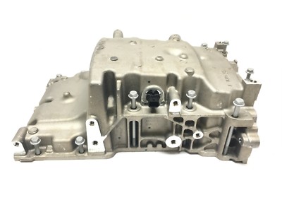

I think the LF4 uses a cast aluminum oil pan. I don't think porosity issues are anything new with modern aluminum casting processes, at least with GM. My '07 V1 had an issue with a porous rear main cover which was a known issue for the LS2 at the time.
Here is an example of one on eBay.
I haven't heard of a porous modern aluminum oil pan, but they can develop small cracks that are hard to see with the eye. If it keeps leaking press them to swap it out under warranty. It could be a manufacturing defect or result of improper installation.

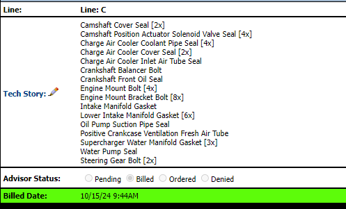

Apparently there has been a tech bulletin on this problem. Note that a LOT has to be removed to get it changed, way past the bottom of the engine: Cradles, suspension, damper pulley, etc. Manual lists the job at 19.5 hours!

Here's a parts list. plus the pan itself!!
In what world do you need to remove the intake manifold to change an oil pan?? Are they removing the entire engine?
Apparently they have to move it considerably. All the cradles, mounts, etc have to be moved.
