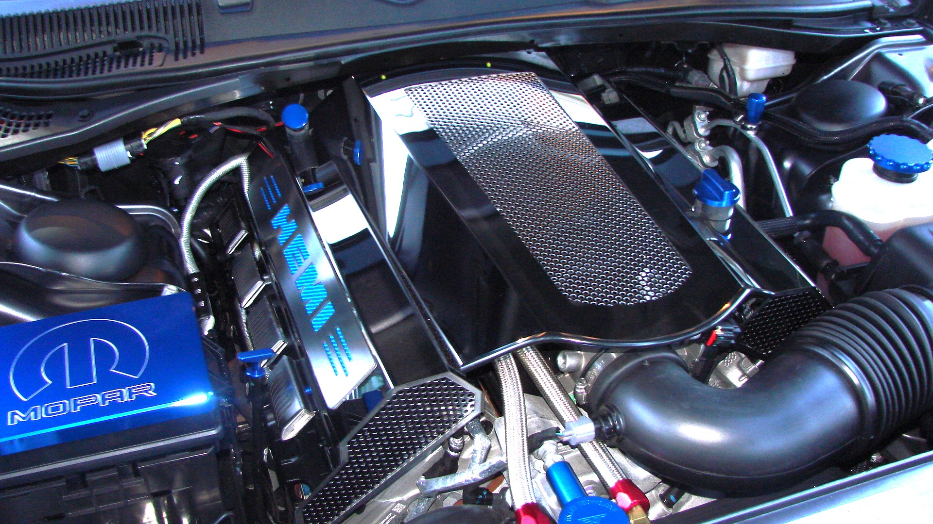

I have a Dodge Challenger and the oil fill port is on the top end/driverside. I have custom chrome on my engine bay and I've had the stupid tech changing my oil, dump oil all over the top end valve covers. Makes a mess. They didn't even try to clean it up nice. Now IF i go to them, I put blue paper towels all around the fill port to send them a message.
