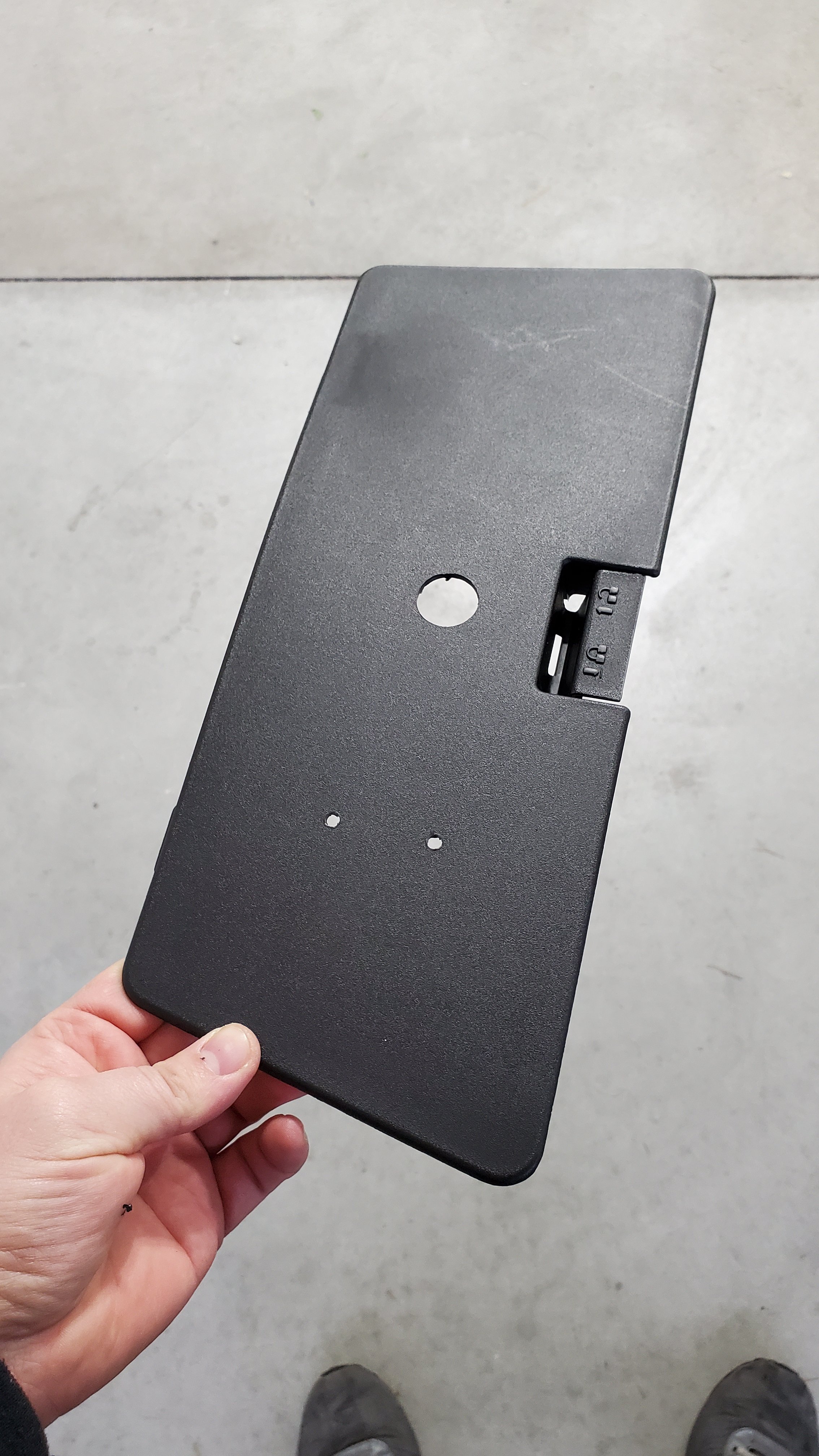

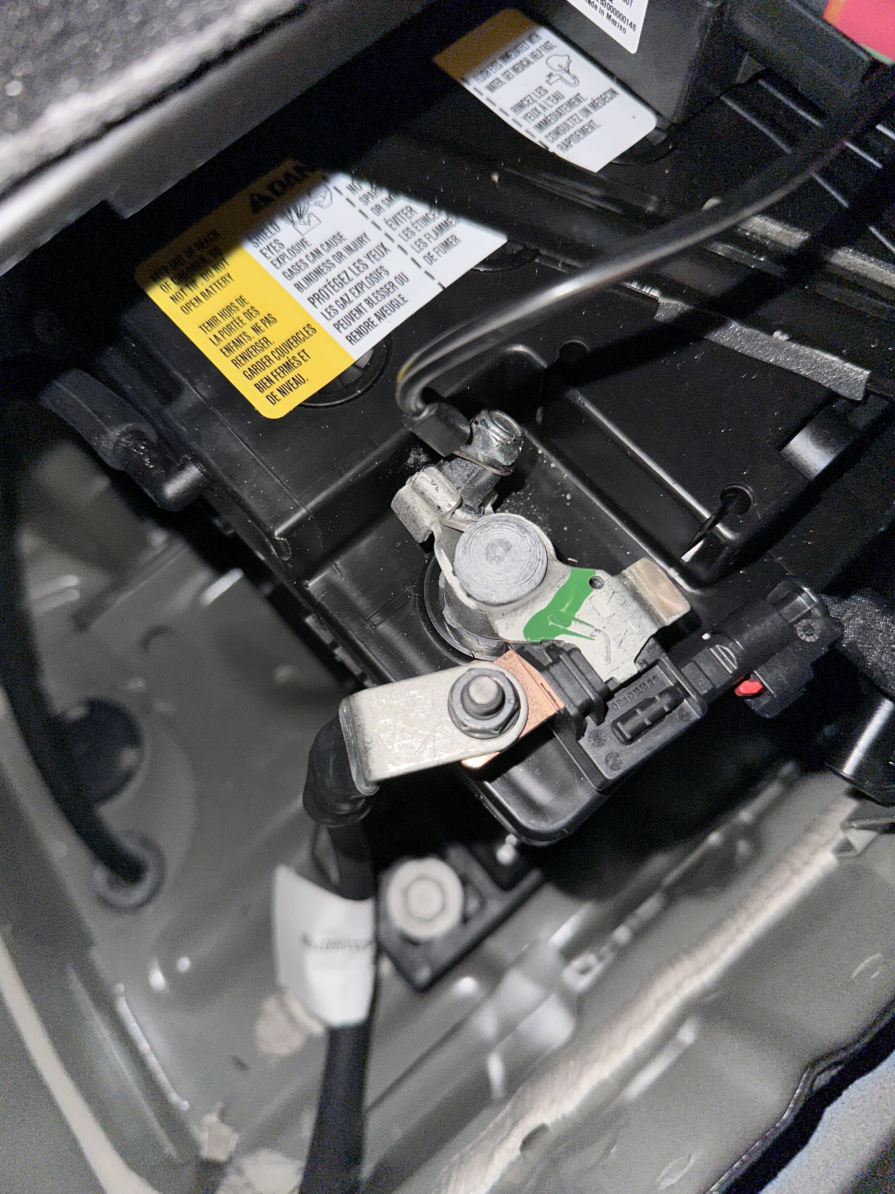

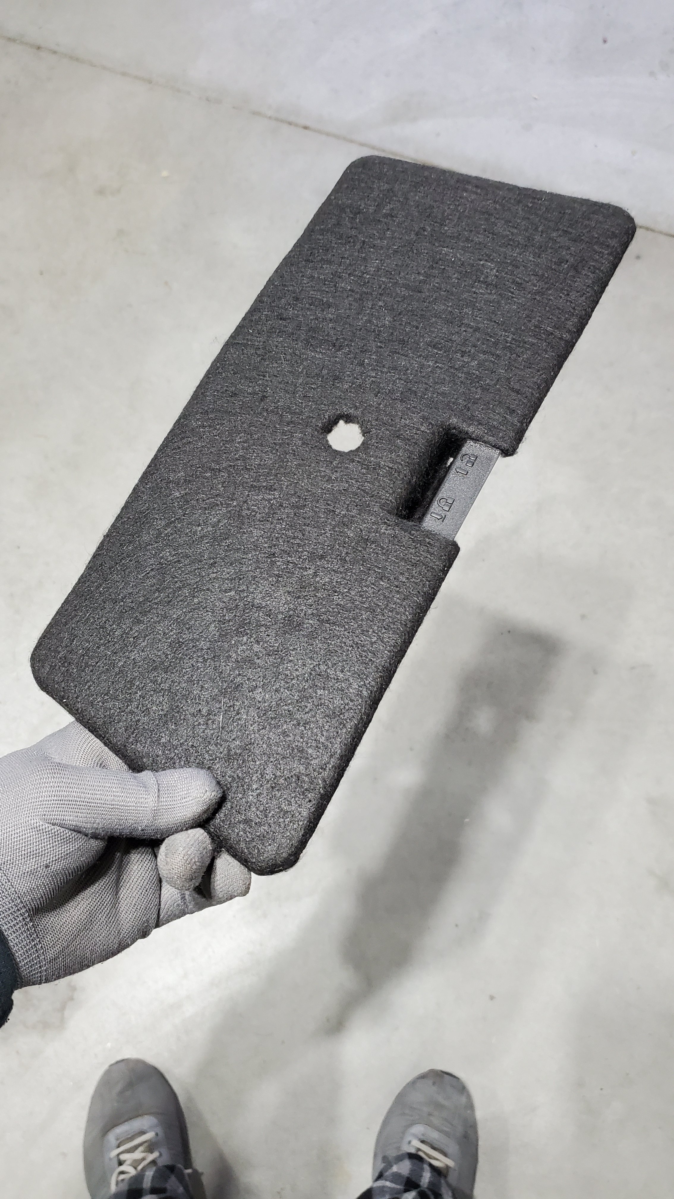

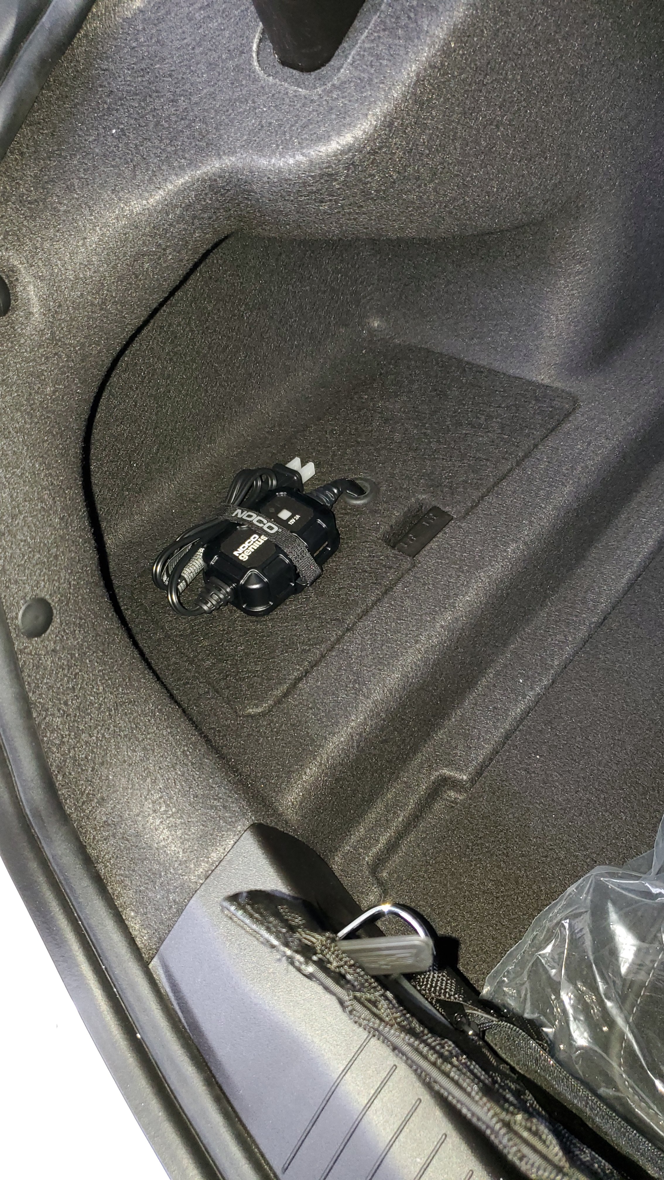

First time not using the OEM charger, and my NOCO 2D is doing just fine. Mounted it to the battery cover after I wrapped it in felt. Snipped the EYELETS to slip between the battery terminal bolts. Permanently mounted and easily accessible now.

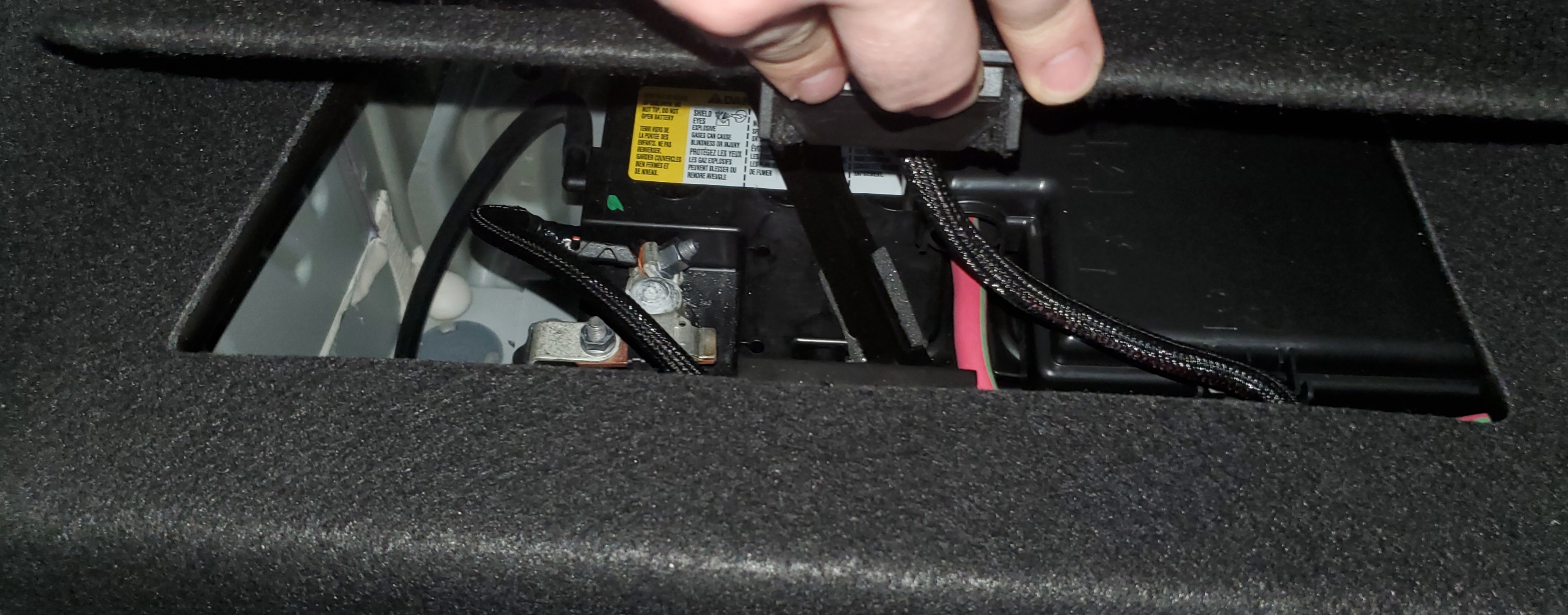

got my battery tender hooked up. Took a bit of wrangling the trunk liner and battery top lid inside the liner (toughest part of job). I put my battery tender wires onto the bolt on the vise that connects to the battery. Figured out it was a M6 but. Got a nylon stainless nut and bolted onto the remaining thread of the bolt on the vise.
