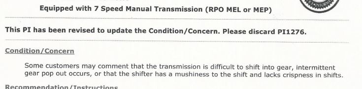

I remember when the C7 was released quite a few people had to take theirs in for a shifter adjustment / alignment. Hopefully it's something similar in your case, see below for reference:
That's what it feels like to me. I did go to the dealer Sunday, but they didn't have either the 4 or 5 on the lot they had listed on their website.:rolleyes: I don't think it's the clutch--the revs fall(or match if its on) appropriately when the clutch is depressed. I'm betting on shifter alignment, but we'll see. I don't really have time to mess with it now so I'll probably wait until spring to take it in and see if I can still find another one to try in the meantime(anybody live near Cincy?) Right now I'm trying to figure out the winter wheel/tire situation...
From that C7 TSB-- that describes my car to a T. Hope that's all it is...
