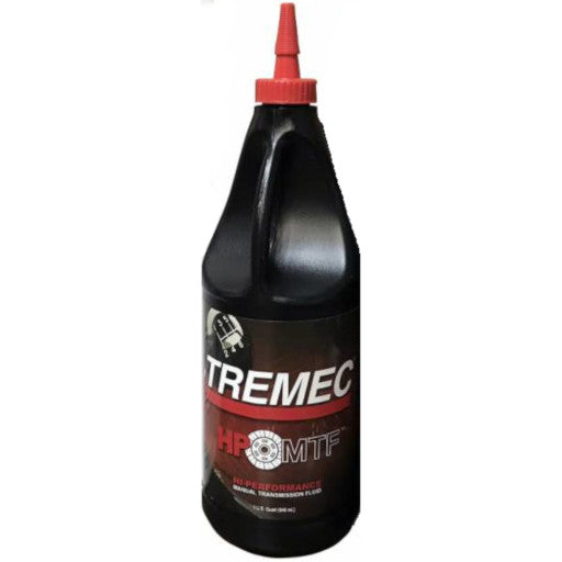

My '22 4v BW is the 10sp auto / my '15 Chevy SS had the 6sp MT = when it was new, I read changing the gear lube would help... I did that AND it surely did help. You may ask Cadillac to exchange the trans gear lube and go from there.
I thought this was an interesting read. https://www.tremec.com/not_am_detalle/mp-mtf-transmission-fluid/
My takeaway is Tremec's public stance is "use the OEM fluid...buuuutt, the Tremec HP-MTF is pretty dang good stuff because the same folks that designed the transmission are the same ones that detailed the fluid specifications."
I have swapped to the HP-MTF in every -6060 car I have owned. It's what TREMEC says to use if you buy the 'Magnum' (retail name for the TR-6060).
The GM fluid is a cost saving measure. The HP-MTF behaves like a MT fluid should. You fill the case up with no requirement to do the 1/8" drain procedure.
Have you noticed any changes in shift quality? I swapped to Valvoline Dextron III because Tremec told me to use Dextron III and the Cadillac owners manual also said Dextron III. I have seen the HP-MTF article before but have been afraid to switch to it for fear of voiding my warranty.

I live in Florida, so not really any ‘cold weather’ shifts.
I did notice consistent shift feel during street and track use.
Blackstone reports come back stellar.
If you are considering the switch, keep in mind you can’t get all the transmission fluid out at once. You have the fluid in the cooler lines and the cooler itself. I switched fluid, ran a weekend, switched again. That got most of it.
