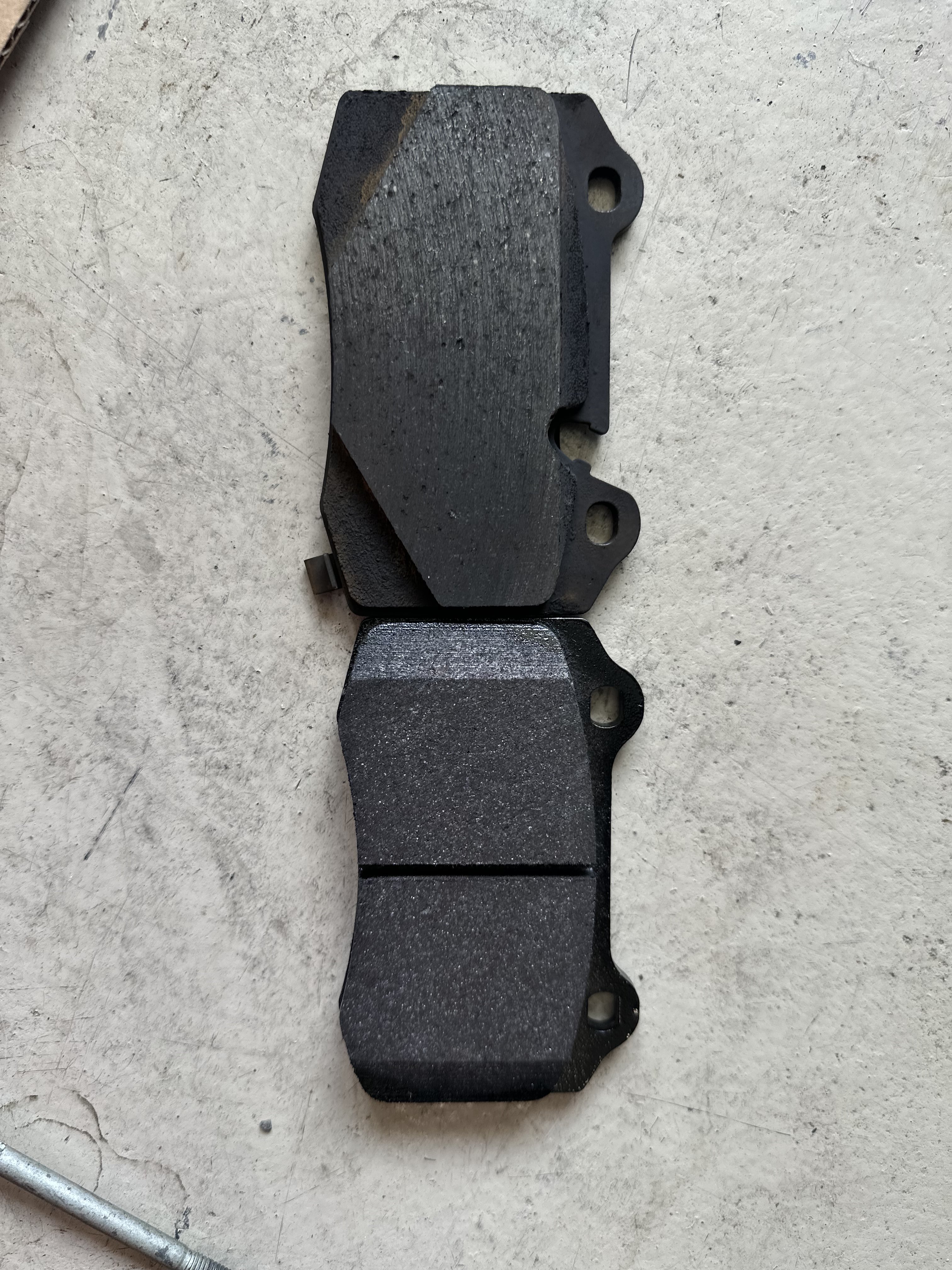

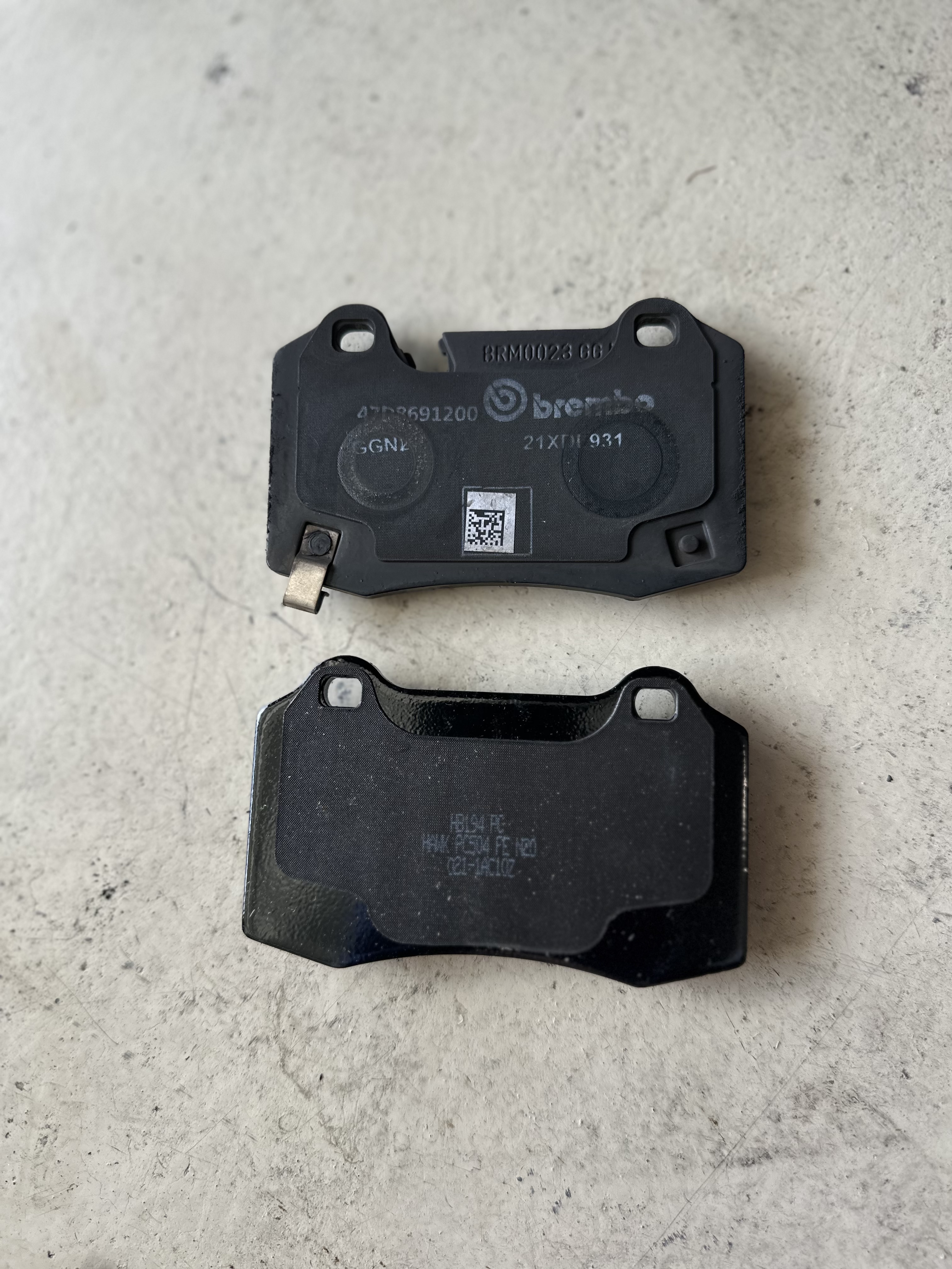

Well, talked to Ken this week and had him send me a set of Hawk Pads. Fronts have the slot for the wear sensor on the front driver side but the rears doesn’t have them for the rear passenger side. Also they don’t have the wear indicator finger on any of the pads.
I used non oem pads without the sensor opening and just zip tied the sensor out of the way on the brake line. It looks like you can use the sensors up front but not in back and as the front brakes work a lot harder than the rear I wouldn't worry about no sensor on the rear. In fact if you keep up with your own maintenance I wouldn't worry about no sensors or no tab either.
