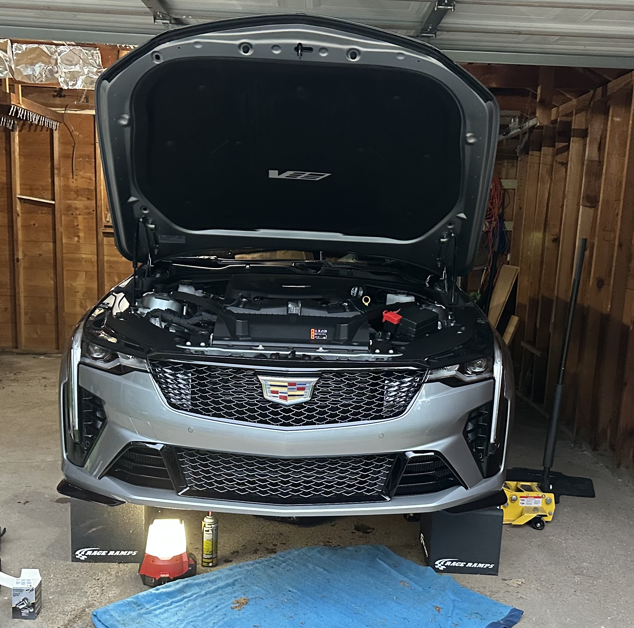

I just did the break in oil and differential change today. I used two jacks and these from Jackpoint Jackstands. Not shilling for them, but have used them for years and have bought different block pads for different brands. These worked perfect in the pinch welds and as far as I can tell I didn’t bend anything or damage the rockers.
I use the whole setup when changing wheels for the season or track event etc. But, they are too low for doing work under the car so I use the pinch weld block pads to get the car onto Race Ramp wheel cribs when I need more clearance to do oil/diff changes etc.
Again, not shilling for anybody, just showing what has worked for me over the years with difficult to lift cars like we have. FWIW, I have a CT4-V BW. This is the only crappy pic I took, but you get the idea I’m guessing.

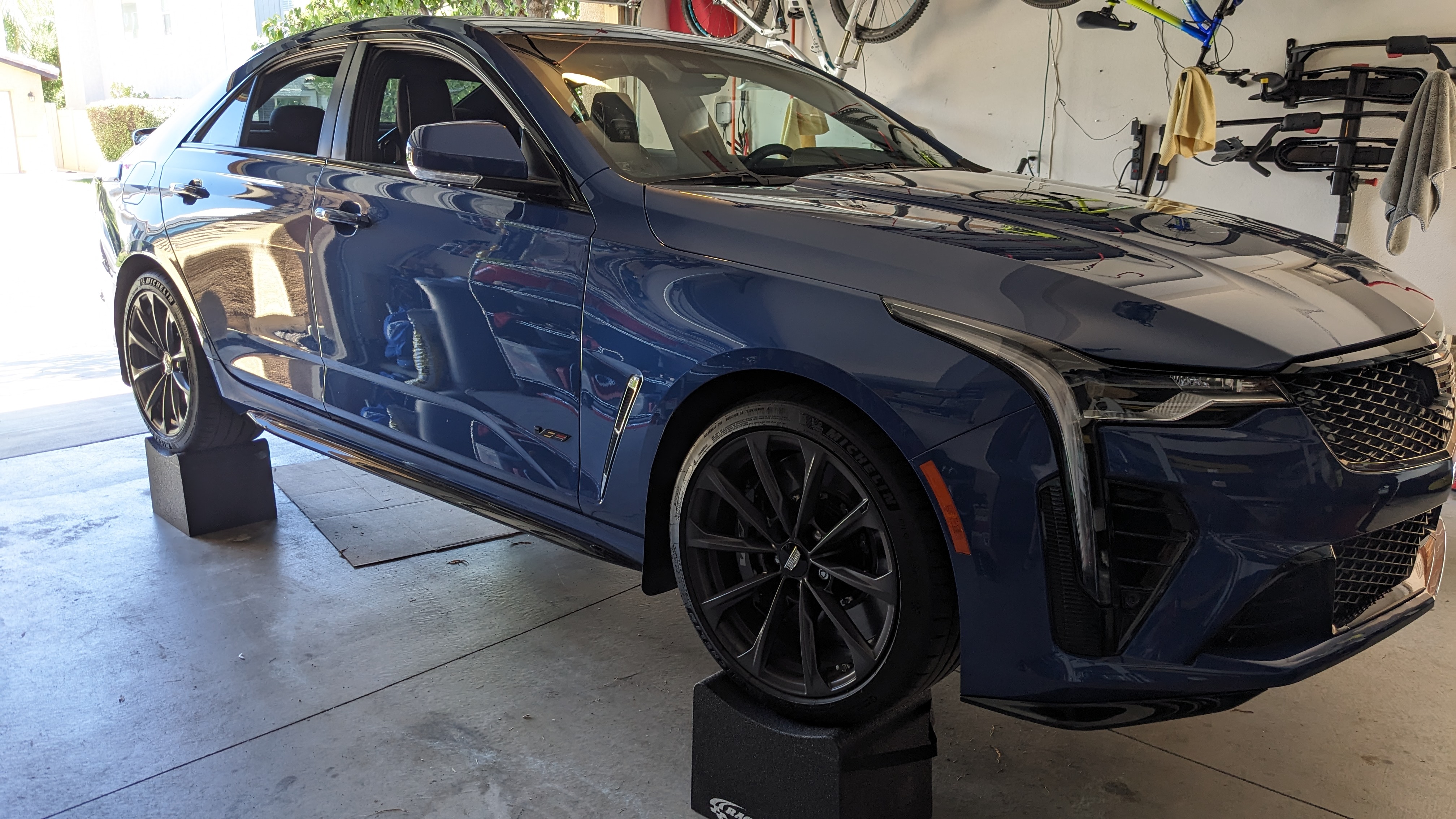

Here's another pic. First time using them. Not gonna lie, It was kinda scary jacking the car up that high even though I got the 2 piece which makes it easier.

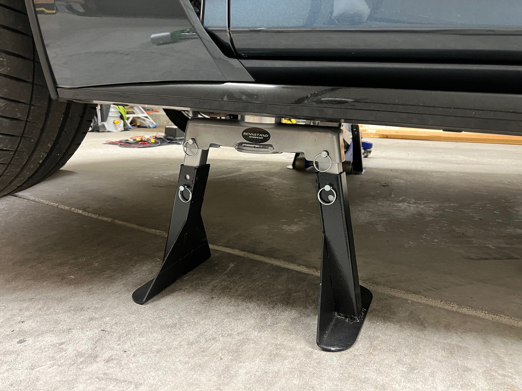

Yesterday I got to use my new RennStands to change my oil. Jacked up on the ZL1 Addons Stealth lift pads. I have two Arcan low profile aluminum floor jacks and they just barely fit between the jack stand legs (but they do fit). Very happy with how they worked out for the 5BW.
So, you didn't use whatever pad you got with the Rennstands to jack it up? Got a closer pic of the pad at the pinch weld?
