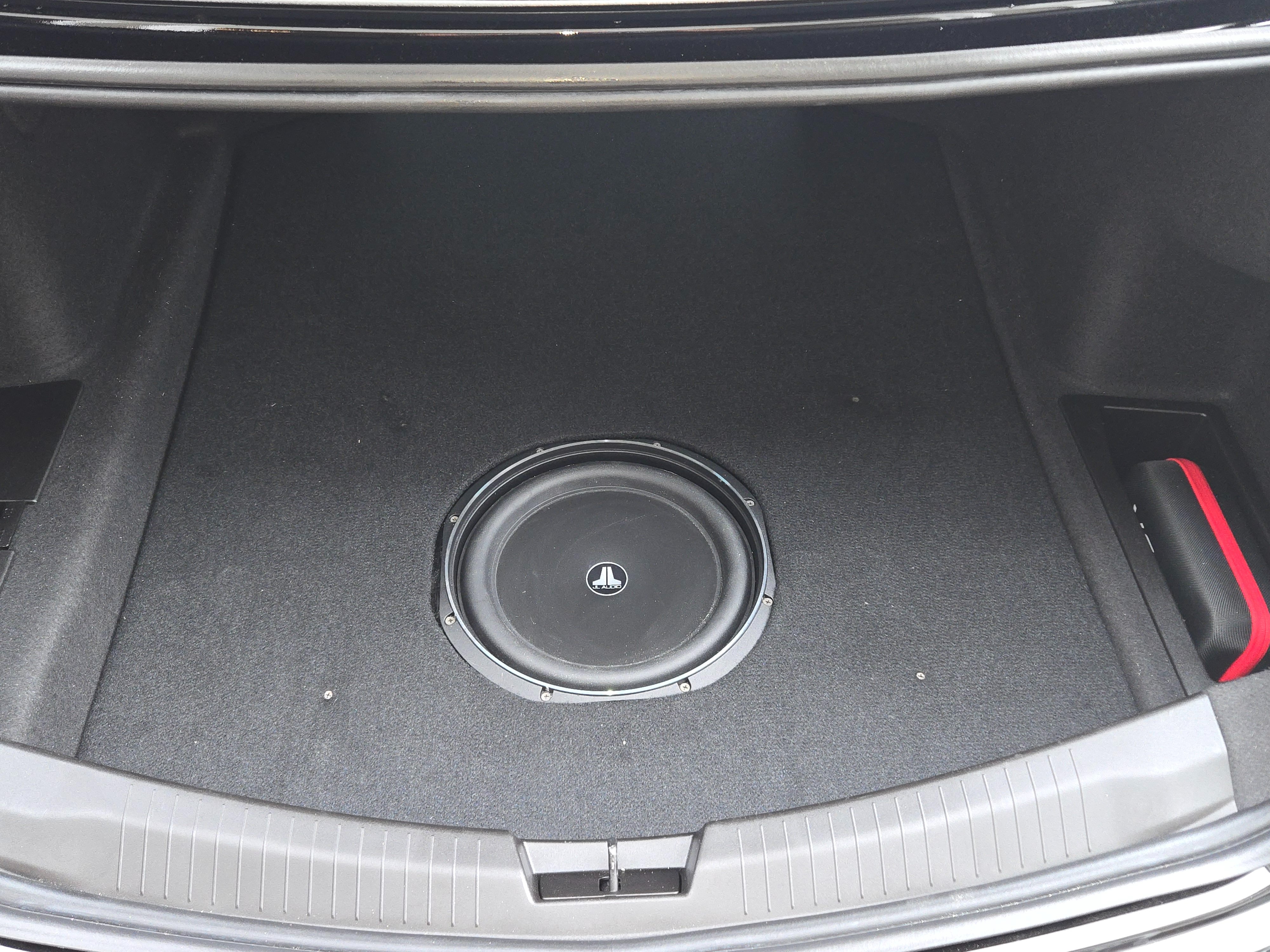

Reviving a long dead thread here to see if anyone can disable this nonsense. I see we've been mic hunting, fuse pulling and wire diving. I just fiberglassed a 12" shallow sub in the tire well and picked up the inputs off the rear deck lid speakers and now all of a sudden all I hear is the drone of fake exhaust noise from the sub. It's fine if I have any music on, but if I were in the car having a conversation, not ideal. Have to figure this out.
(also, in the pic, this is pre-vacuum and pre-hide the cover panel screws), looks factory fit now.

I don't have an answer for you, but could you do a quick write-up on how you did the installation?
