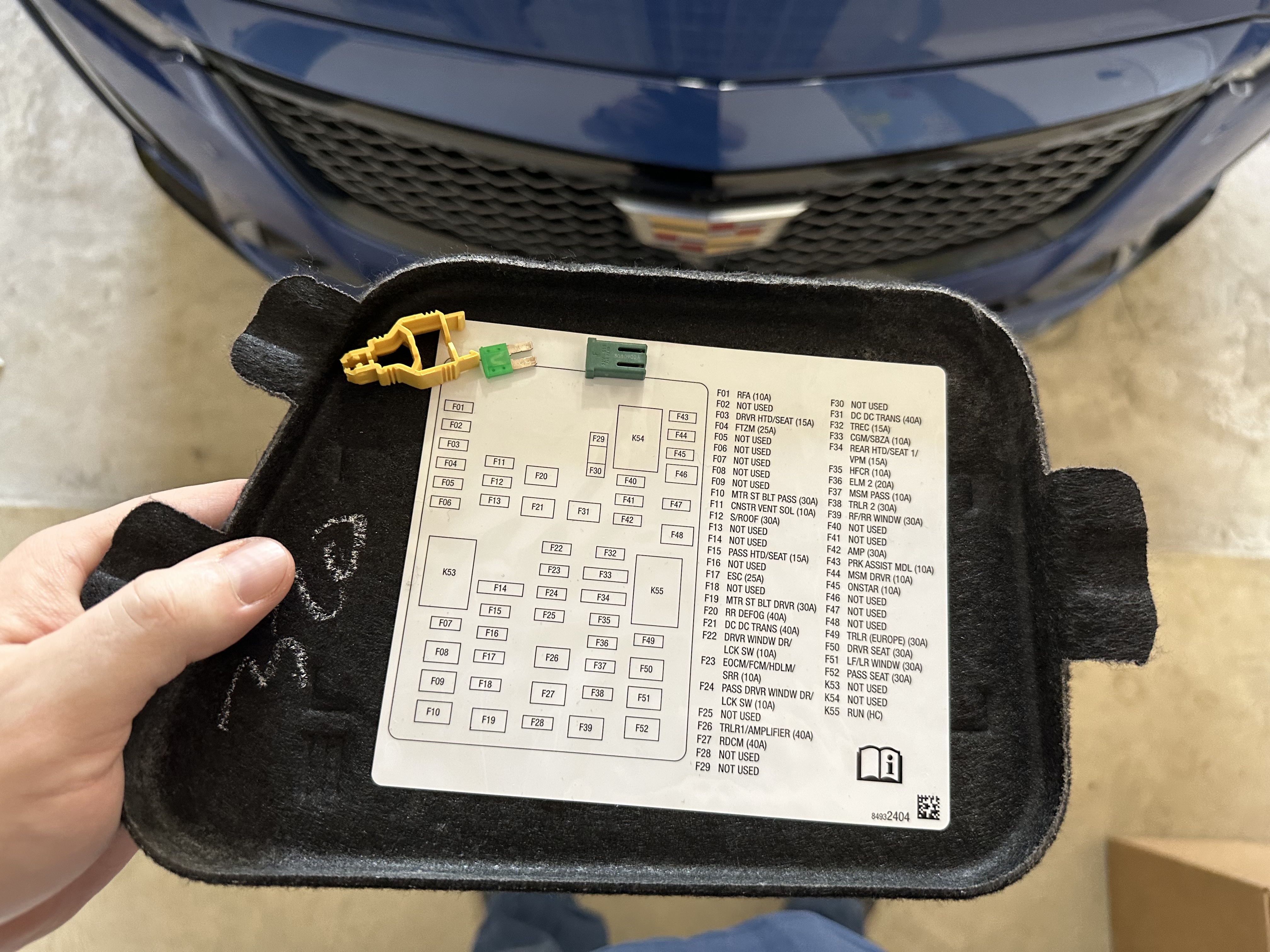

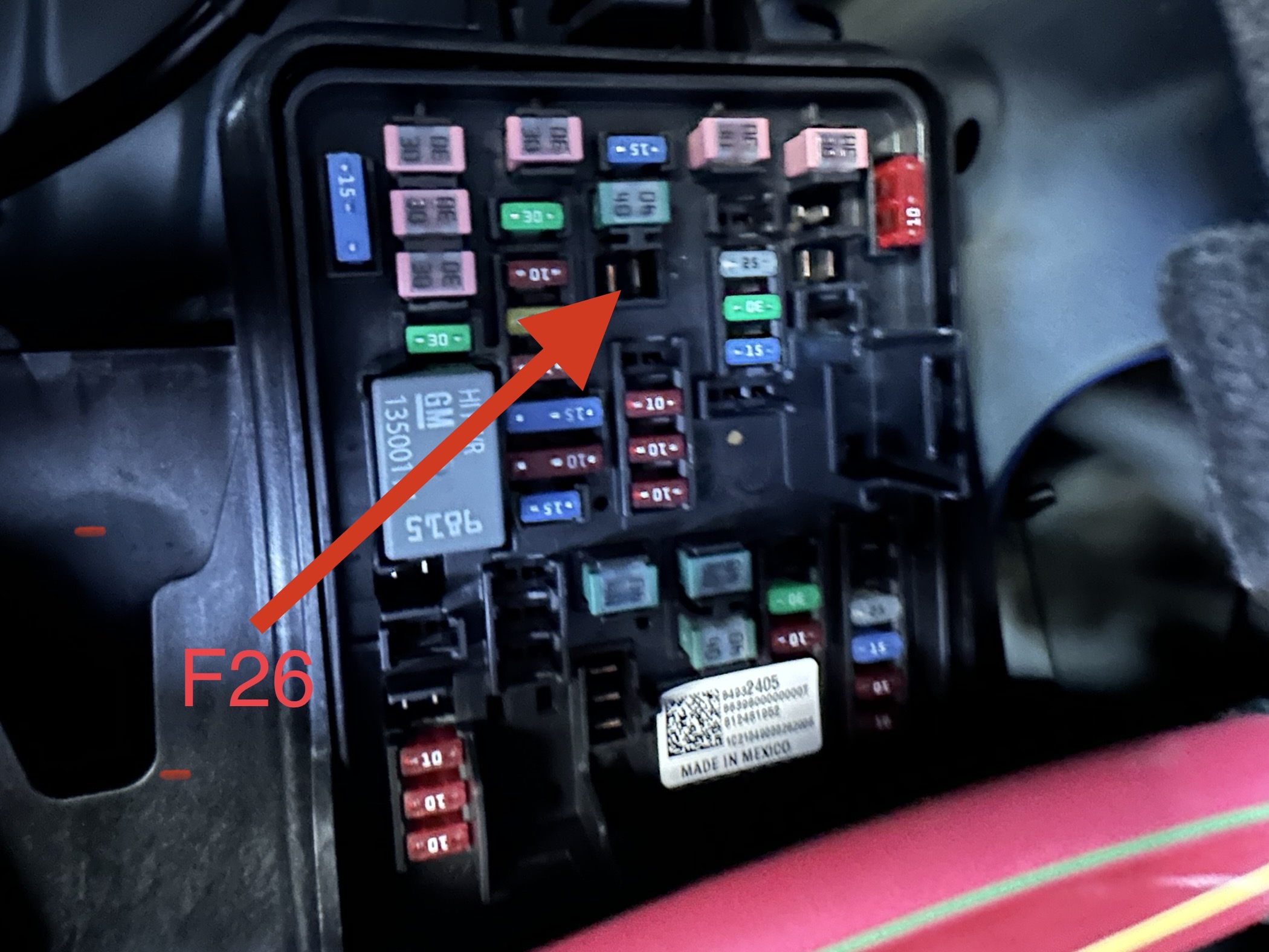

OK, I did some testing, found the fuse, and did a test drive. TL;DR: the piped in audio makes a TON of difference. In fact, all the weird, higher-pitched-than-it-should-be sound we hear at WOT is piped in through the speakers. WOT sounds a lot more natural (and, sadly, quieter in the cabin) with the F26 amp fuse pulled.
@Mirza Grebovic *please* see if you can get them to let us turn this crap off with an OTA update.

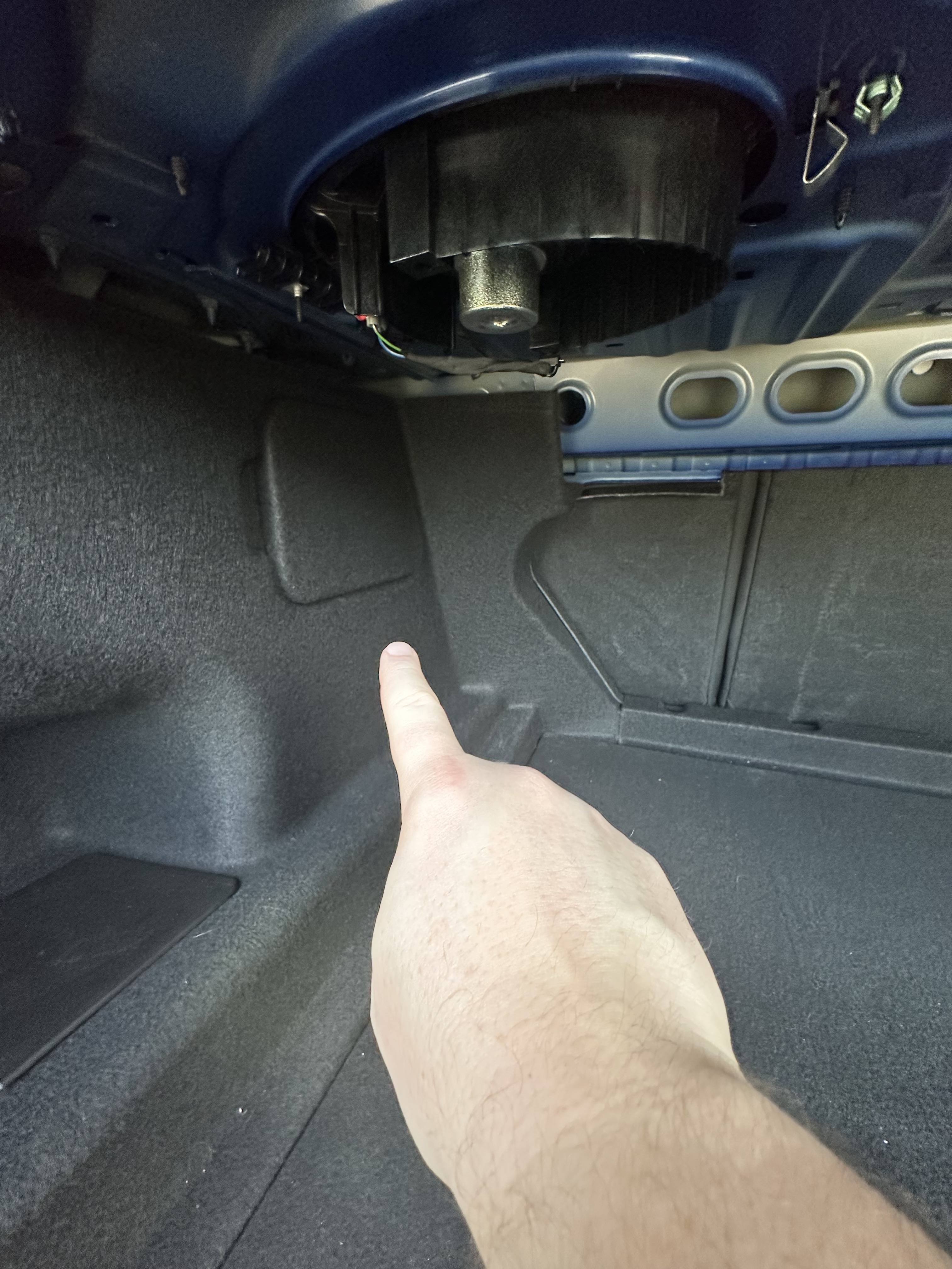

Detail, if you want to replicate this for yourselves:
1) open your hood and get the fuse puller from the underhood fusebox
2) open your trunk and access the trunk fusebox:
2) Use that fuse puller to pull 40A fuse F26, which is near the top (the diagram on the back of the cover is upside down):
* note, as you can see above I initially did both F26 and F42 as they were both labeled AMP. You can ignore F42; I'm not sure what it does but pulling it doesn't block the piped-in engine noise.
3) Go for a drive and hear for the first time what your Blackwing really sounds like at WOT.
[edit] 4) put the fuse back in because there's no radio/audio at all with the fuse pulled.
Cheers

Amazing, thank you for this. Did this simply disable the piped in sound or did it also disable the audio system?
2) open your trunk and access the trunk fusebox:View attachment 17041
Cheers
Wow. A 40A fuse just for engine noise? Did it disable the whole sound system?
For clarity, F26 is the main fuse for audio. Pull the fuse and you lose all audio. It’s not a permanent solution, but it’s a way to temporarily turn off the fake engine noise if you’re curious what the car really sounds like.
Then put the fuse back in to get your stereo back.
Anyone else tried pulling F26 yet? Curious to hear what others think of the car’s true sound. I’ll say it again, pulling that fuse does away with the weird strange-pitch blenderesque sound these cars (and ZL1s) make at WOT inside the cabin… With the fuse pulled, it’s quieter at WOT, but finally sounds “real.”
Wish we could turn this crap off via a menu and still have the stereo work. My car is fake loud inside again.
