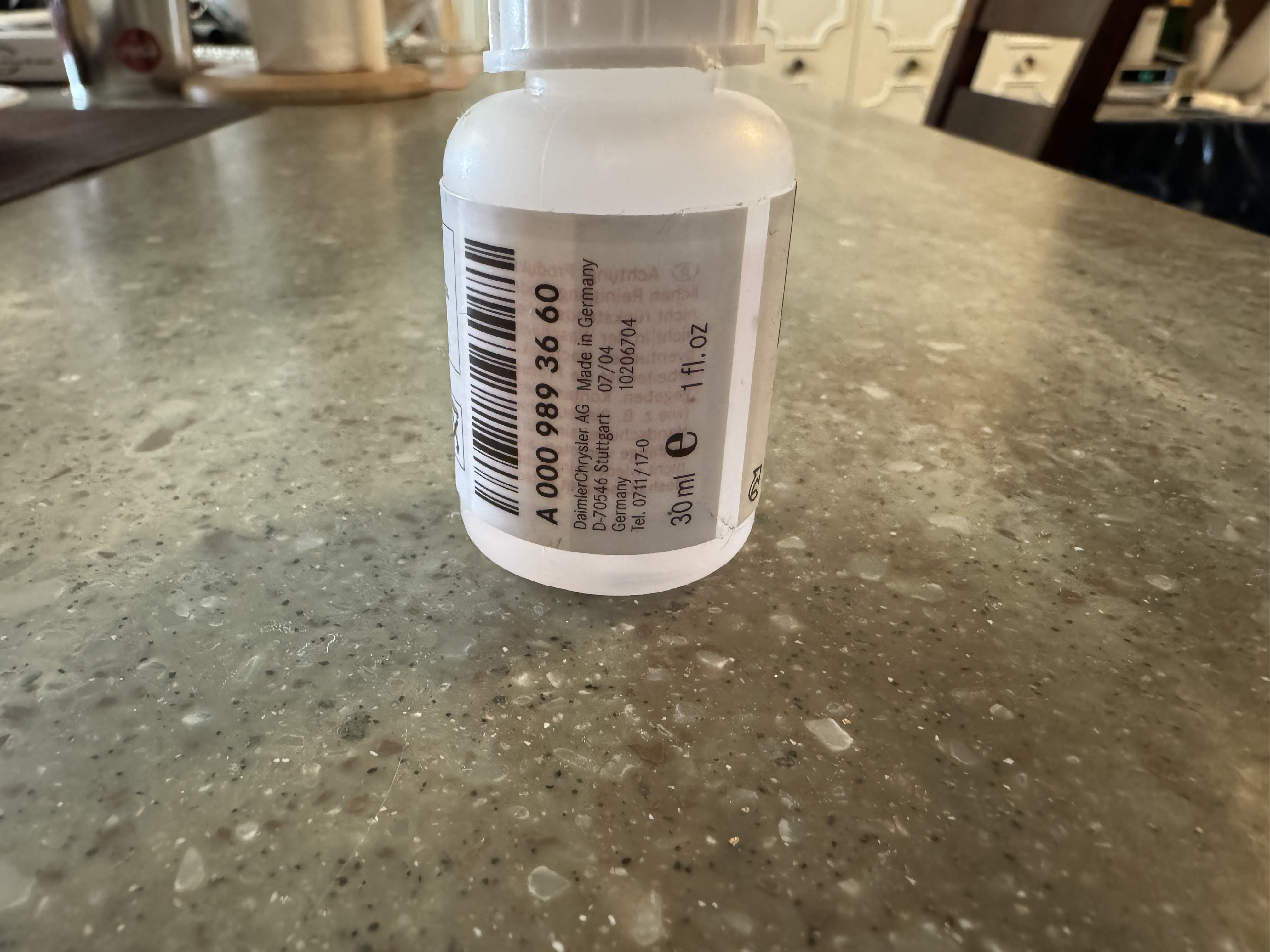

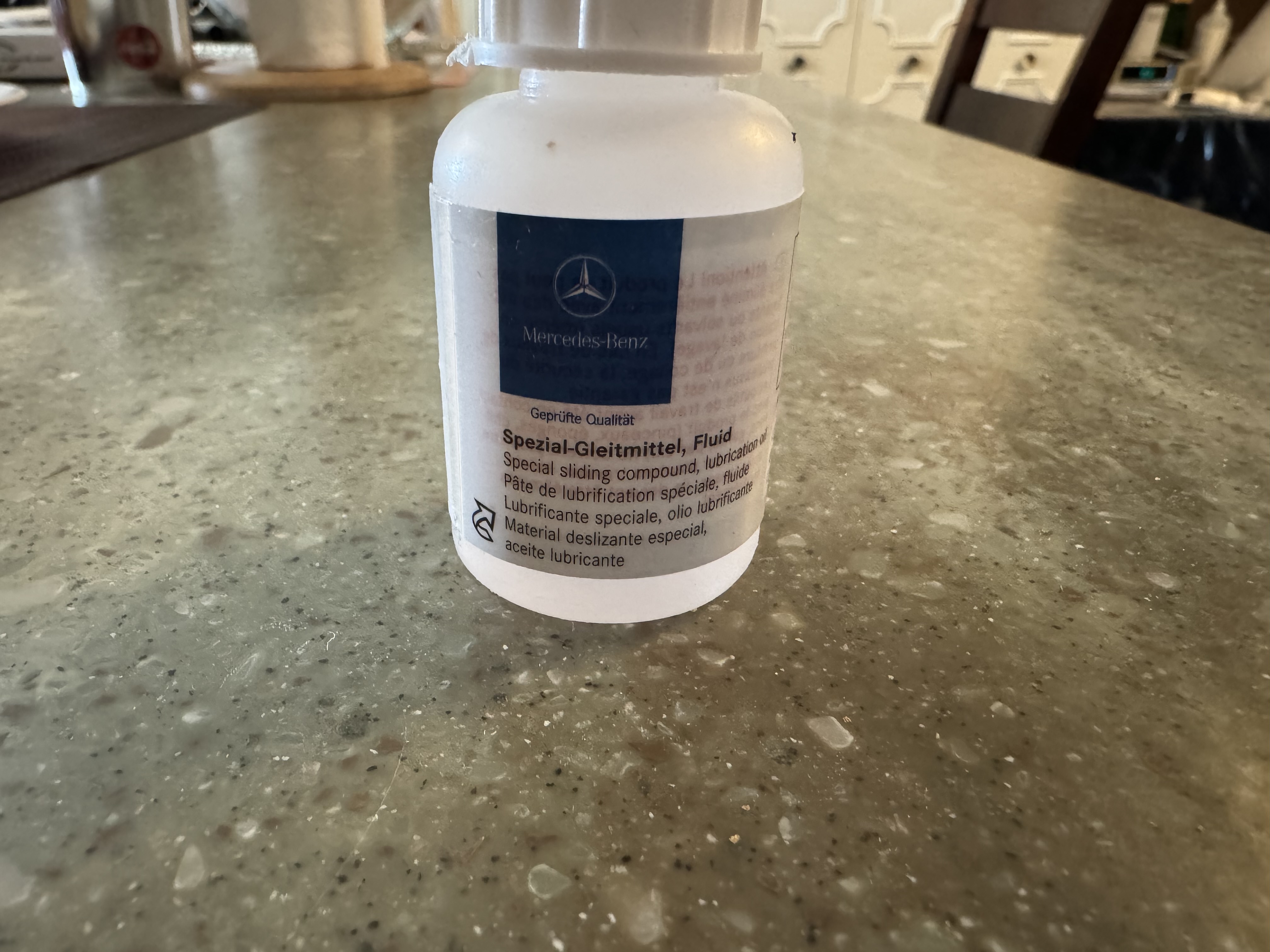

Try this for that Sunroof Squeak.
It’s helped me before, on squeaky seals.
Dealer gave me the bottle, after they applied it to my door seals.
