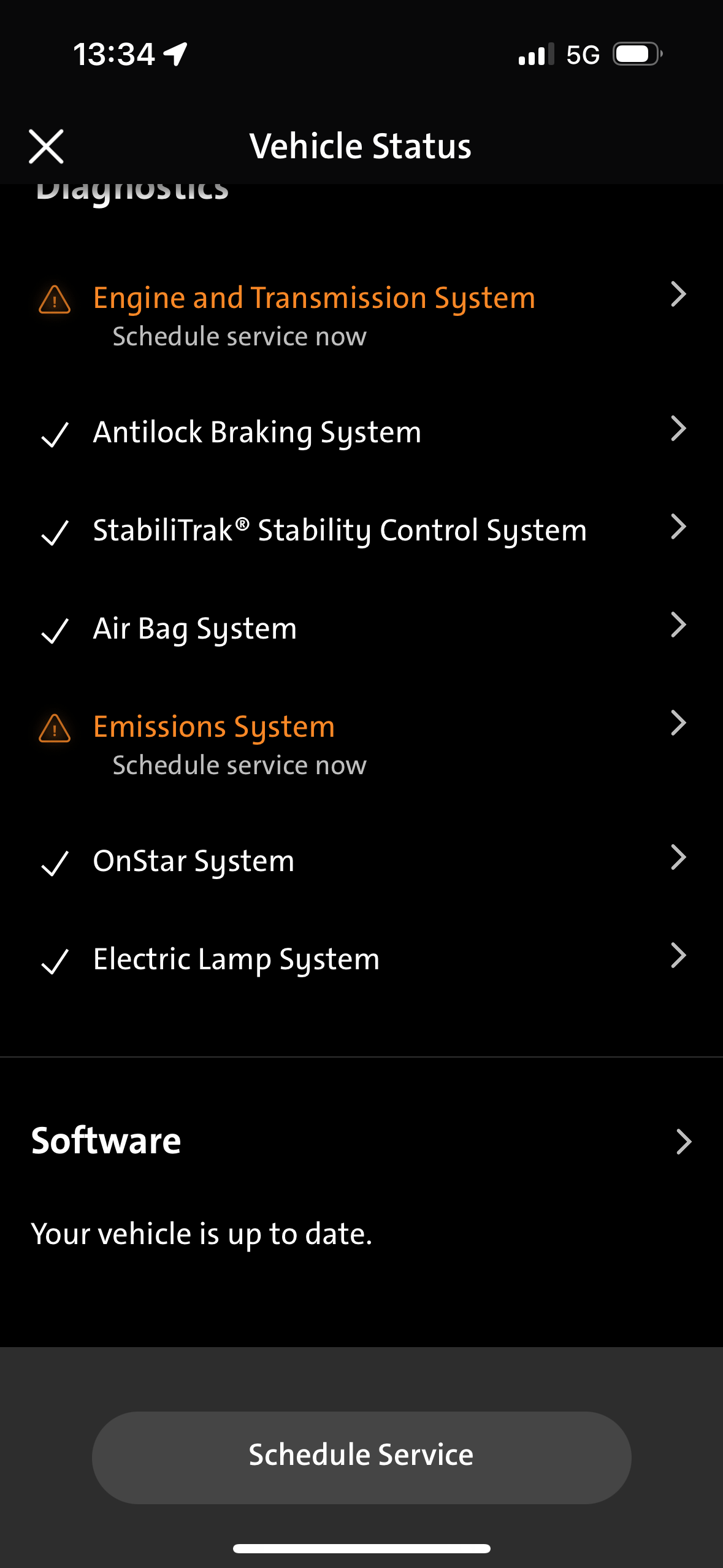

I tried searching on the forum but found no prior threads. Just installed a Corsa Xtreme Exhaust on my 2024 5BW and man, it sounds AMAZING. However, shortly after (next day), the MyCadillac app threw two eerie messages, 1 for VVT and the other for ECU. Has anyone had issues with this? If so, what is causing it and what is the solution?
I attached images of what is going on.
Your input is greatly appreciated!

Thank you all for your input. I am only getting a check engine light and the aforementioned app alerts. Is it possible that it is a sensor disconnect? I am a first time Cadillac owner so any input would be greatly appreciated. I have a service scheduled this Friday so I will try and get my exhaust installer (highly reputable, probably the best in RI) to look at it closely tomorrow.

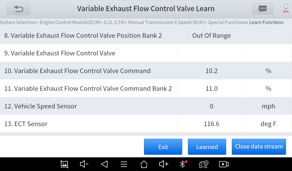

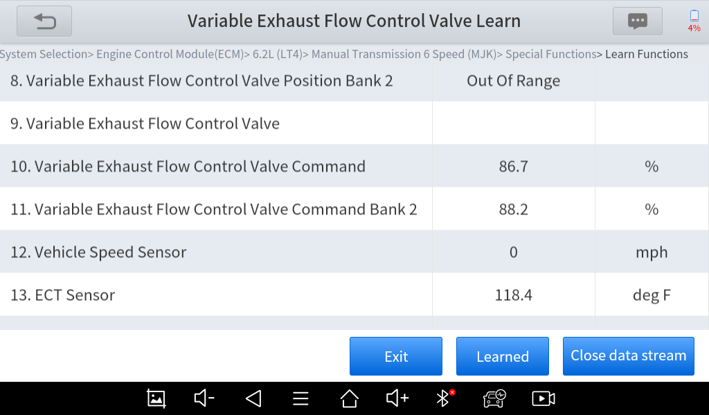

The relearn process will trigger the valve actuator to full open and fully close, those voltage values will be registered into the vehicles ECM as %. From there, the car will know what % the valve should be at for different drive modes. Here are some screenshots from when I did this troubleshooting for another forum user.
Tour Mode, valve reads about 88% closed.
V-Mode, or for me, My Mode, shows about 11% closed (or "fully" open):
Without these values being properly registered into the ECM, the flow readings will not correlate correctly and will throw a code sensing an issue with the outflow. You will also notice that even in Tour mode, the valves will automatically open when you hit certain RPMs in different gears to allow for the correct amount of exhaust outflow to prevent bogging down the engine, this is all based on having a correct valve value baseline.
