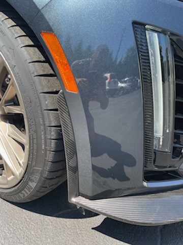

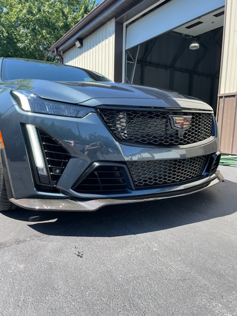

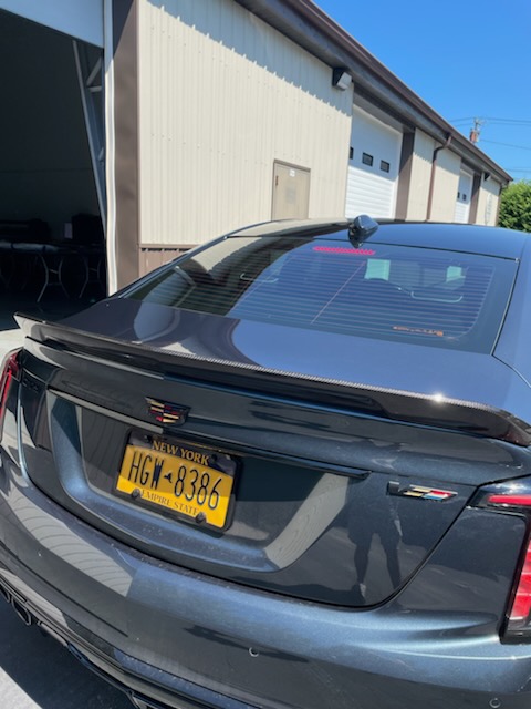

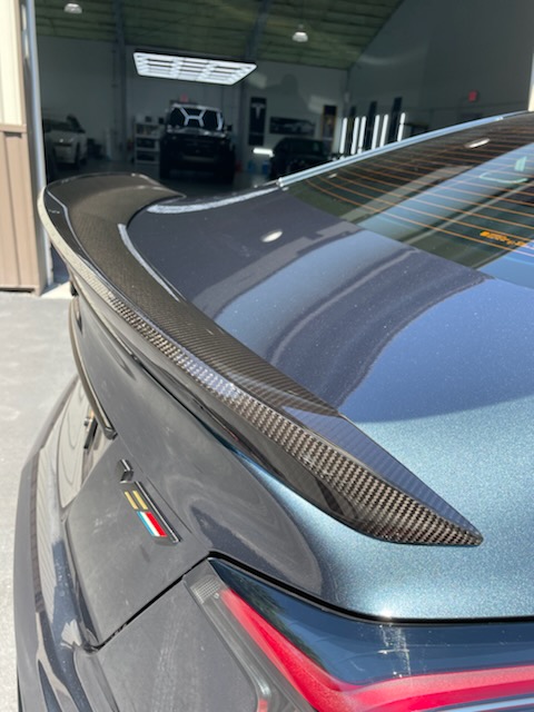

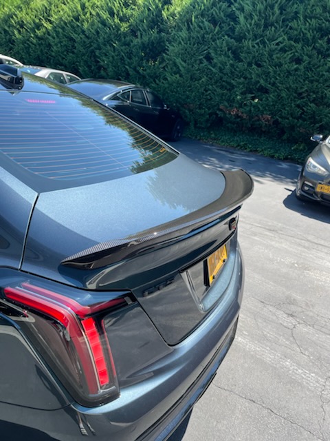

CF splitter and wing installed...
Thanks. Bummer. Think I’ll just stick to adding the rear wing and leave the front alone.
If you are talking about a CT5V BW then it's a straight replacement of the standard splitter...see my pics above. The wheel deflectors use the wheel well liner fasteners...unless I am missing something

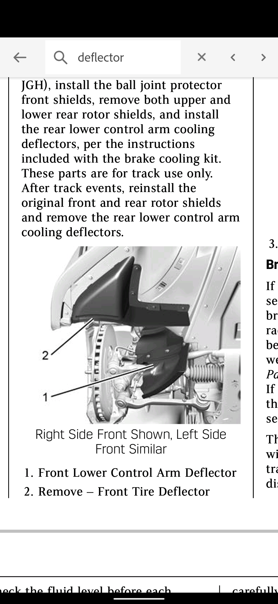

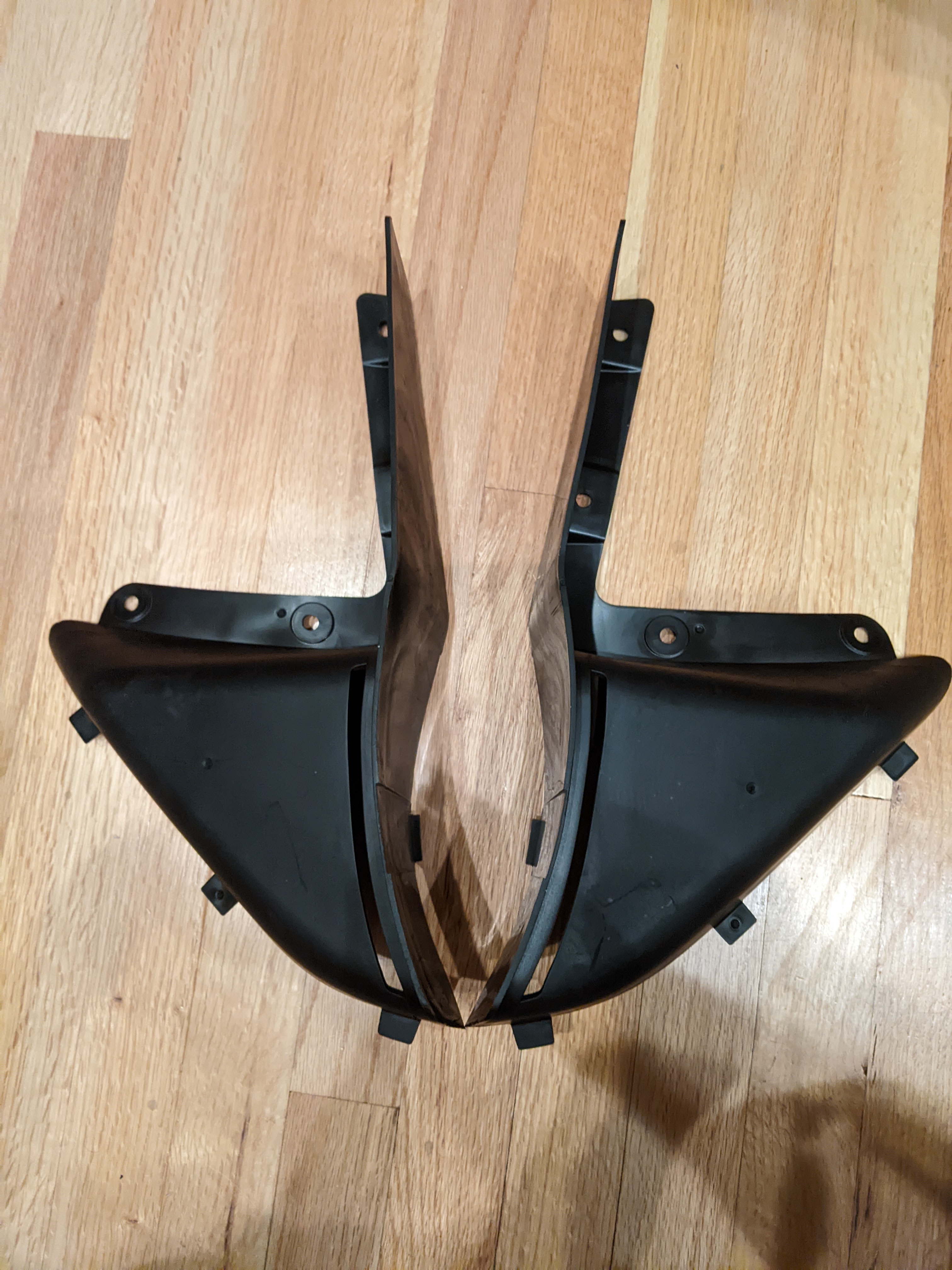

Only thing I am not sure about is whether these pieces are needed with the CF splitter...Can people with 5V BW carbon splitter look underneath and check if those rubber front tire deflector pieces are different? It's #2 in the image. Thanks!

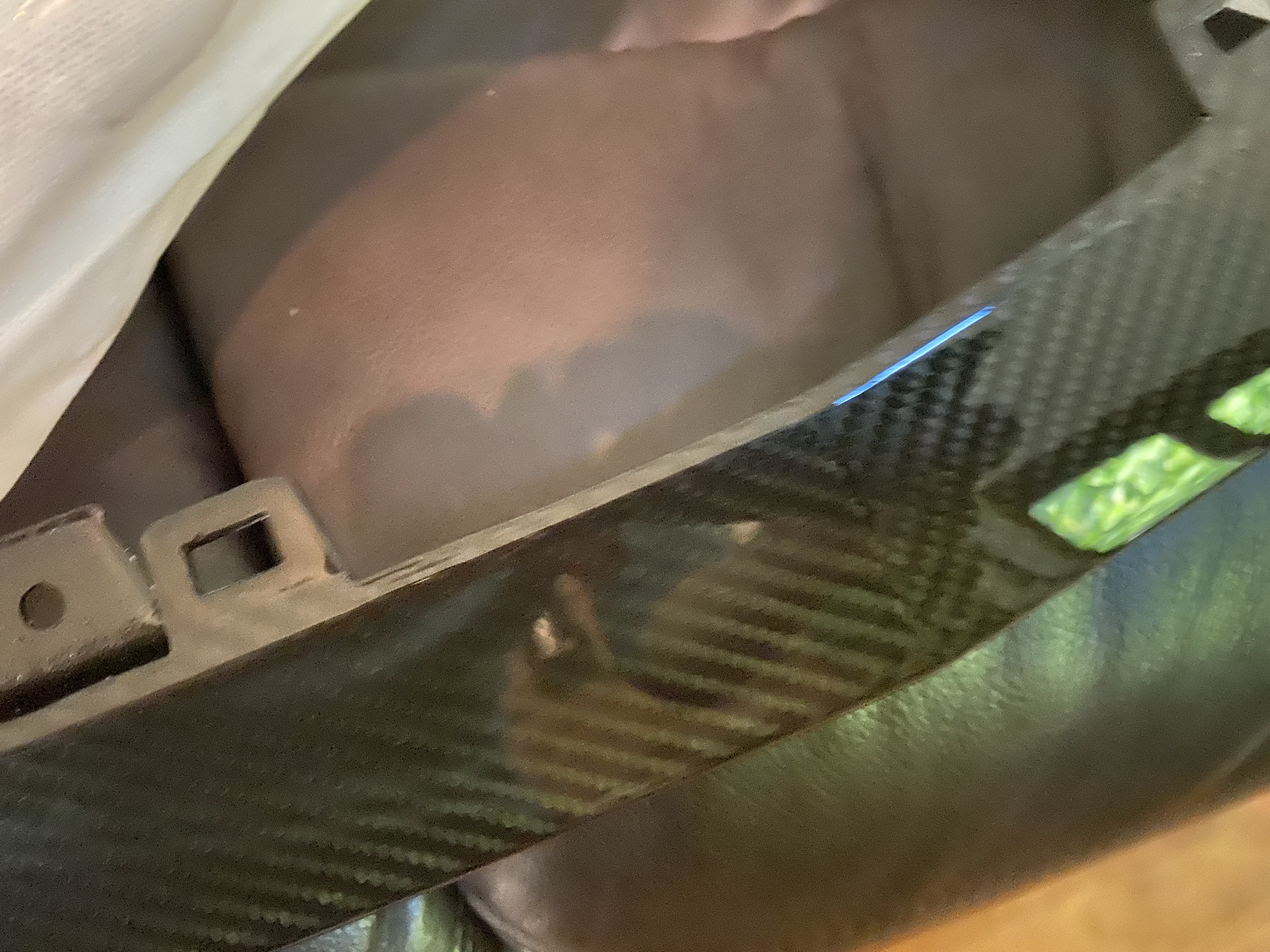

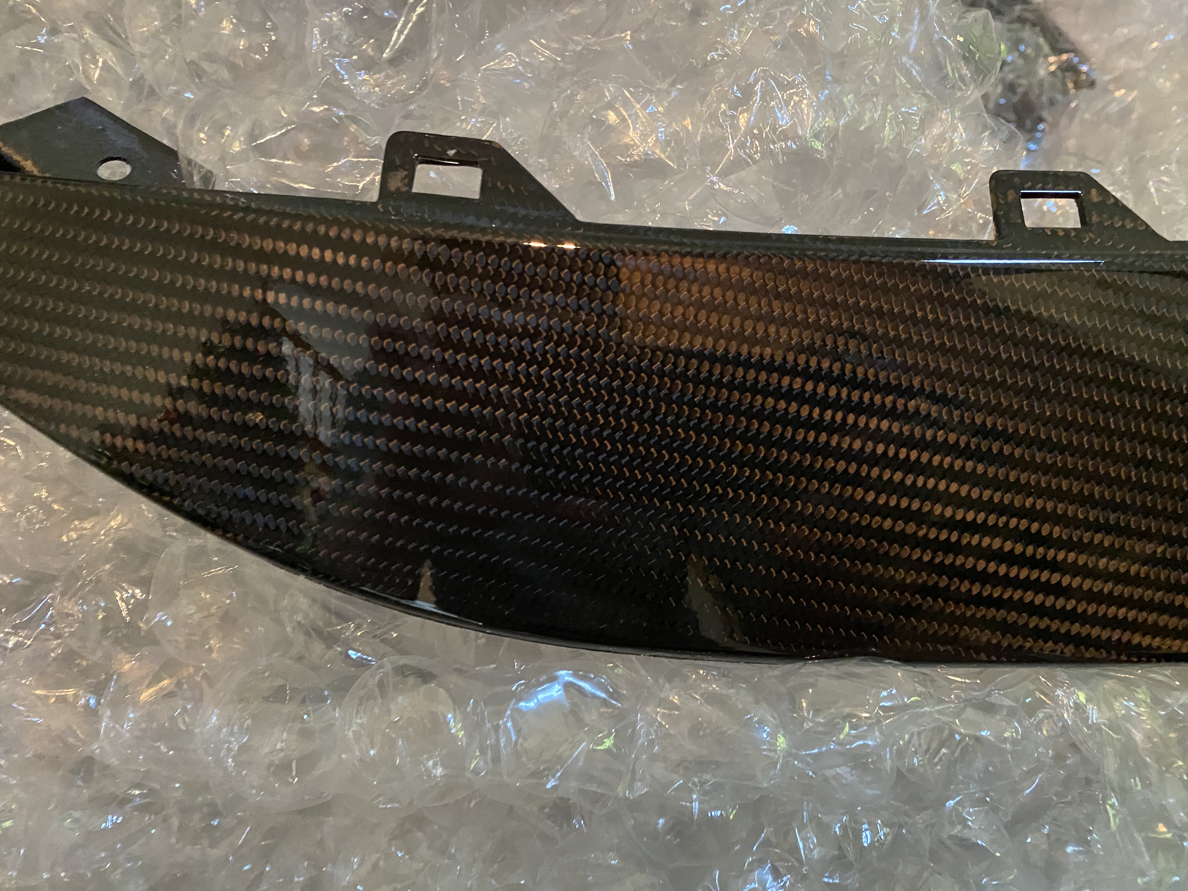

Anyone install CF side skirts yet? I got the CF side skirts but they come with rocker boards that need to be painted.
