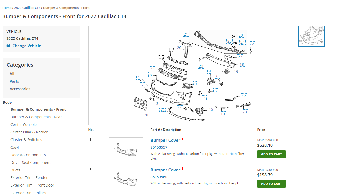

Are you just going with the splitter and not messing with the deflectors (dive planes)? I know they say the deflectors need a support for them in the front bumper cover, so on the gmpartswarehouse page I saw this crazy thing:
Bumper & Components - Front for 2022 Cadillac CT4 | GM Parts Warehouse
www.gmpartswarehouse.com
So the standard (non-CF) bumper cover is $628.10, but the one with support bracket for CF is only $198.79? If that's true, I might get one just in case I decide to go with a CF1 upgrade to my 4BW. There is the extra cost of...
