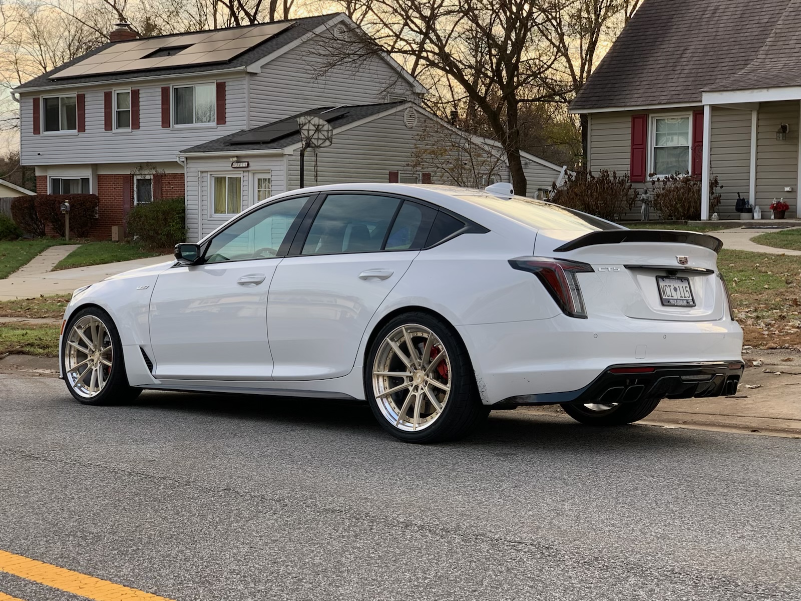

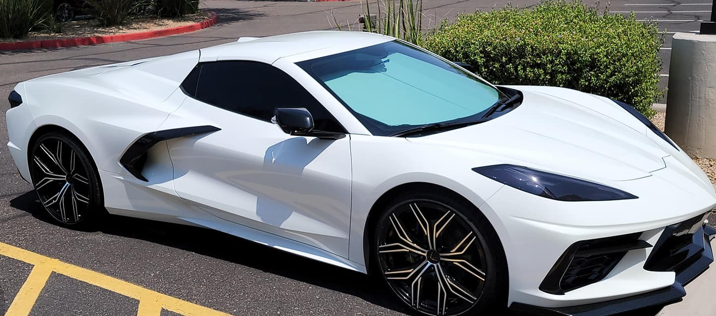

Went with Mantis with machined face and black behind the face. Here it is on a C8. My BW is rift metallic so basically off white. Not many pics of Blackwings with any aftermarket wheels.
Nice! What are they charging out of curiosity? The wheels from tire rack were $500 each.
These were about 800 each. That was all in including a high dollar finish option. The tire rack ones just didn't do it for me. I'm coming from a C8 so was familiar with the Aerolarri designs.

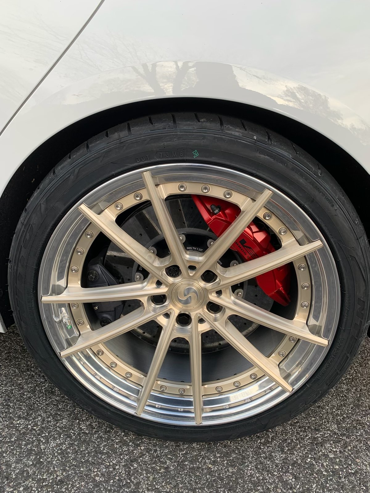

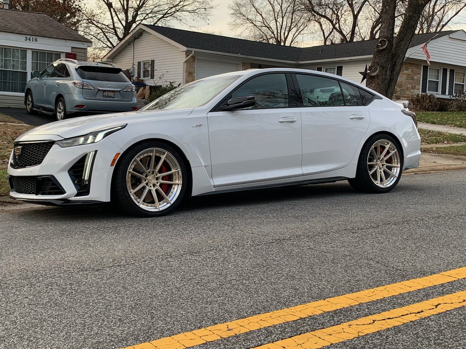

Signature wheels 20inch. Running 305/30 in the rear and 285/30 in the front. Terrance did all the custom offsets. The fit is simply remarkable.
whats the damage for those SV310?

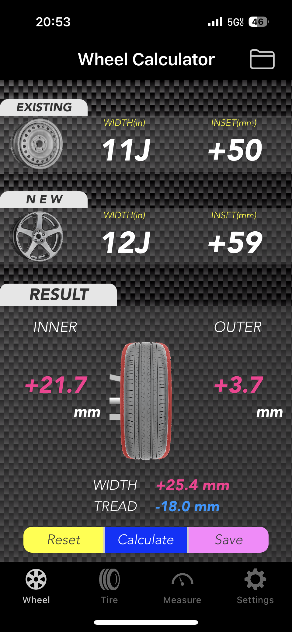

They should fit. I’m trying to see if any of my vette friends got any stock c6 or 7 z06 wheels to test fit the rear. Inside clearance to the strut is pretty large (atleast 30mm), will be 21mm closer on the inside and minimal change on the poke.

They should fit. I’m trying to see if any of my vette friends got any stock c6 or 7 z06 wheels to test fit the rear. Inside clearance to the strut is pretty large (atleast 30mm), will be 21mm closer on the inside and minimal change on the poke. View attachment 15600
