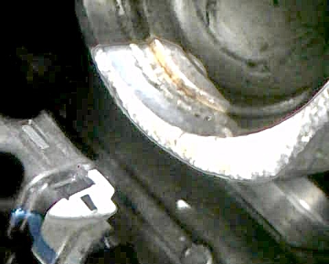

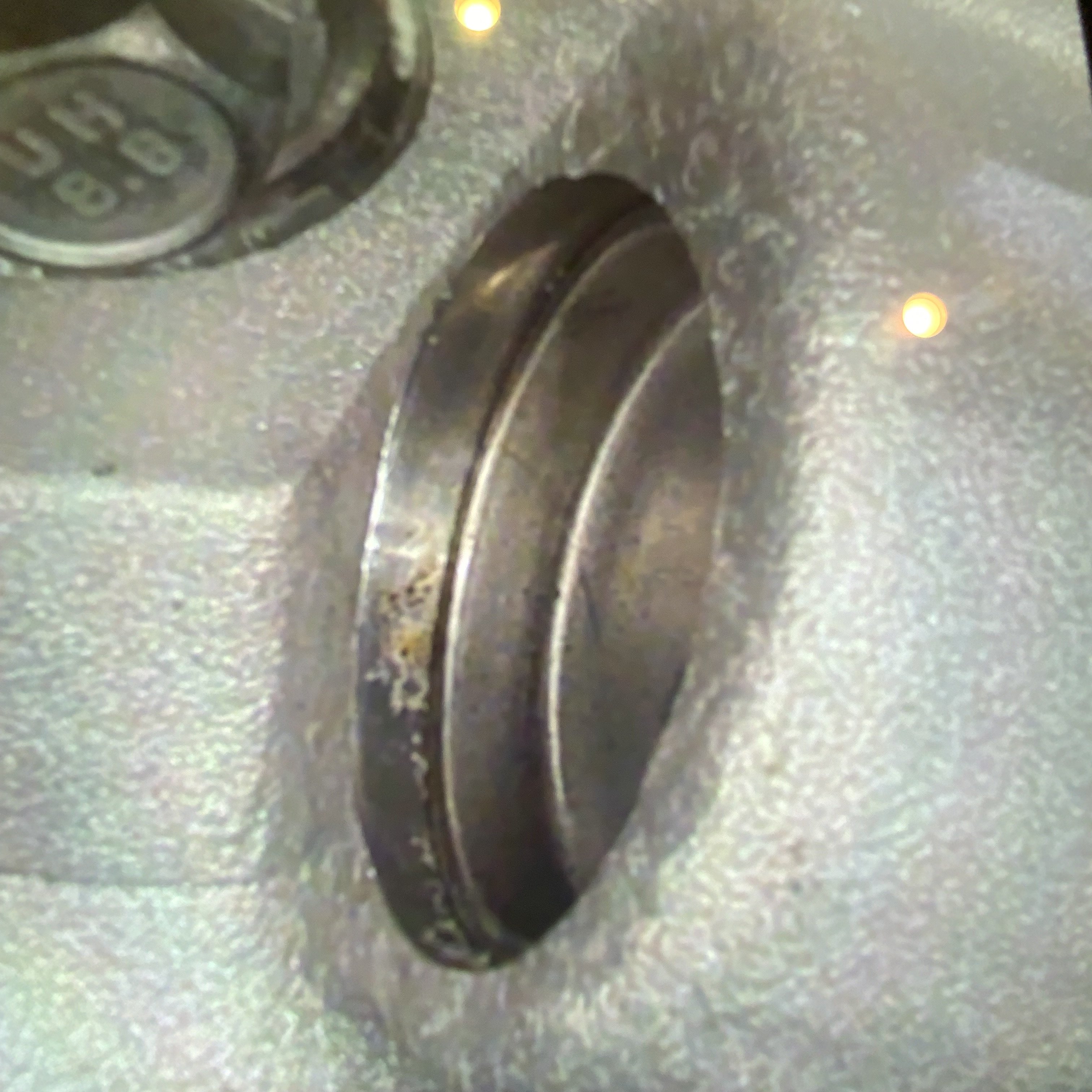

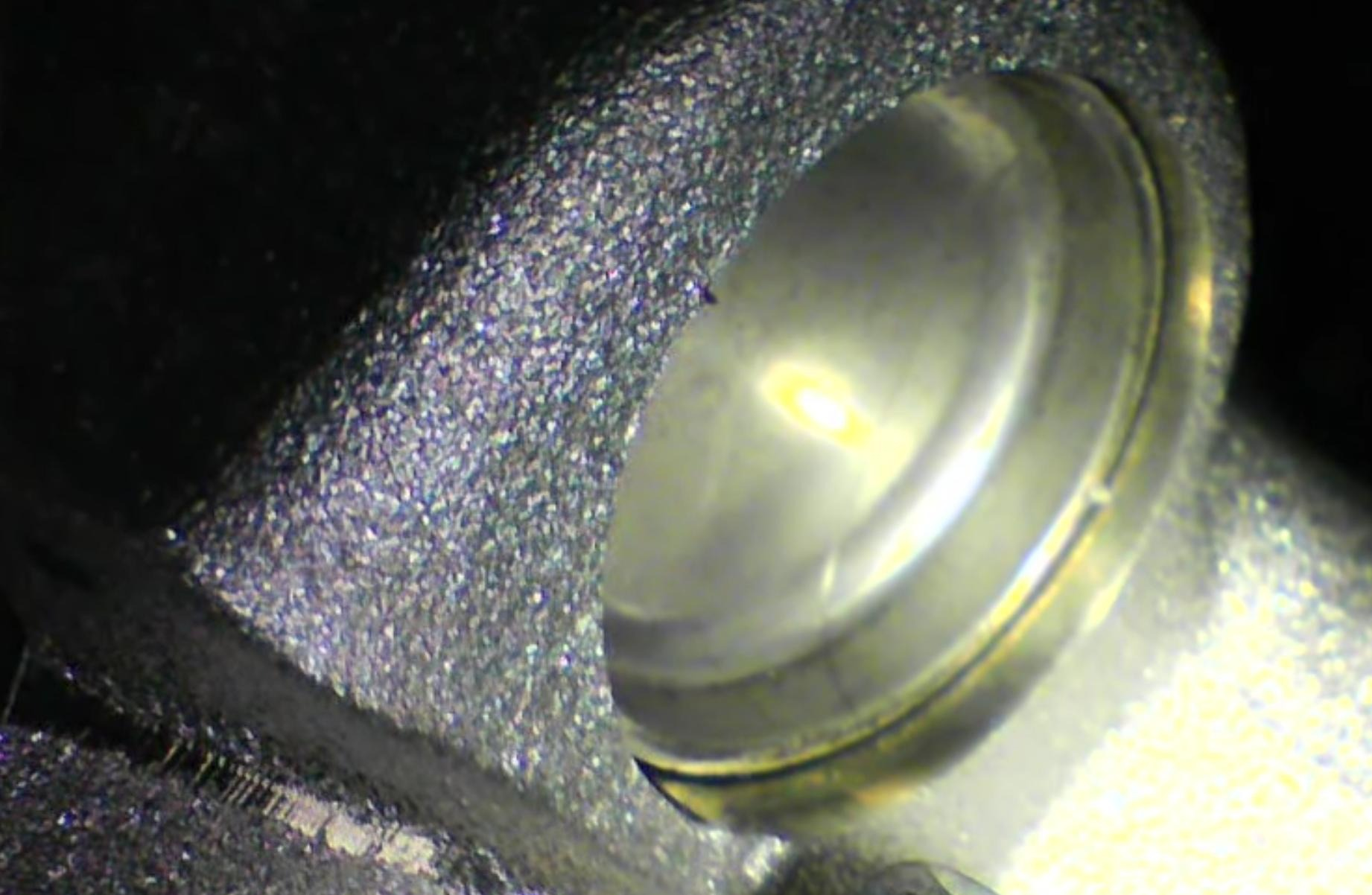

Had mine S/N 022 checked today and they had to press the plug in further. Per the TSB it is pressed in until it is just below a counterbore step. The service bulletin is attached. My dealer said it is now going to be a recall.

They must have used a cell phone camera from 2005 to take those pictures...jeeze
