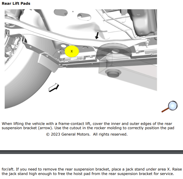

Have you figured out where to place jack stands while the car is jacked up via the pinch welds? Every other car I've owned had separate jacking points, either front/rear central or inbound enough at the corners to fit jack stands on the pinch welds.
JACKSTANDS
Yellow X marks the spot for the rear (per instruction manual)
No clue on the front. I would imagine there is a lift point the middle to secure it with both wheels off the ground. I really just lift mine an inch or two to swap out wheels, this is gonna need some further investigation

JACKSTANDS
I use these in front. RR sells 8" 10" and 12" versions, and I recommend the two-piece: Adjustable 4+4 Stacked Wheel Cribs Set

I use another orange style jack pad with included rubber blocks that came with my QuickJack. The rubber blocks make contact with the rear suspension bracket, but they're soft enough that they don't damage it, while providing enough clearance to the QuickJack not to make contact with the rockers or any other parts. While I'm not entirely satisfied with it, I feel it's safe and it works. But I think I'll try those rubber pucks in lieu of the blocks as they seem like just the right size.
Hoping not to create another one of those jacking debates, but the service manual does not list the pinch weld to be used for the rear on the 4BW. I've just used my jack with a large rubber cover to contact the suspension bracket with no problems.
Same here. I can use my jack pad adapter on the front pinch welds but it is easier to use the full size rubber jack pad on the rear suspension bracket since the rear pinch weld area is too tight.

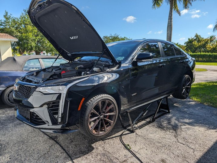

I followed this same method using a quickjack 5000 SLX. Pinch welds up front with rubber blocks/pads and then rubber blocks on the rear suspension bracket. Took a few tries to make sure everything was lined up (always overly cautious lifting a car up for the first time), but once that was done, was up for a few hours for first fluid changes with no issues.
@mfbmike I'd like to see some close up pics on the quick jack contact points. Thank you!
