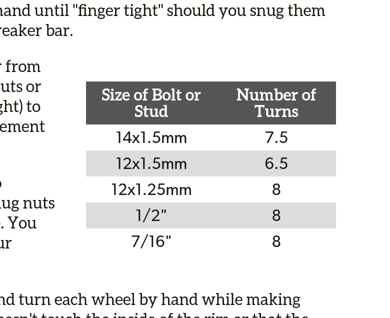

My set of Apex wheels arrived this week and I was concerned with the amount of thread engagement my lug nuts have. The factory wheels allow about 9 full revolutions of the lug nuts whereas the Apex wheels are thicker and only have about 7.25 turns. (Even less at only 5.5 turns with the front 3mm spacers). Did you install longer studs? Anyone have any thoughts or advice?
My mechanic told me that DOT minimum requirement is lug length of 14 mm after you mounted the wheel. You can use the back of the caliper tool to measure that.
The amount of thread engagement is contingent on the stud size. I don't think 5.5 turns is going to cut it, but 7.25 might work. There are charts out there that show the minimums. Just need to figure out what the stud size is.
It’s 14x1.5mm unfortunately. It’s no coincidence factory setup is 9 revolutions. :(
From Tire Rack. 7.5 turns needed.

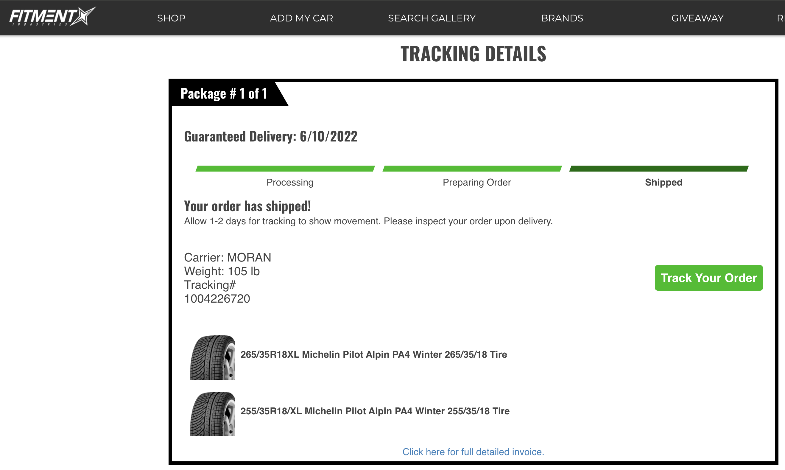

I wanted to revive this thread, as there will likely be a shortage of inventory again this fall. For those looking at winter tires for their CT4 BW, Fitment Industries is the first I have seen have both the fronts and rears in stock. In fact I just ordered them and got them delivered for whenever I do get my car, which may very well be in the dead of winter at this point. These would be for stock wheels, and are the models Cadillac uses for their CT4BW press cars (See my previous posts in this thread).
So for those that want to get a jump on it, hit up Fitment Industries.

What did they end up running you? Wonder if they will ship to APO
QTYDESCRIPTIONPRICE
2265/35R18XL Michelin Pilot Alpin PA4 Winter 265/35/18 Tire$662.50
2255/35R18/XL Michelin Pilot Alpin PA4 Winter 255/35/18 Tire$655.50
ITEM(S) SUBTOTAL:$1,318.00
SHIPPING:$0.00
TAX:$105.44
TIRE TAX:$10.00
GRAND TOTAL:$1,433.44

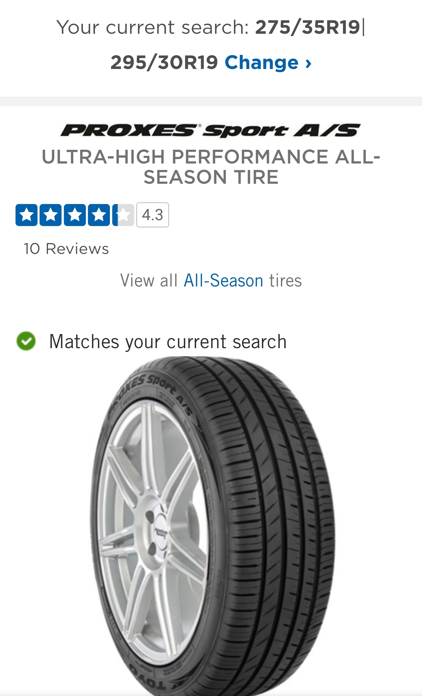

Anyone consider this setup for the 5? Seems like 295 should fit the rear rims and diameter is close.
