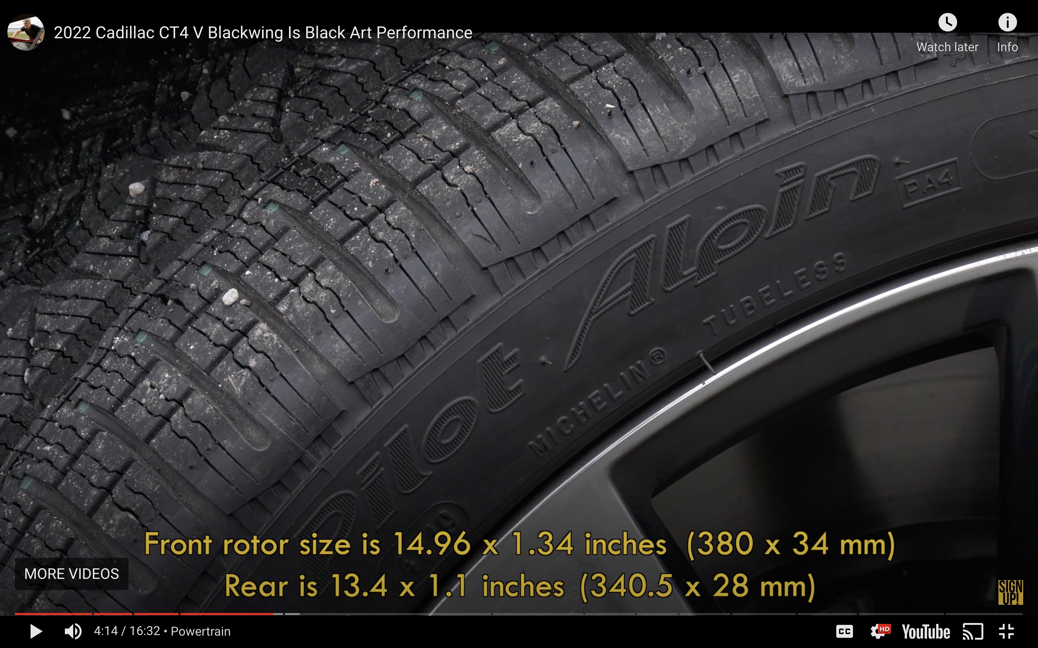

So... In the recent CT4-V Blackwing review on Driven Car Reviews With Tom Voelk, Cadillac put winter tires on the stock rims. I was able to snag a few screenshots. Not sure which version of the Michelin Pilot Alpin (4, PA4, 5, 6)... but there clearly exists winter rubber from Michelin that fits the stock wheels.

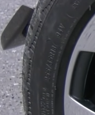

255/35/18 on the front

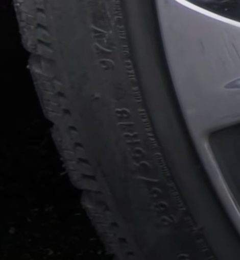

What appears to be 265/35/18 on the rear.
EDIT. I think I tracked them down
Front: Michelin Pilot Alpin PA4
255/35R18 94V XL BSW
(MSPN : 19300)
Rear: Michelin Pilot Alpin PA4
265/35R18 97V XL BSW
(MSPN : 29830)

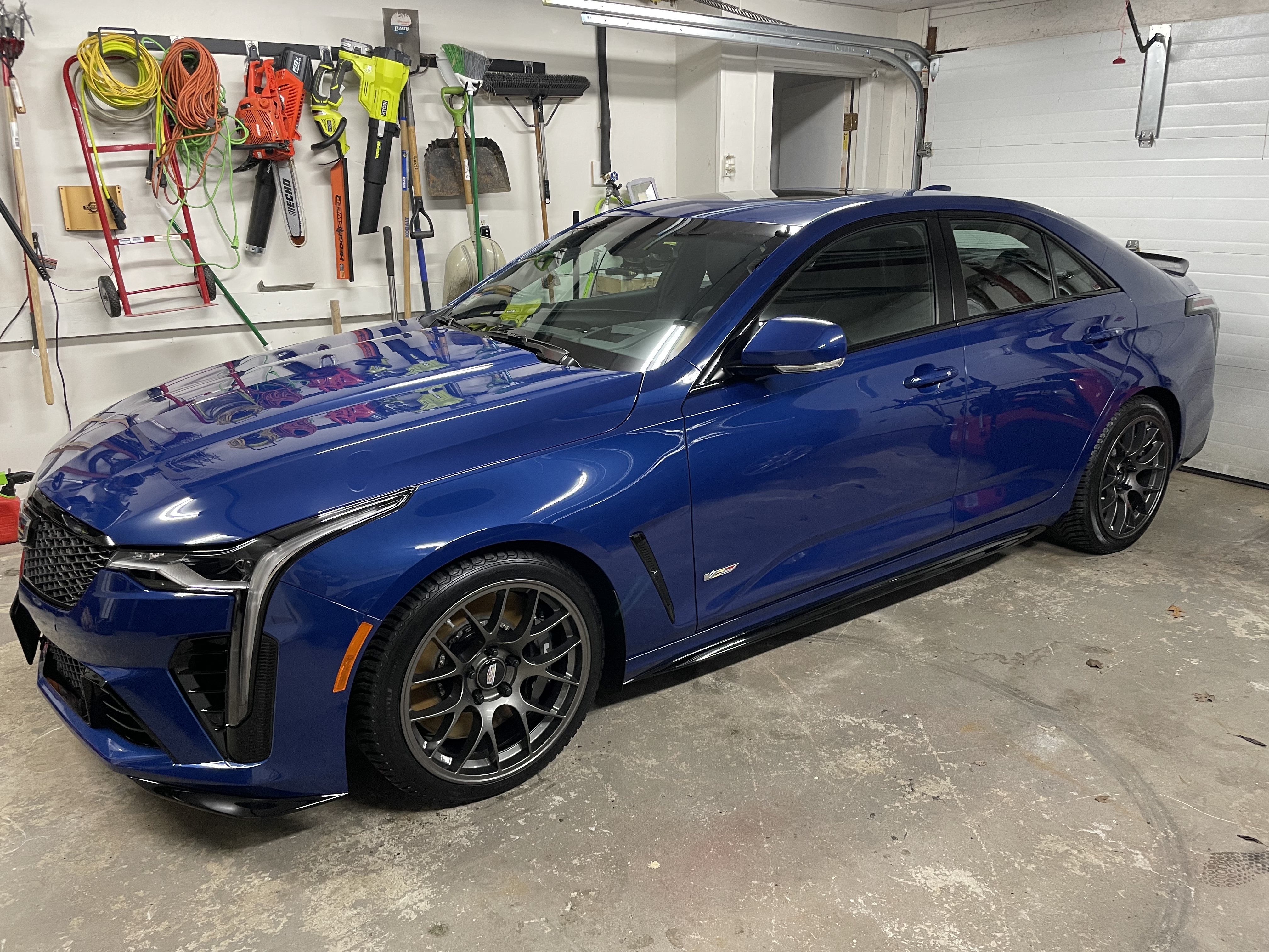

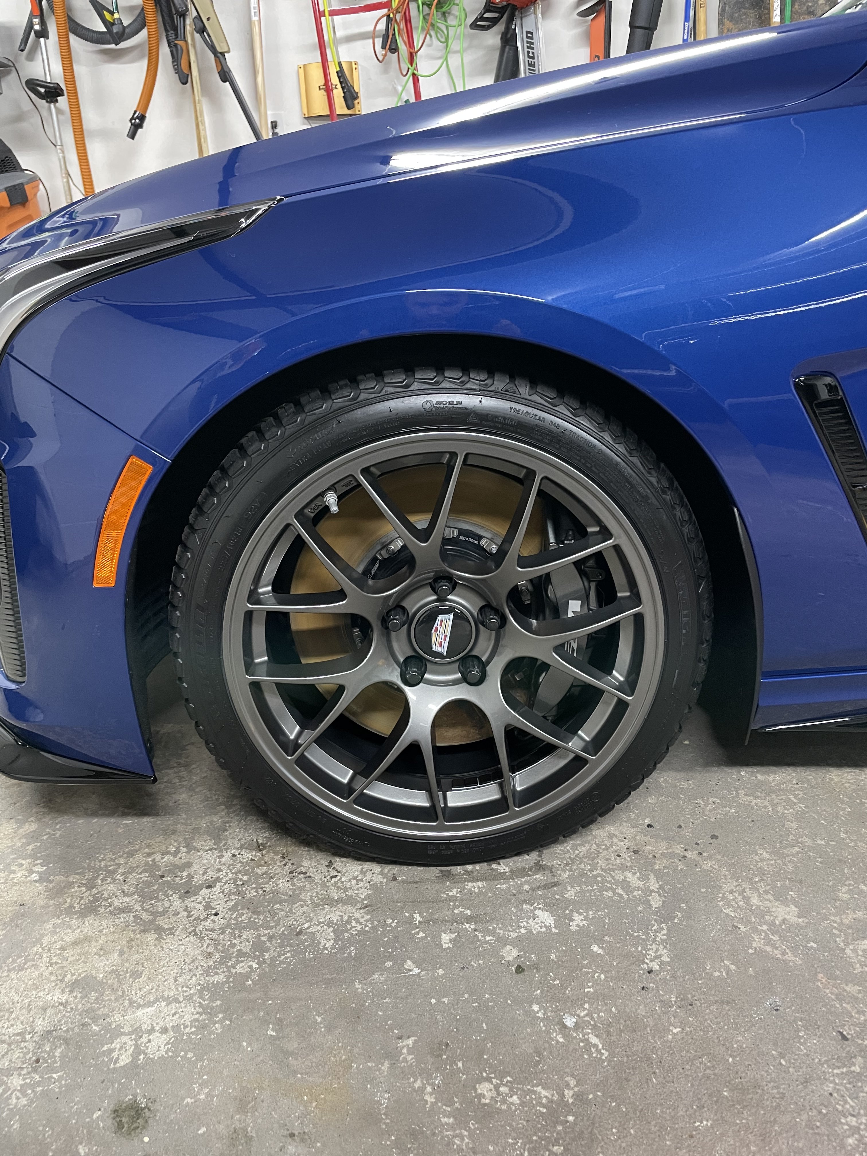

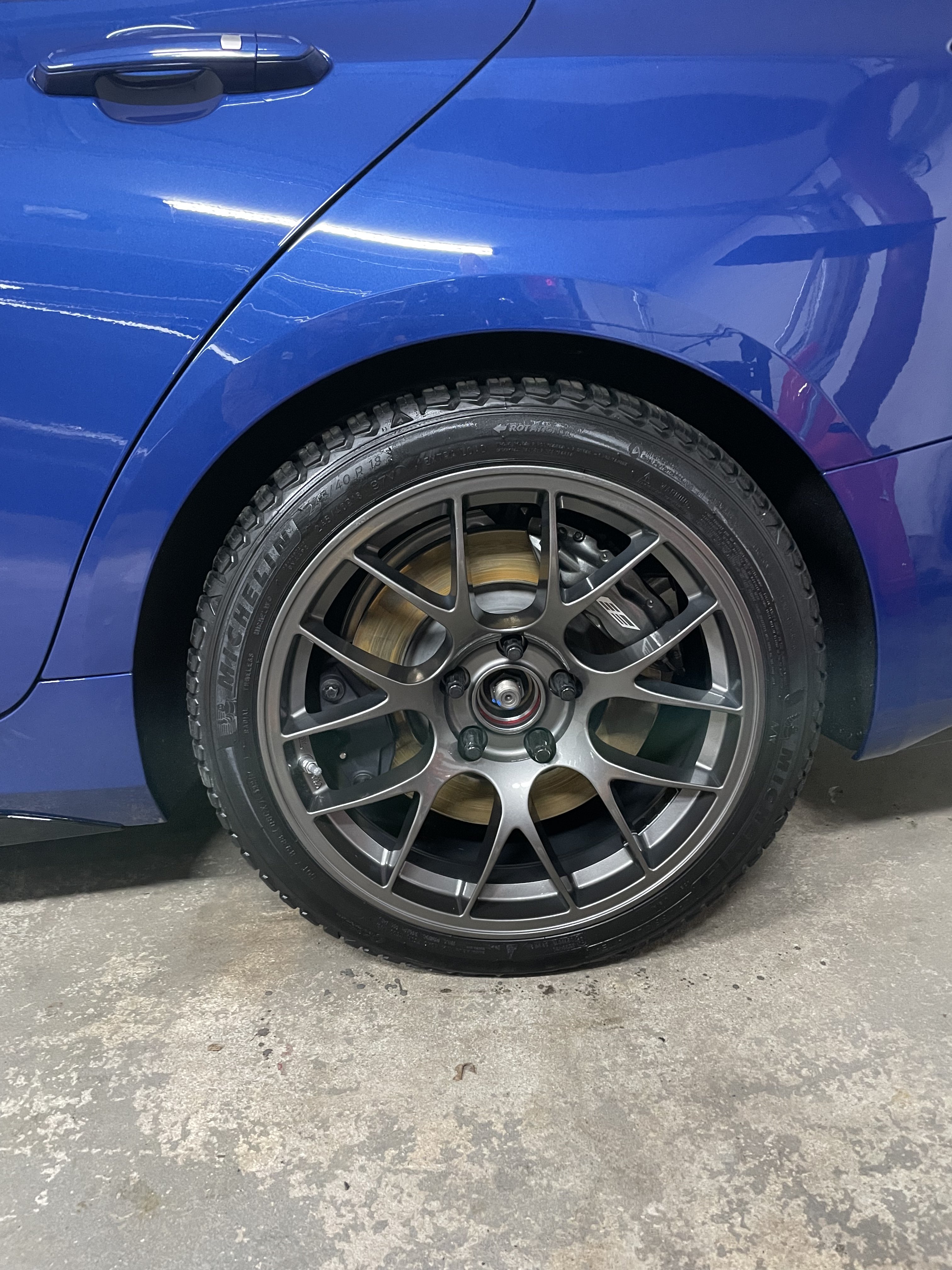

For the CT4 V BW owners, I was able to figure out a wheel/tire combo for winter use.
Wheels:
Apex EC-7 5x120 - these are relatively inexpensive and lightweight
Front: 18x9 ET31 w Apex 3mm spacers (brings it right to factory offset of 28)
Rear: 19x9.5 ET43 (extends additional 5mm out beyond factory 48mm offset)
The barrels easily clear the front rotors/calipers and the spokes in the rear also clear the calipers, which is the main concern when sourcing wheels for this car (there’s a little less breathing room than the stock wheels).
I went with Michelin Crossclimate 2 tires. They’re 3 peak rated but classified as all seasons. The tires are narrower than stock, but maintain the same diameter, and the wheels are the max size recommended for these tire sizes by Michelin.
Front: 225/40/18
Rear: 245/40/18
The stock lugs are a little too beefy for the wheels so I got Gorilla Automotive 26144BC - Gorilla Small Diameter Lug Nuts.
I went with GM sensors (13538760) and nuts (13581557).
And the wheels are 72.56mm center bore so I got Coyote racing 72.56mm OD - 66.90mm ID aluminum centering rings.
Hope this helps those still looking for some aftermarket wheels!

Thank you for trying it out!!! Will the front clear the caliper without the 3mm spacer?
I also heard from Apex and got the same recommendations. Shout out to @WONT TAP for providing measurements. Apex is pretty much the only manufacturer that has 18" non-forged wheels that fit the CT4 BW... And I contacted a crap ton of manufacturers!
Yea Apex was great. I worked with them to test fit the wheels before I committed to buying all 4. It was a win win.

Are you able to install rear center caps? Just curious if there is some sort of interference or you hadn’t gotten to it in your photo. Thanks
