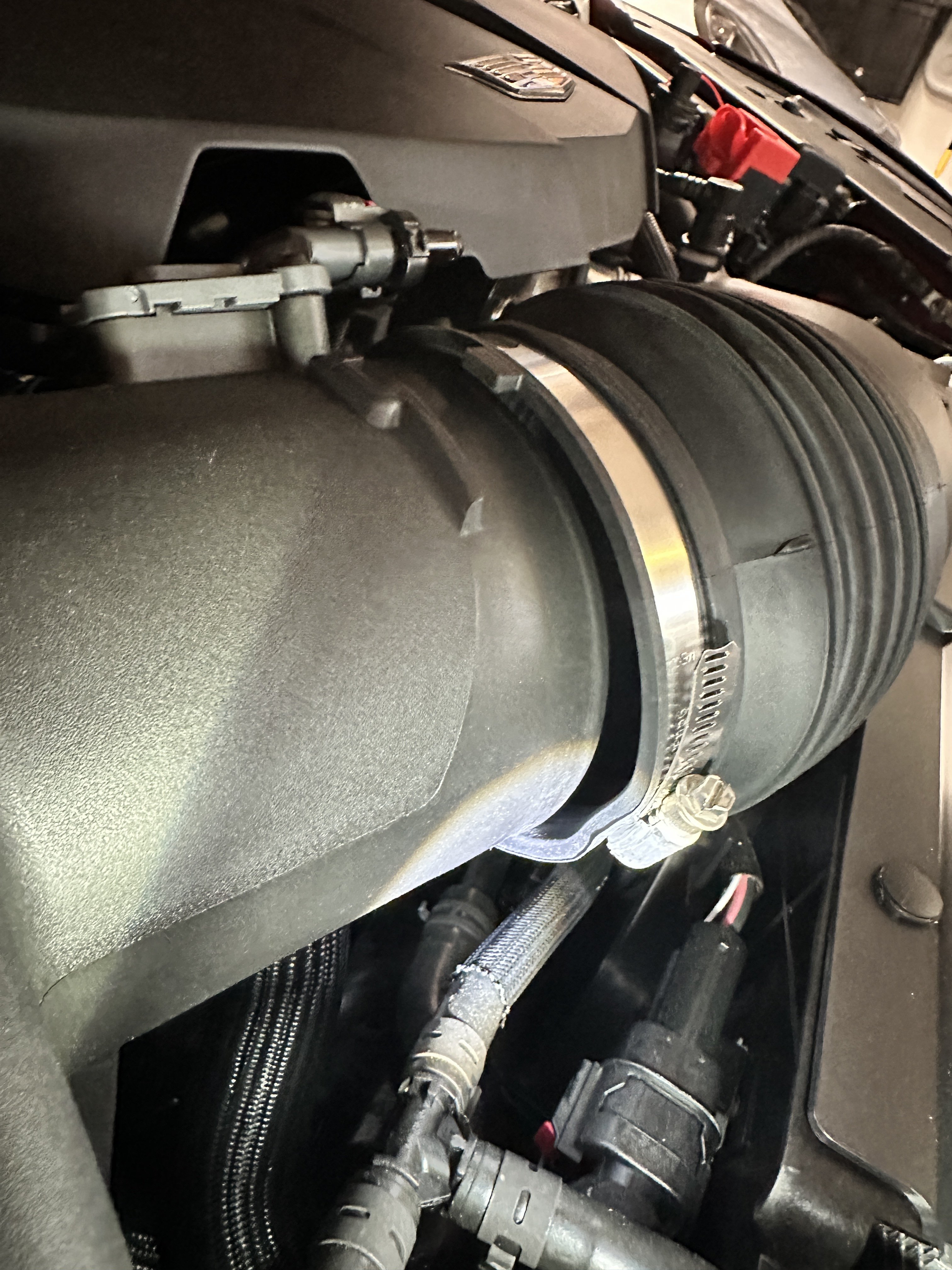

UPDATE:
I found the problem. I hate to admit it, but clearly I didn’t look carefully enough at the air intake. I guess my wife has been right all along, apparently I don’t look carefully enough. According to her, I “man look” for stuff. Anyways, I looked more carefully and noticed the big rubber hose that goes from the air box to the throttle body was not properly mated to the air box and had popped out. I have attached a picture. After some elbow grease, I was able to install it properly and now the low rpm rough idle has resolved. I will keep an eye on it in case it pops off again. Hopefully, this was a fluke and won’t be a recurring problem. I am glad I found the issue and it was nothing serious.
Thanks to all that replied.
This? ^
UPDATE:
Thanks to all that replied. View attachment 20395
