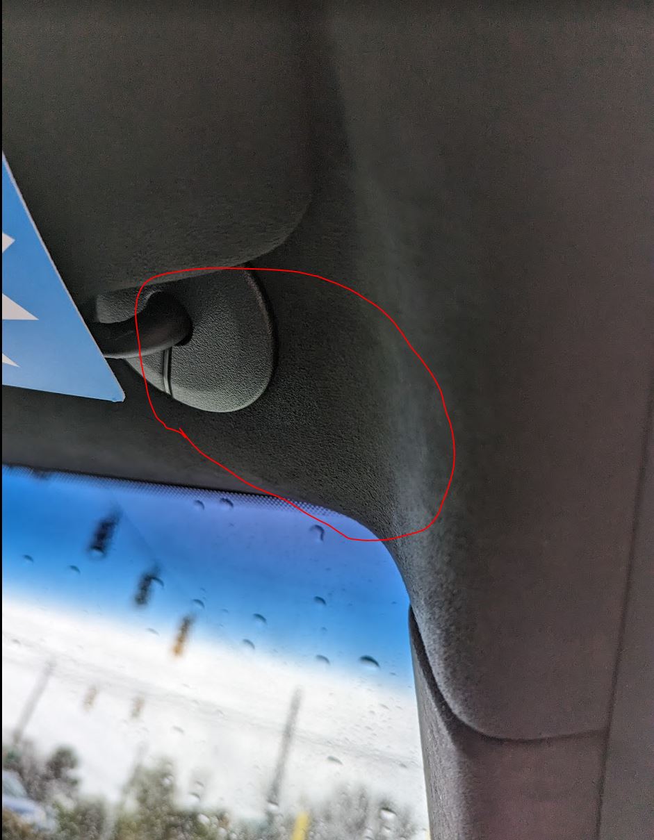

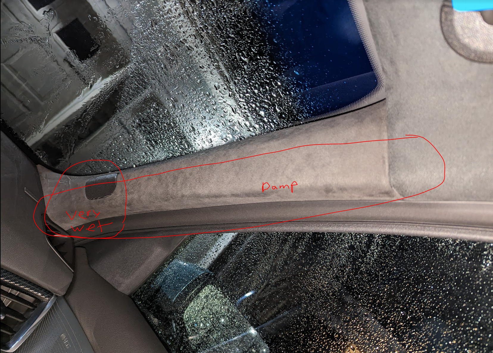

Well found the flaw of Midnight Steel Metallic, its not water proof..... Light rain today took one of my coworkers to lunch and he starts getting dripped on from the headliner
Water was coming out of the ring around the sun visor and the head liner was rather wet
Anyone have any tips of things I should look out for when I bring it in to the dealer? I've had the car for 6 days and it has 240 miles on it.... It was in the goat pen for about 2 1/2 months not sure if I have any risk of lasting water damage under the headliner.

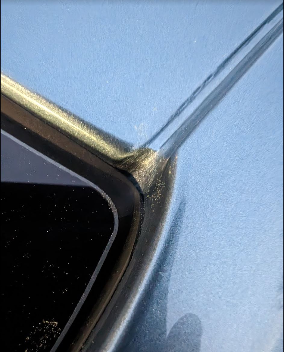

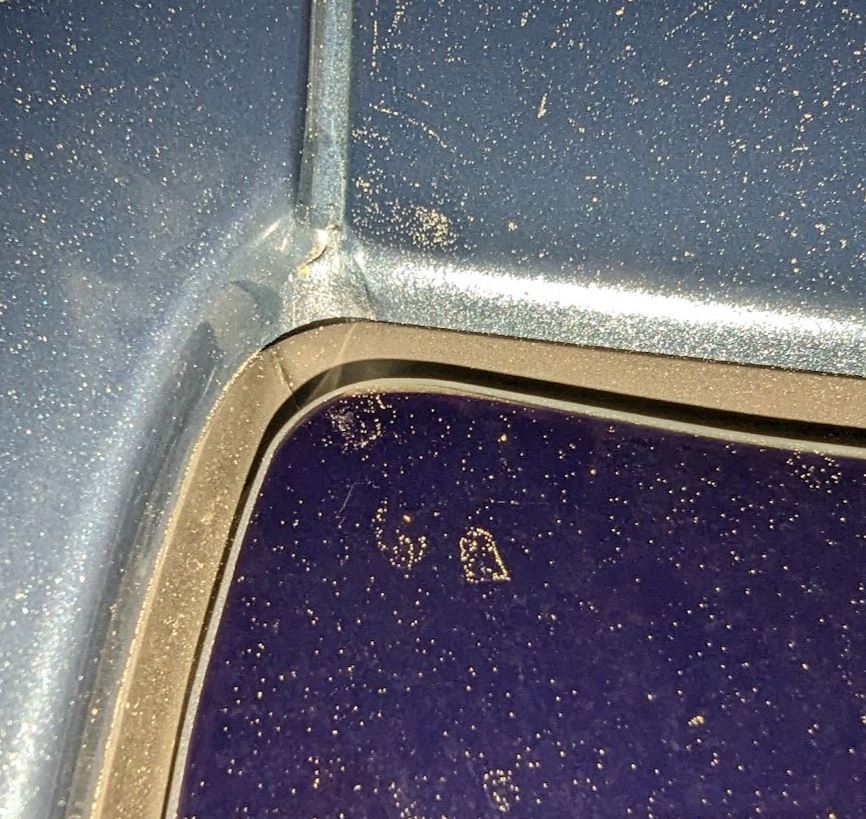

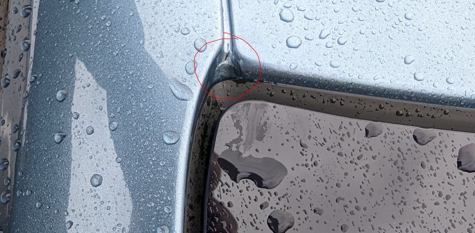

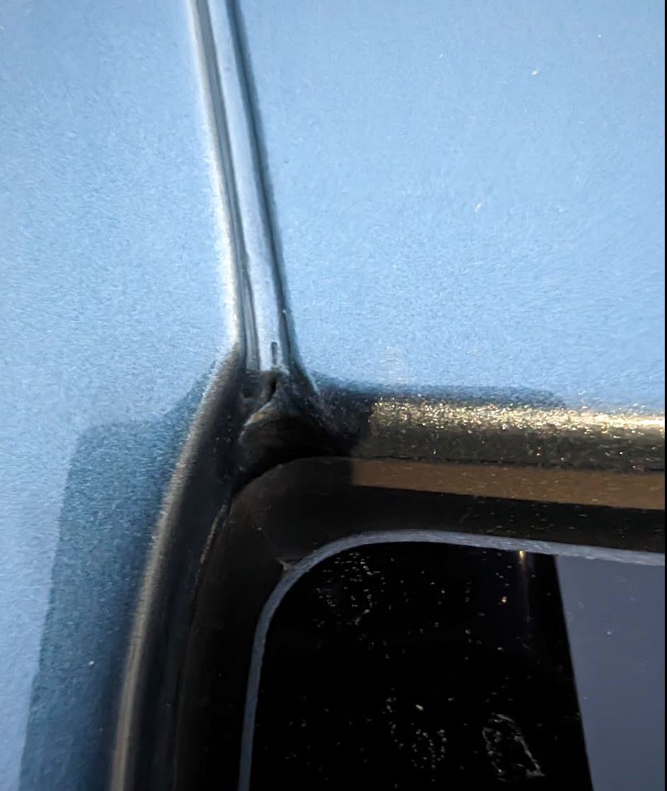

Looked at ours, to much seam sealer not allowing windshield rubber to seal properly
IMO
Thanks for the feedback, setup an appointment for Monday for them to take a look. I think your right that it is seam sealer has a bit of give to it if I push on that spot. Anyone know what an acceptable fix will be? as it has paint on it they can't just put more of the black windshield glue/sealer as it would be visible.

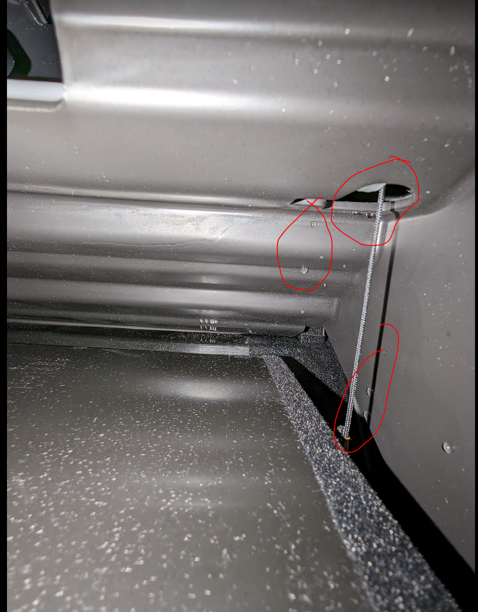

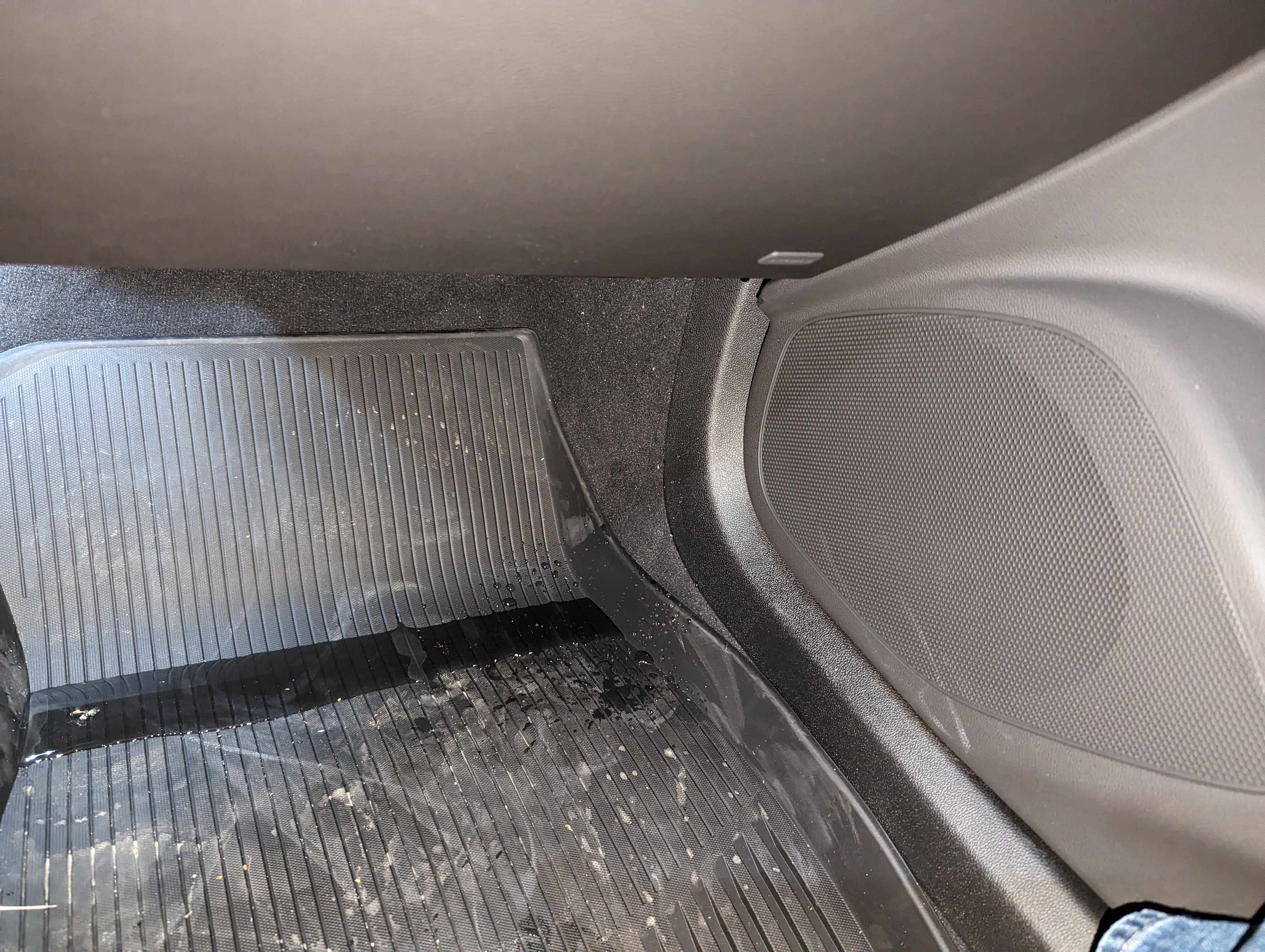

Looks like my tape job did not help, went out to check on it after some rain today and found water is running inside my dashboard now. Was not a hard rain, but has been on and off most of the day. Anyone know what electronics run down that side of the car? The trim that is getting wet now has some play to it if I lightly pull on it
inside the glovebox

Had it taped up in that area, but it didn't seem to help so not sure if its coming in some other place or if the water made it under the temp patch job. Went 5" out from that spot with the temp cover, again wasn't raining hard at all light rain on and off during the day.

From the pictures the OP has posted the leak appears from the front windshield, not slider as you call it. Most likely not enough sealant in that corner area.

I could be the windshield, but it seems unlikely it would be wet so far up the A pillar trim.
If you have a sunroof, my guess would be a disconnected/pinched drain hose.
