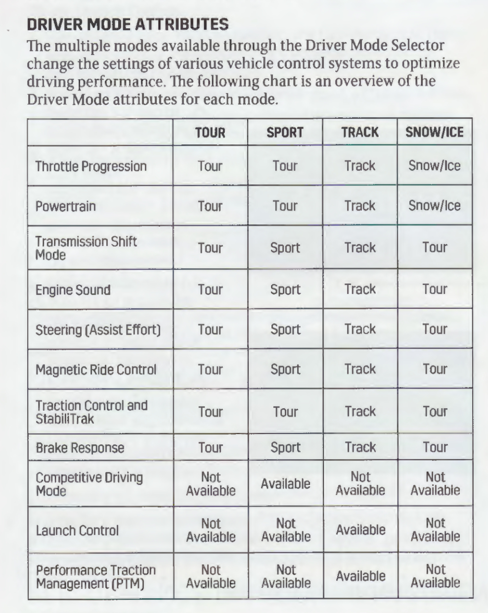

PTM is only available in Track mode.
Note that Cmode is not included in the table. PTM is configurable for Vmode in my car for sure. Look at the bottom right setting. 1 V button tap gets you your Vmode. 2 V mode taps gets yoy Vmode+plus PTM settings.
Also, its silly to think that there are only 5 parameters affecting driving dynamics. I am sure the DME more elements affectingn the various modes. Of note there is nothing in the VMode configurator related to the eLSD lock up algorithm.
Im sticking to my story that Track mode is a fundamentally different drivijg mode that cant be fully replicated in a Vmode config.
I think the only person here that can clarify your theory is Mirza.
PTM is available in V Mode.
