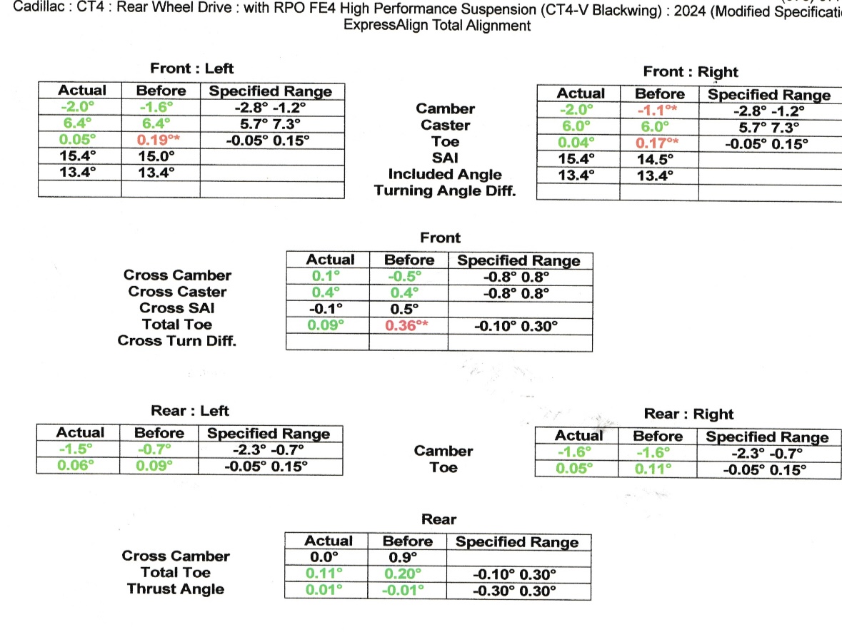

I disagree. I went from the standard street alignment to kind of hybrid street/track alignment (-2 deg front, just adjusted at the knuckle-not strut tower adjustment, -1.75 deg rear, very slight toe in-essentially zero toe with a toe in bias) and noticed a significant difference in turn in even on the street. I did not track the car prior to changing the set up but if its noticeable on street then its likely more so on track. But i guess it depends on your definition of “fine”. The car will work of course with the stock alignment but in my opinion youll be pushing understeer quite a bit.

Kind sir- could you provide your alignment report/sheet so others might partake in your 'best of both worlds' settings? Thanks in advance.

Like I said, I did not have a chance to track the car before I adjusted the alignment so I can’t answer the question about lap times. That said, I don’t really think it’s much of a leap to assume that additional camber will improve lap times, especially considering GM specifies the track alignment with the additional camber. A number I can provide (and did) is that I’ve now have 10,000 miles on the stock tires (>9000 of which post alignment adjustment) and I am still above 50% tire life for sure and see nice even wear which suggests that running additional camber on these cars won’t kill your tires on the street (provided you run light toe I am- which certainly makes the car a bit more darty, but frankly i like it that way and i see it as more of a benefit than determent)
To the original poster's question, the factory street alignment spec is not aggressive. But, these cars sometimes come from the factory with an alignment way out of spec so it may be a good idea to get an alignment. @AC2024 "before" alignment is an example, my car was similar, it came with too much front toe which will make the car not want to turn and hurt tire wear.

I currently have 6500 miles on my car on the factory alignment. The tire wear is even so far, but I am planning on an alignment this spring before I do my first track days in the car. I will probably aim for camber settings of -2 degrees max front, and -1.5ish degrees rear with slight toe-in all around.
