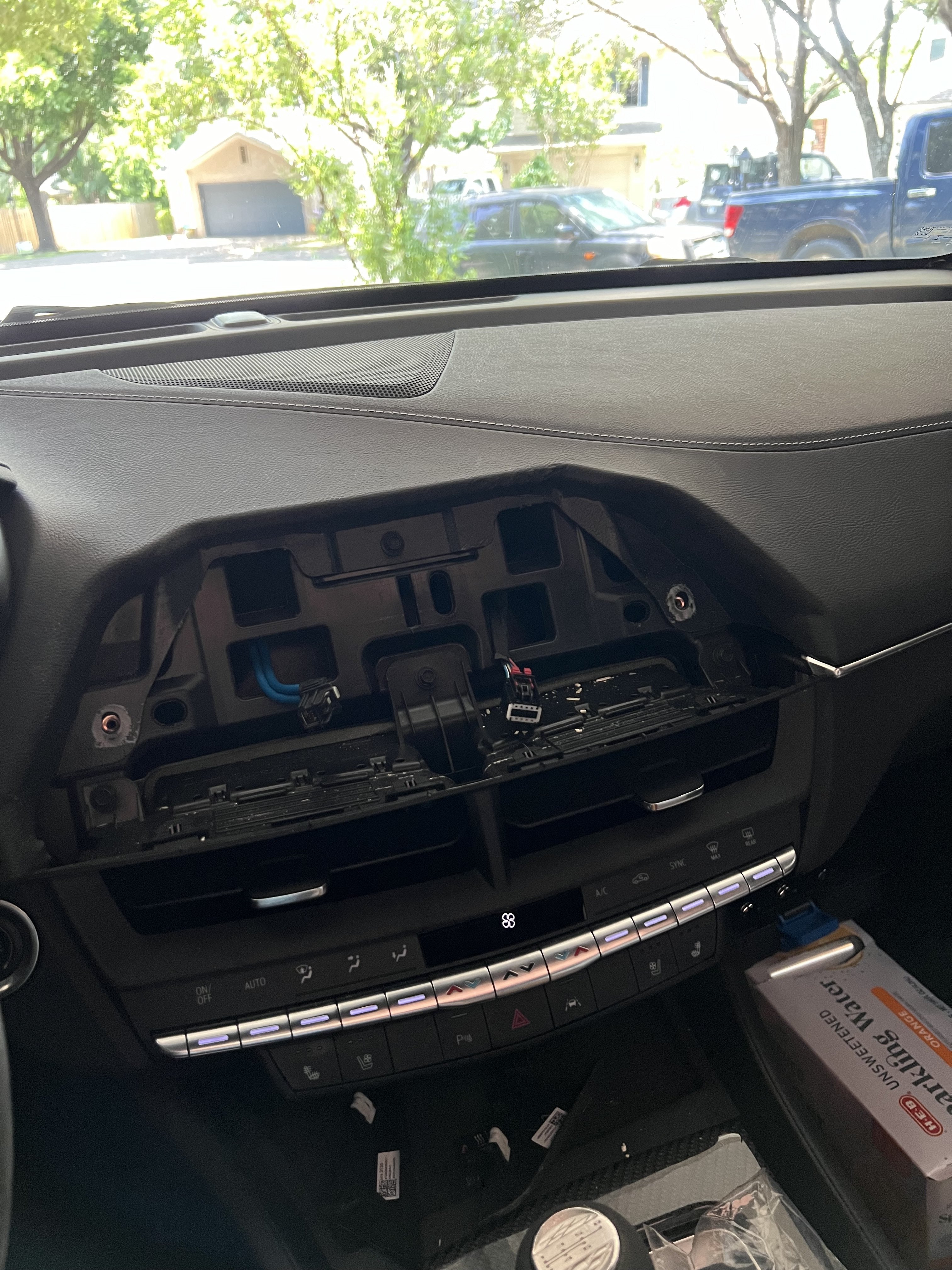

Trying to take out screen. Whats my next step. All help is super appreciated!

I was pulling on mine but couldn't get it to pop off. I was afraid of breaking it so I chickened out.
That seems about right?
That was very much my experience, yes. For me getting it out required the use of a pry bar, which may or may not have been a good idea. I’d defer to someone smarter than me tbh…
I yanked with pliers. The plastic tabs are glued so it requires a lot of force. You won't break anything as long as you have the 2 screws out after you popped off each side triangle piece.
Yeah also don't bother popping off the black bezel (piece I wrapped in carbon behind volume knobs) ahead of time, it doesn't Make it easier and you run the risk of breaking the really tiny tabs that hold it on
To get the screen out:
Pull the side triangle trim pieces
undo 2 bolts
get comfy straddling the center console and use all of that engineer strength you gained from never playing sports growing up to pull the screen out on the bottom. There are two hooks and some cables to undo. I've got a writeup that I can dm if needed.

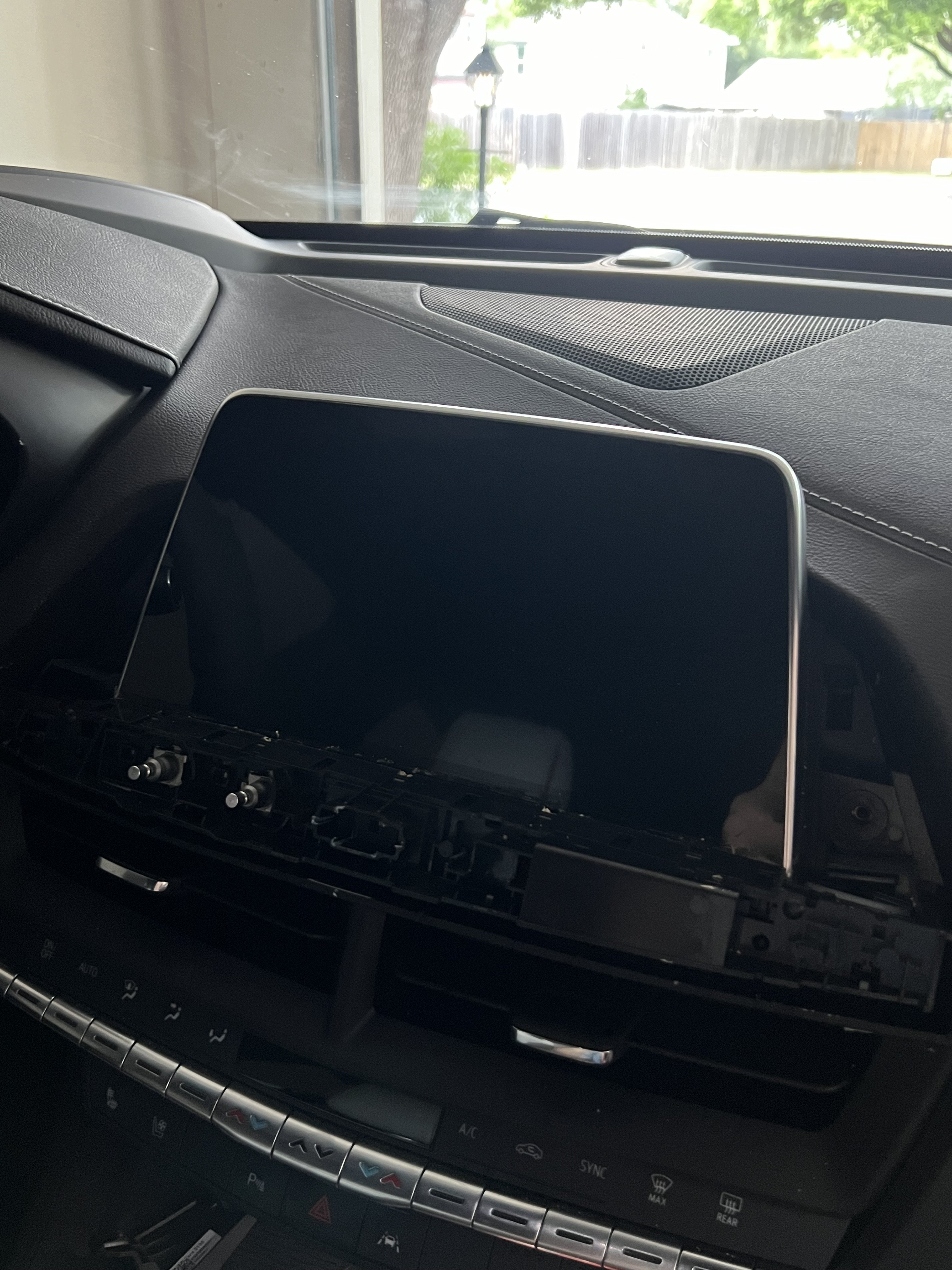

Where do you guys grab the bottom of the screen to pull it out? I can sort of get one finger in on each side, but its not moving much. Have yet to figure out a way to pry it.
Trying to get to something rattling behind the screen...
