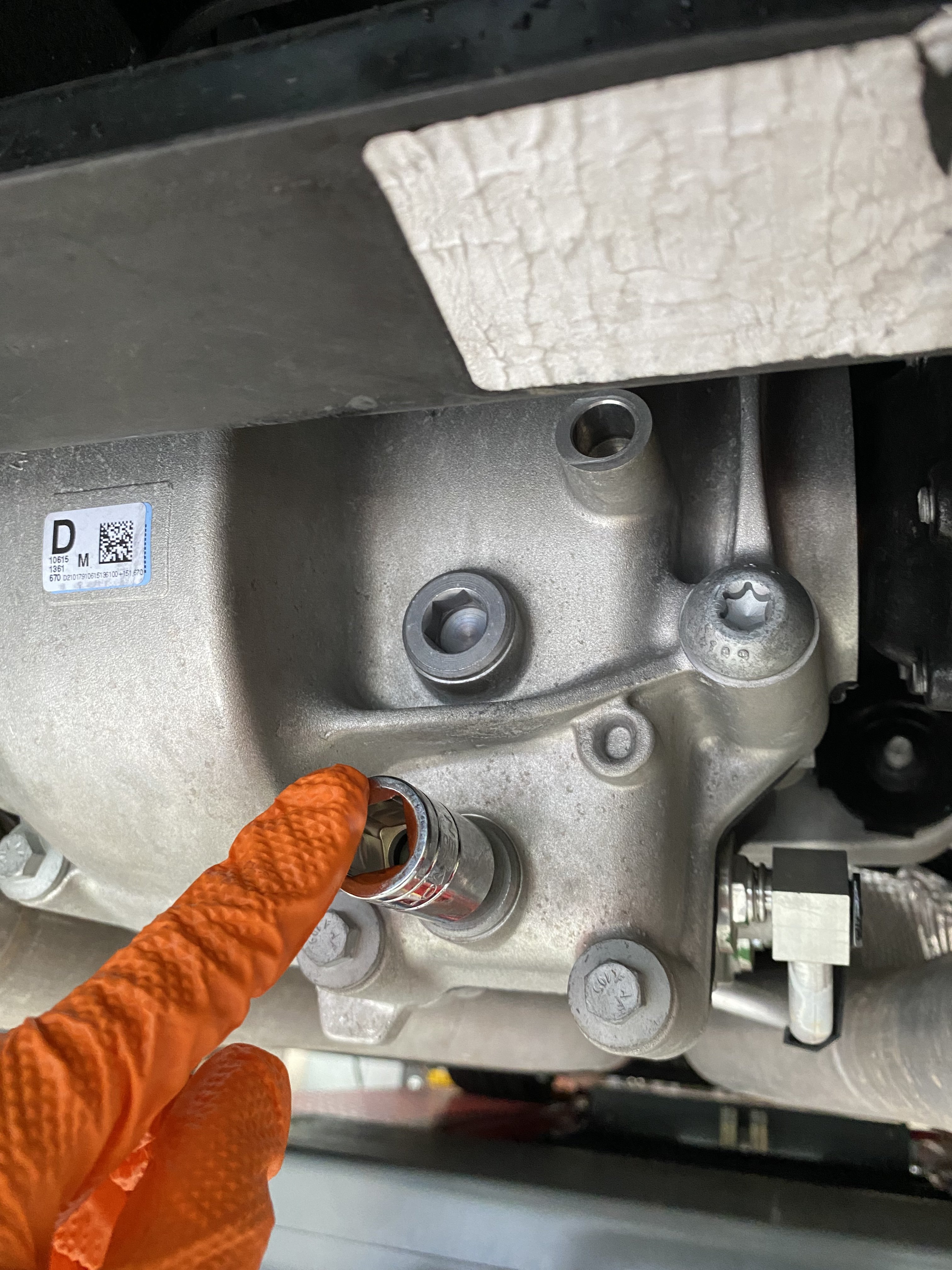

Just changed mine. Extremely easy to do. It is in fact a t70. Plugs get retightened to 50nm.
I know it’s similar, but I used 14mm hex socket. Direct fit to my 4BW.

I did. 15 minutes work. No issues.

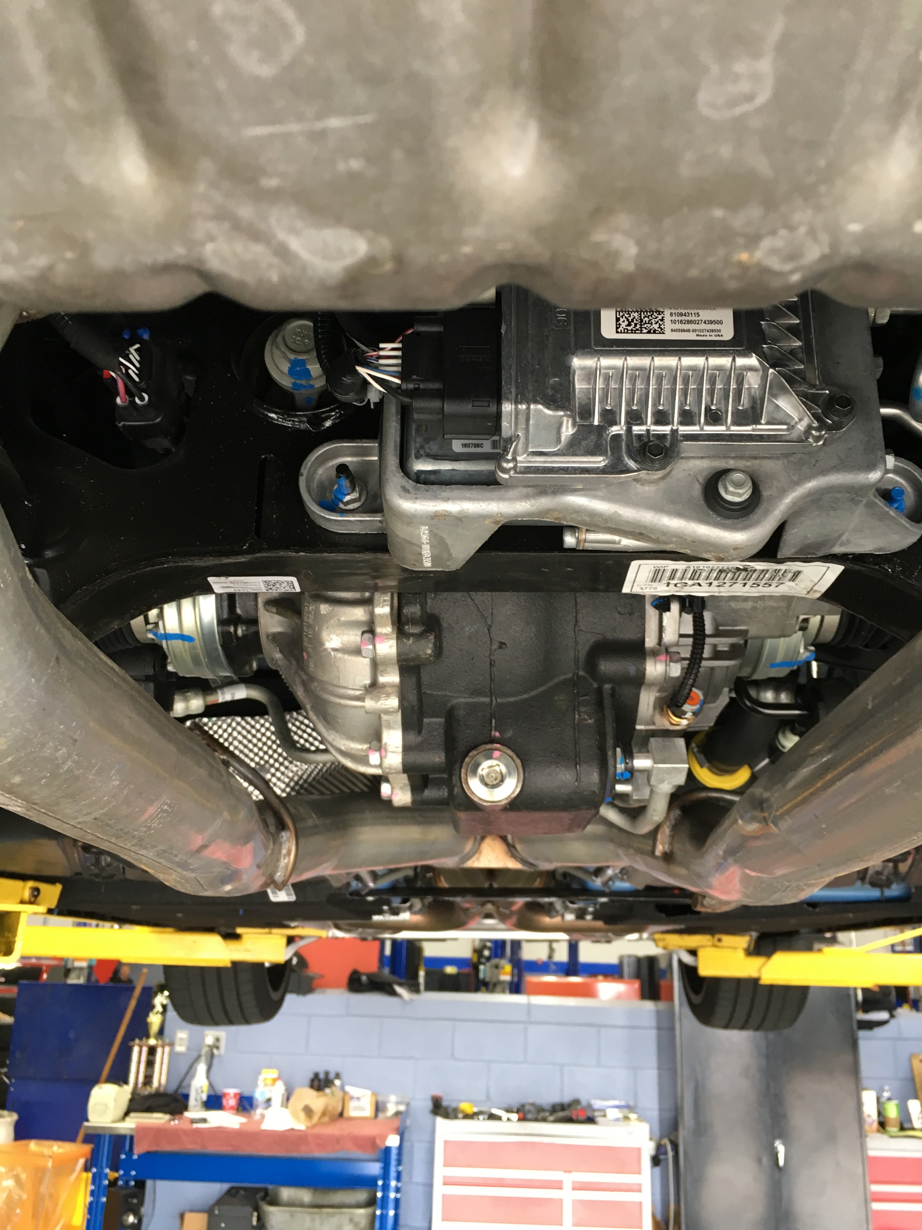

Is there just the one drain and fill via the rear facing plugs? I thought I read something about a driver side and passengers side. Maybe one is for the cooler?
So there is no procedure for sucking the oil out of the cooler loop? This is my first vehicle with a diff cooler.
Look at my pic above ( with the orange glove). The bottom plug is for drain. The one above it is for filling.

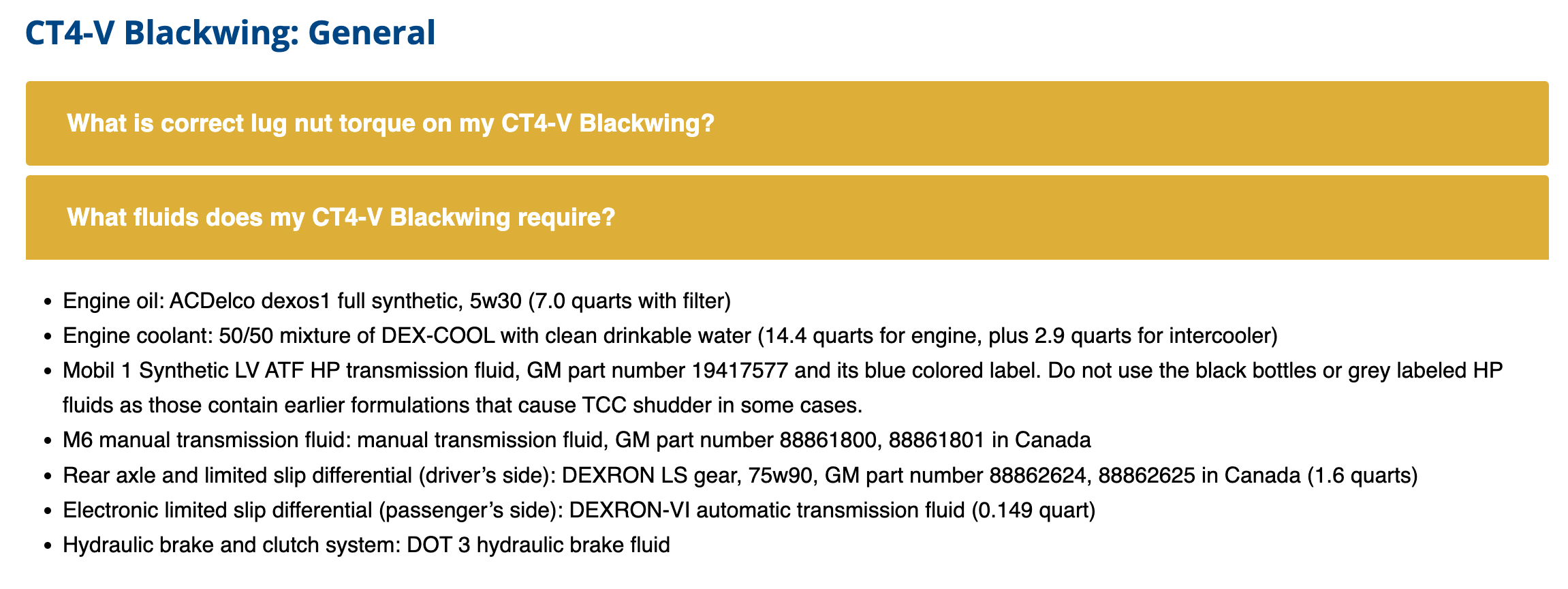

Thanks, that is what I thought but I saw this on the Tapout Tuning site and I was wondering if there was more to it on these cars since I saw drivers side and passenger side...
I've never heard of the passenger's side fluid. I does not mean that I'm not wrong. Haven't heard about it in the Camaro world as well. Also, the fluid number that I used for the rear diff was 19418501. Different number for 5BW. I followed the owners manual and added 1.3 qt (not 1.6 as this doc indicate).
You do not want to mess with the ELSD fluid just the diff fluid itself. Treat it as if it did not have ELSD and it was a standard diff.

I was just looking at the FSM for the 5BW. For diff fluid replacement it just mentioned the one set of drain and fill plugs.
I can't find a procedure to flush the diff cooler and it looks like the diff cooler is actually tied into the transmission fluid cooler.
That could mean two different things. They share the same cooler, but independent fluid lines or they share the same fluid (highly unlikely).
