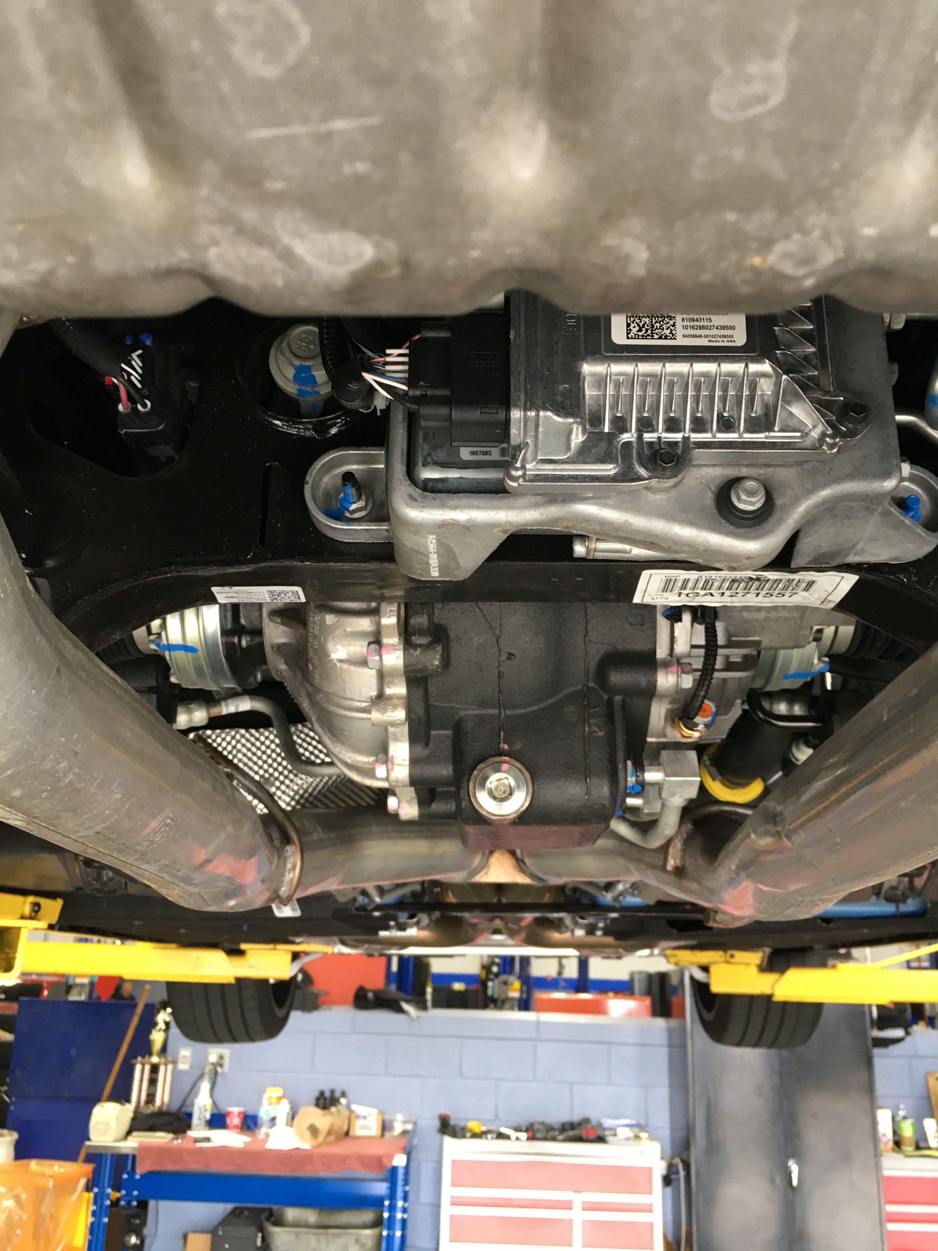

This is what goes in the 5BW

I confirmed with @Mirza Grebovic I had the right fluid for the 5BW.
That was after I contacted him in a panic because the car was making a horrible screeching noise after I replaced the diff fluid. Issue turned out to be a stone between the rotor and backing plate. Such a gracious guy with his time and assistance.
