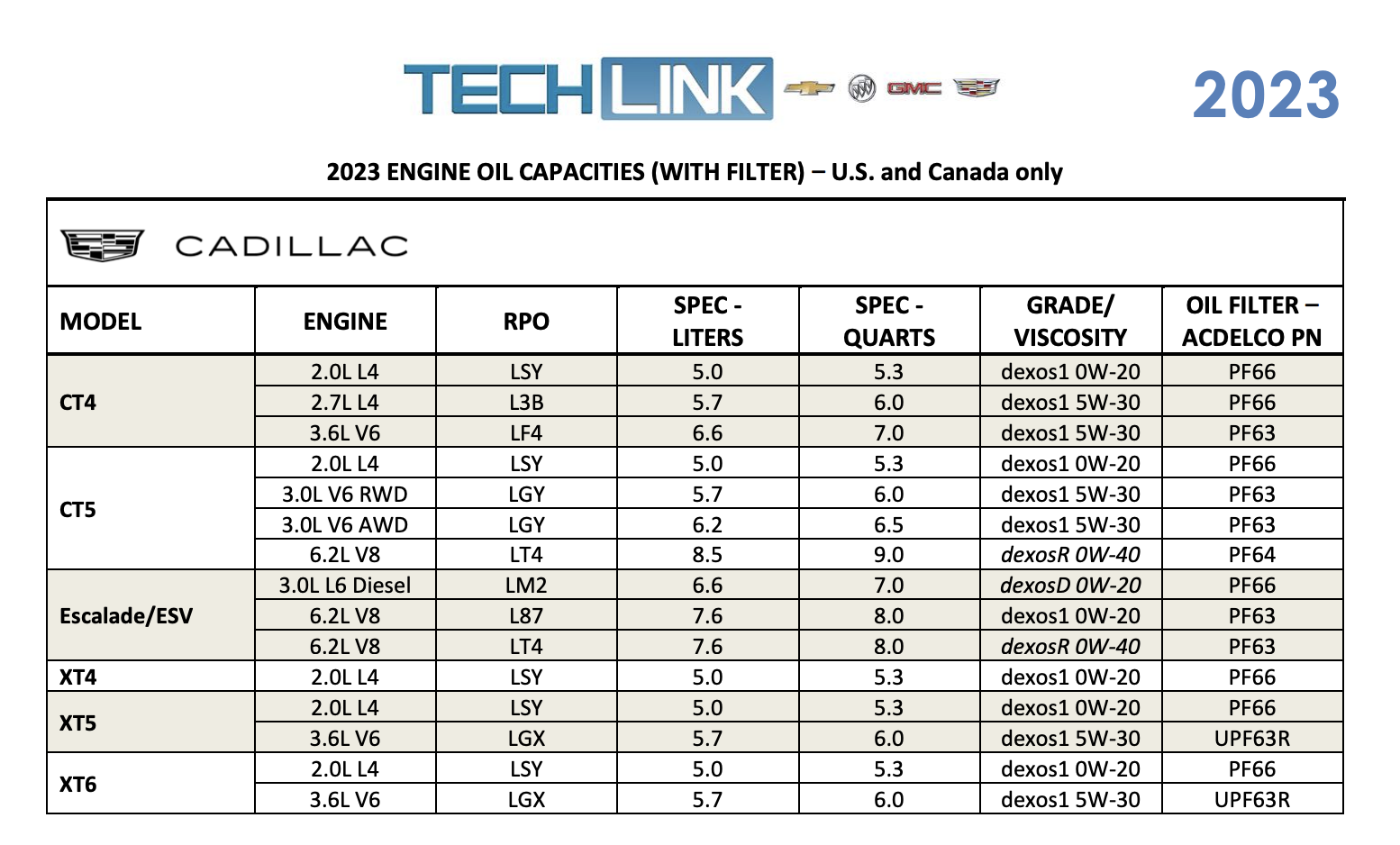

Hello! I recently got a warning light for low oil.
CONTEXT:
-2023 CT4-V Blackwing manual
15000 miles on it. It had an oil change at 5k, and at 10k because I like to go in early with these things.
I checked the dip stick after I got the low oil message and there was nothing, not even touching the bottom of the stick. I then waited a full night (manual says at least 2 hours) and now its barely touching the bottom of the dip stick. The oil life monitor is at 38%. I can't wrap my head around the car consuming that much oil in 5k miles. Has anyone run into this issue? Thoughts? Concerns?
