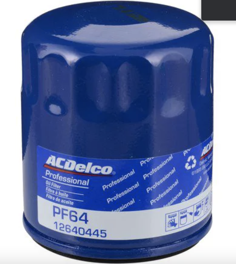

5BW LT4 uses a PF64 filter and 10qts of 0W-40. Either the ESP Dexos2 or the new rebranded Supercar oil. 18 ft. lbs on the drain plug.

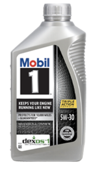

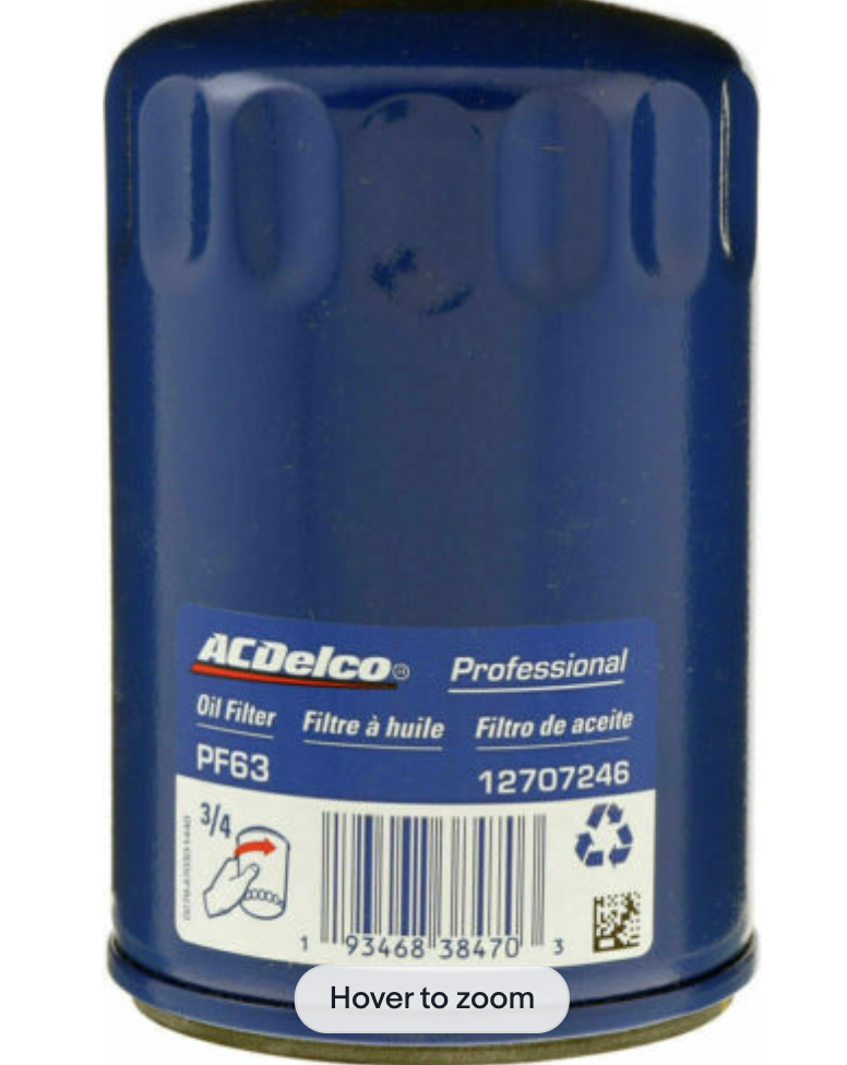

The 4BW LF4 gets away with some less expensive 5w-30 Dexos1, which comes in 5qt jugs for less than $25 at Walmart. It uses a PF63 filter and calls for 7qts.

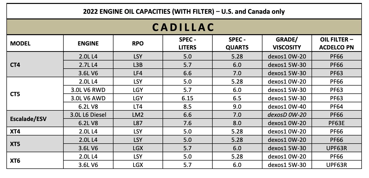

Here is the link to the GM Techlink reference for all the motors and filters/capacities.
I do find it strange that the Techlink doc states 9qts for the LT4 on the 5BW and Dexos1, while the LT1/LT4 on the Camaro calls for more expensive 10qts and Dexos2. This may be why some dealers are putting in the standard 0w-40 Dexos1 during the dealer oil changes. Maybe a different oil pan for one less quart? Not sure...

Yeah, this is the first I've seen a Dexos1 for the LT4. It has to be a typo. There is no Dexos1 0W40 anyway...https://www.gmdexos.com/brands/dexos1/index.html

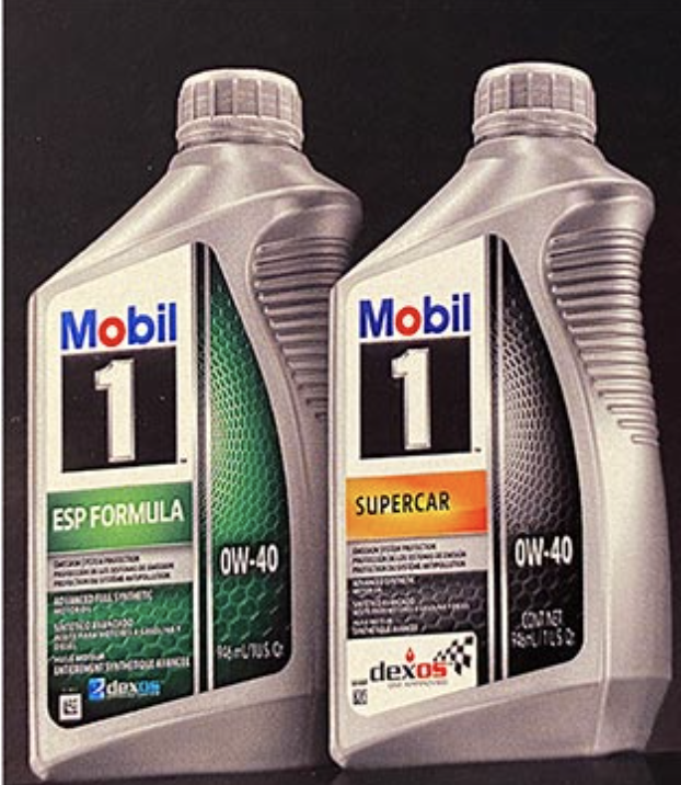

It's very simple, there is only one oil for the CT5VBW...Mobil 1 ESP (Dexos2) ESP 0W40...that's it. It'll be called Mobil 1 Supercar Dexos R soon, which will make it even more confusing (and expensive).

I agree. Not a good document to make a typo. :-)

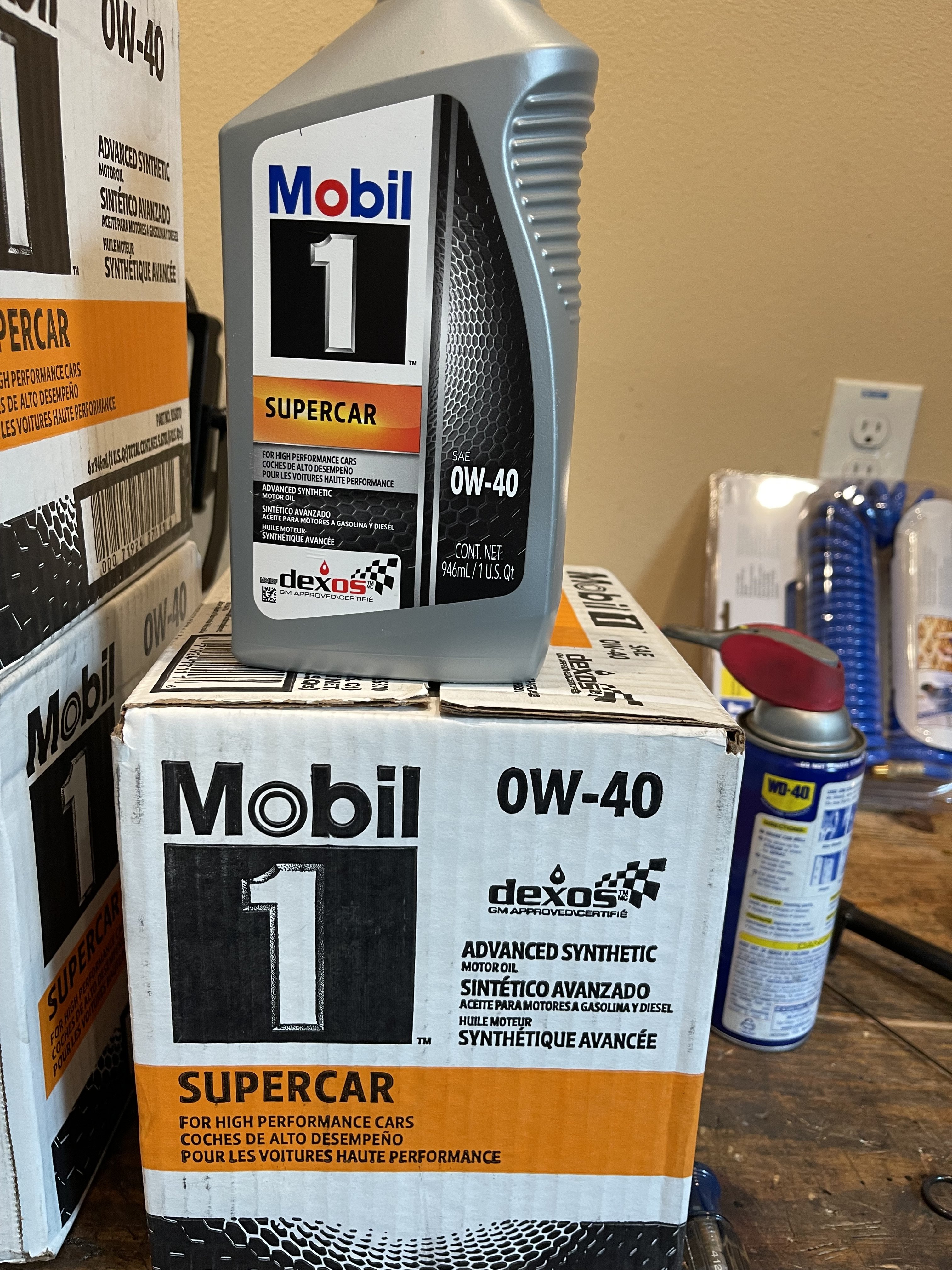

Don't think it's a typo. You need to get this stuff. A little hard to find, but part stores can get it. A little pricey at $13/qt.

Was not reading manual correctly. Caddy and Chevy call for Dexos 2 for LT4.
Although, there is definitely a difference in recommendations between Chevy and Caddy. Chey is looking for Dexos2 0W-40 on these engines and Caddy wants Dexos1. Supposed to be the same engine...

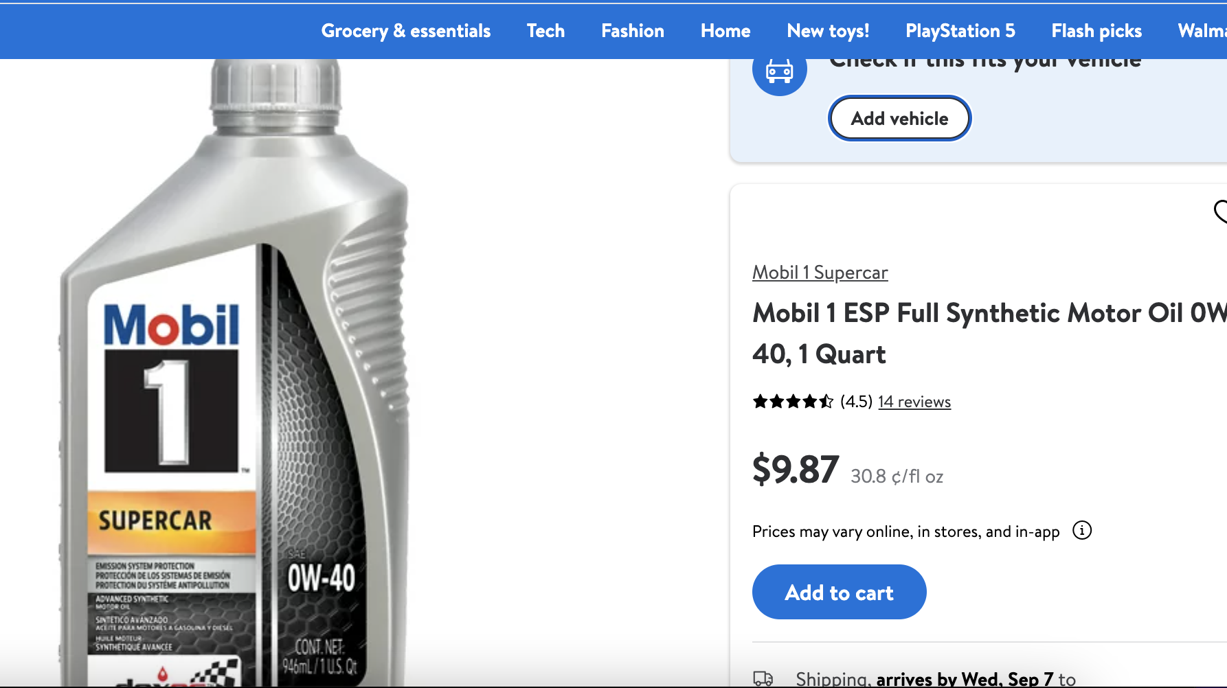

Then there is this:
Found it at Walmart for $9.87 per qt.
Starting to see now. That logo on the Supercar oil is not Dexos 1, it's DexosR. Slowly getting there...

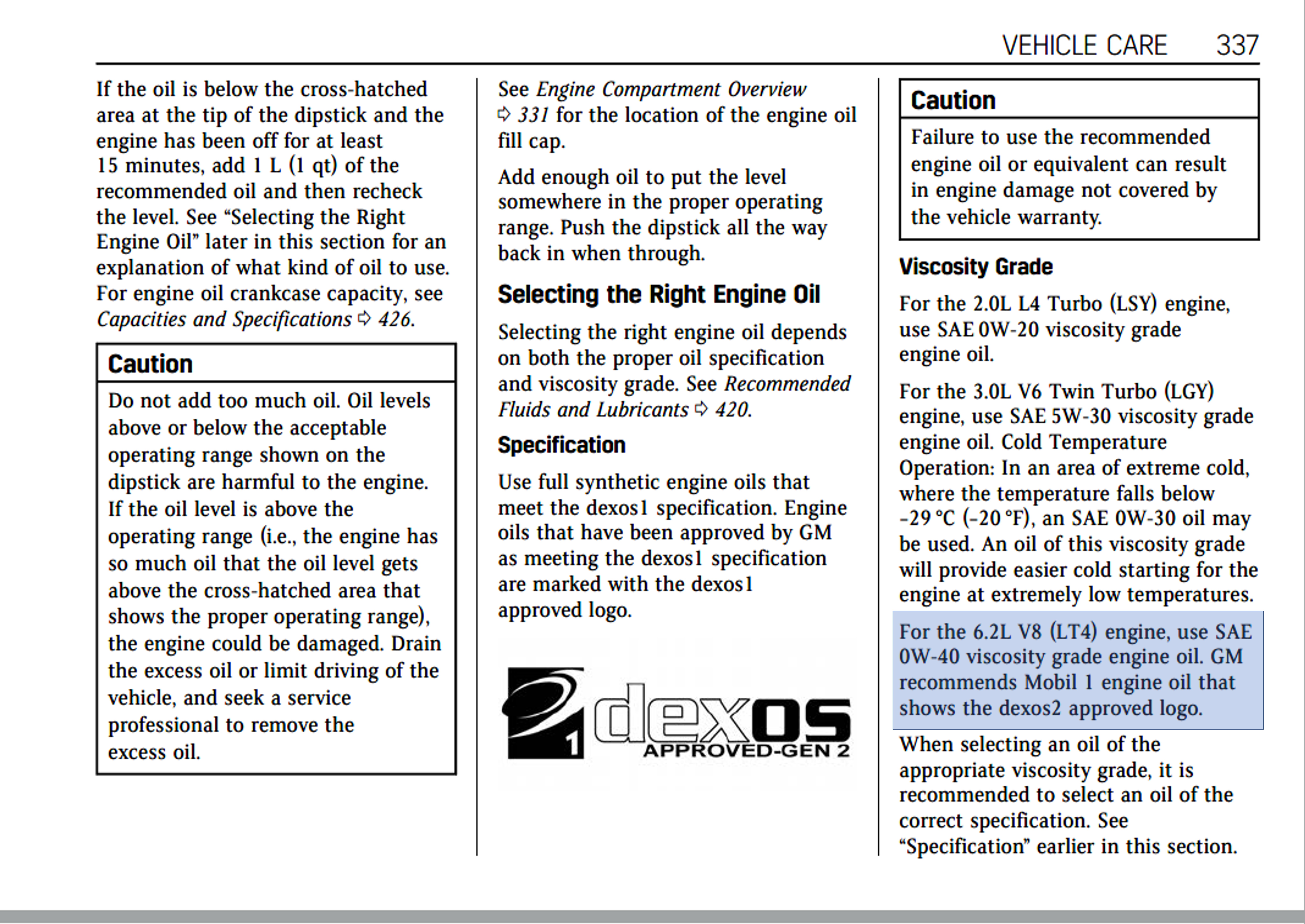

And finally, there is this (just need to keep reading). Never hurts to read it all:
Can't get the pic to show in the body of the message. If you open the file it shows the oil recommendations from the owner's manual. Dexos 2 for the LT4..
No typo..
Excuse my slowness. Definitely a typo on the Techlink thing, but the owners manuals seems correct...
Got some ESP locally at Autozone for $9.99 a quart. I don’t think they have completed the supercar branding change. Where I usually buy oil, JEGS and Summit Racing, they don’t even have it, which I find odd.
