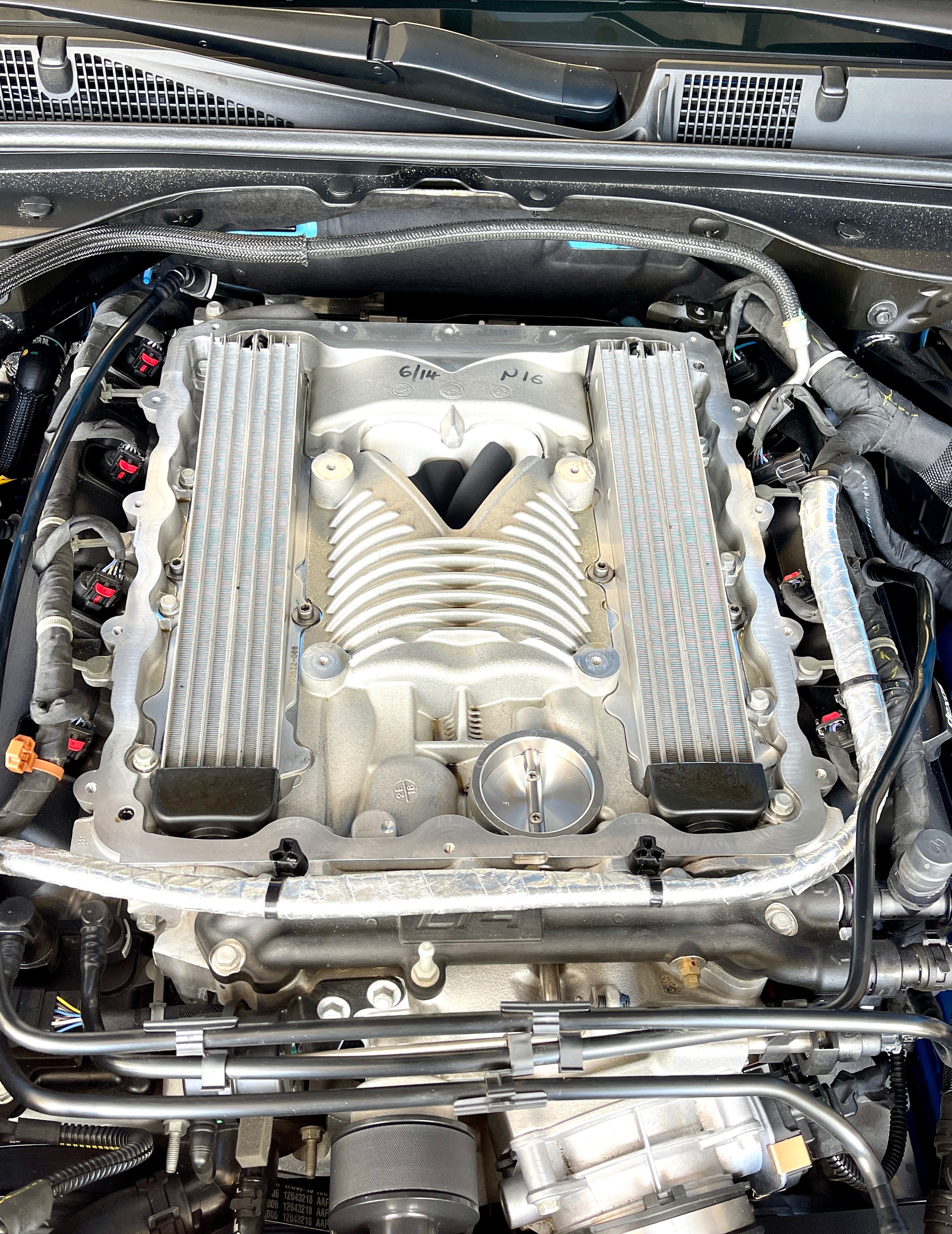

The valleys in my blower did have a small bit of oil in the corners but otherwise very clean. This picture was at about 10k miles.
